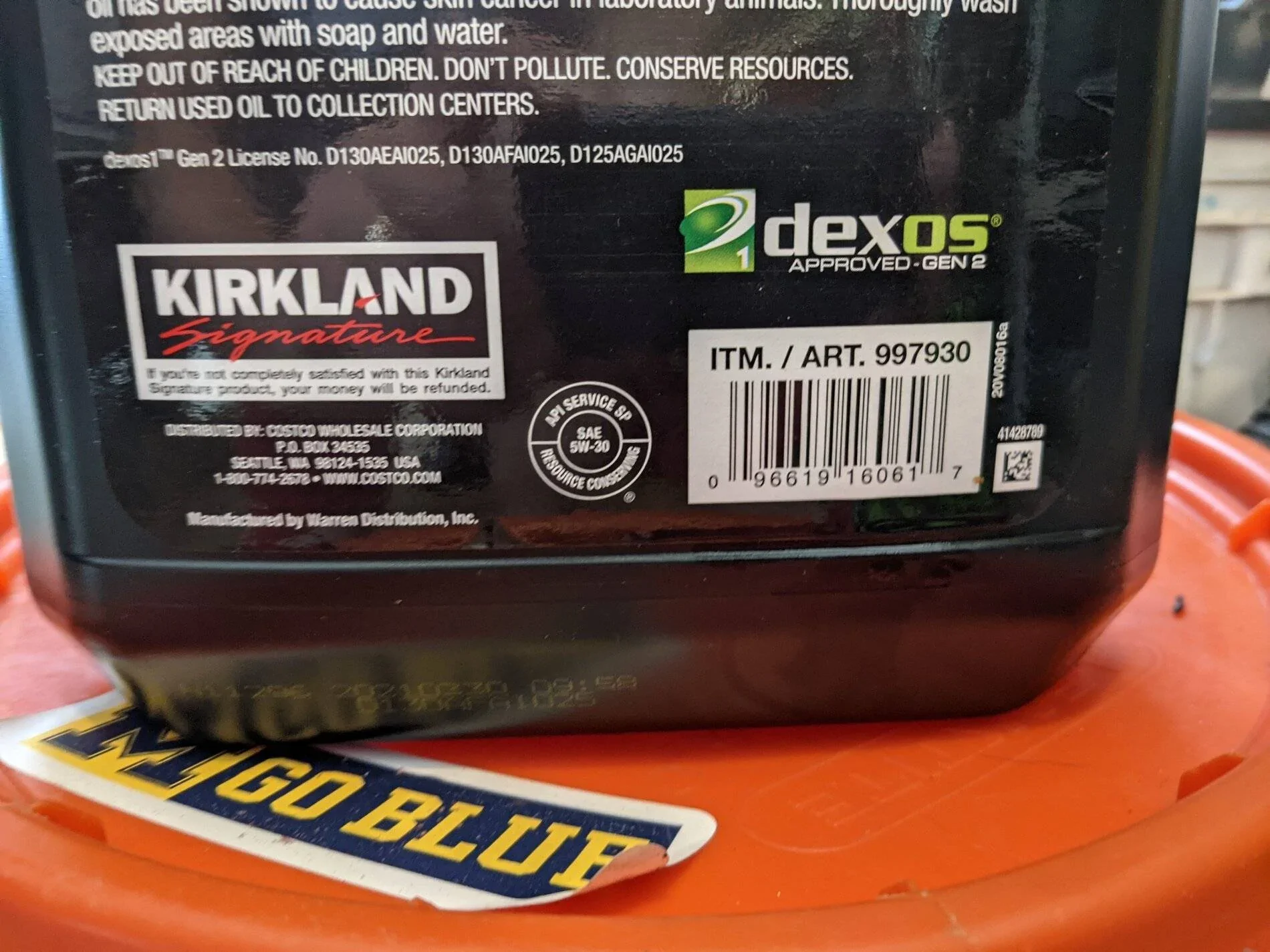

A couple of data points: First, testing by independent labs has shown that oil brand matters little when it comes to lubricity, which is arguably an engine oil's most important job. Second, there are only a handful of companies manufacturing motor oils in the U.S. Most of the name-brand oils you can buy from your local suppliers come from these few wholesalers and are rebranded. For example, back when Walmart published data regarding the source of it's Super Tech brand oil it was coming from suppliers like Warren and Citgo, which also supplies oil for Valvoline. My advice is to purchase the least expensive 5W20 (1.5L) or 5W30 (2.0L) oil you can find that meets the API SP standard and change as recommended. I personally use synthetic oil because, a) it breaks down far slower than conventional oils in high heat environments, and small-displacement, turbocharged engines are most def high-heat environments for motor oils, and b) Walmart Super Tech 5W30 full synthetic is cheap at around $16 for a five-quart jug.
