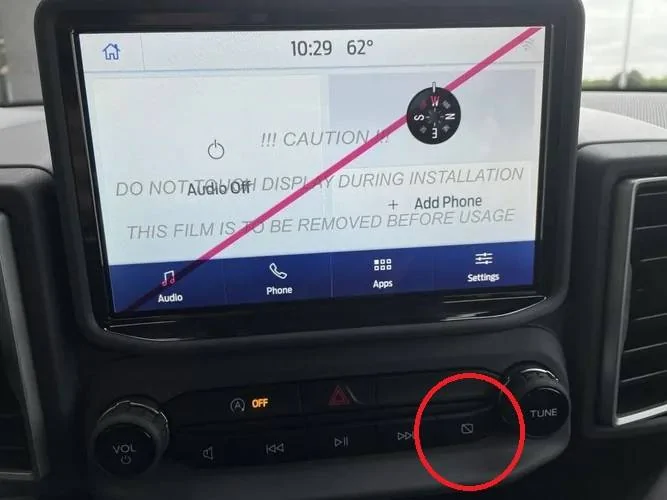

Don't think this is really it, but by any chance, did you hit the "screen off" button? I don't know if that is something that persists through key cycles.

No. Just randomly goes black after startup. Not every time.
