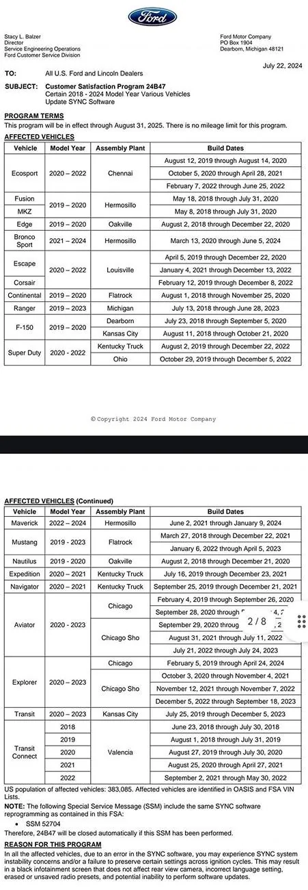

Customer Satisfaction Program (CSP) 24B47 announced 7/22/2024 to update the APIM at no cost to the owner. Also known as SSM 52704.
This is NOT an Over The Air update.
The CSP lists all of the impacted vehicles including ’21-ā€˜24 Bronco Sports build dates March 13, 2020 through June 5, 2024. The US population of all of the affected vehicles is 383,085.
Ford is aware of the issues owners are having with Sync:
Have you have experienced any issues with your center display? If so this CSP may solve the issues. Issues include:
1. Display intermittently blacks out.
Description: In all the affected vehicles, due to an error in the SYNC software, you may experience SYNC system instability concerns and/or a failure to preserve certain settings across ignition cycles. This may result in a black infotainment screen that does not affect rear view camera, incorrect language setting, erased or unsaved radio presets, and potential inability to perform software updates.
This update takes roughly 30 minutes, but expect a couple hours as this is a software update. I think it’s a configuration change to the APIM (software only update).
I do not know if this CSP is the same as the SYNC 3, Software Version: 3.4 Build 23188 PRODUCT update. The CSP is not an Over The Air update so likely differs from the 23188 update.

Customer Satisfaction Program (CSP) 24B48 announced 7/22/2024 to update the APIM at no cost to the owner.
Have not yet found the full description for this CSP but will post when available.

I was having instability issues with my sync along with not saving settings. Also could not get Sync to update over my Wifi (wouldn't save wifi info) So while the Sport was in for the recall they did this CSP. So far it has solved all the issues I was having

Build version is 23188. Unfortunately I don't have the work order. The dealership was operating in manual mode. Their systems were shut down from the hack. They didn't even know who had appointments. I showed up and they were in a state of mass confusion. Everything was by pen and paper. Mine was easy, no parts, just software updates which they could do. So thanks for the reminder, they were suppose to email me the paperwork when their systems came back online. After several days of systems being down, guess they forgot. Oh, the tech knew about the CSP, so based on my discription he just went forward with the update.
