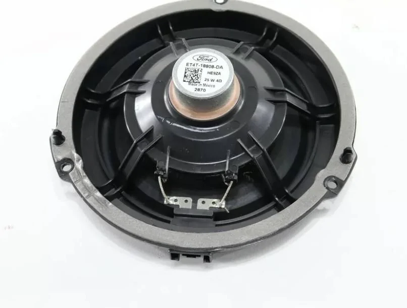

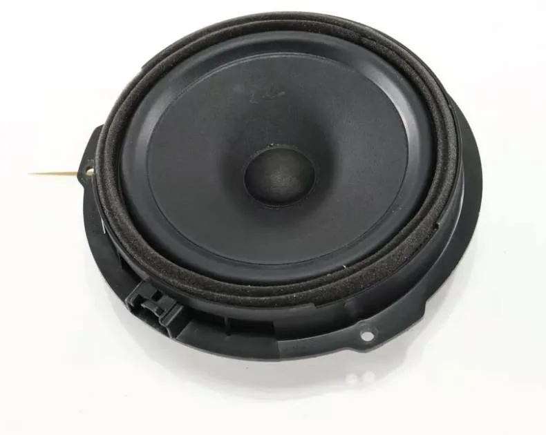

these are the door speakers. Made by God knows who. Marketed as B&O, under harman and owned by Samsung. Also used as Sonys speakers in previous Ford models. Same speakers Ford has been using for last 10 years. But they’re 25w 4ohm so most off the shelf auto speakers will work.
I bet if you swap out just the 4 door speakers, it will be night and day difference since any aftermarket speakers can handle it better and won’t distort at very low volumes. And can get cheap ones like 80-100$ for four and just run off the factory amp.

That’s a tiny magnet!
If Ford is using the same speakers (just more of them) for the premium sound system, why would any stereo company want to put their name on it?
What exactly did B&O add to it?

In my experience w/OEMs, it's a bit of salesmanship along with some real engineering. The name brand company will usually work w/the suppliers and manuf in the development of component placement and selection to best fit the attributes of said brand at the given price point.
I did note a fair amount of noticible difference between the "base" and B&O setups - especially with a better quality source (S/XM isn't...)
The only issue with this is the digital signal processor. I believe the B&O system uses a DSP to "tune" the amp output for the speakers. That means whatever equalization it's currently applying to the OEM speakers will also be applied to any replacements. You may get "better" sound, or the equalization may make the "better" speakers sound like dookey as well.
I believe those with discerning ears will likely not be satisfied with anything less than bypassing the OEM amp/DSP setup entirely. Since that would entail replacing the speakers too, there's little risk in replacing them first to see if you're satisfied with the result. My experience watching many go through this process in the Mustang community suggests speaker replacement won't be enough.
