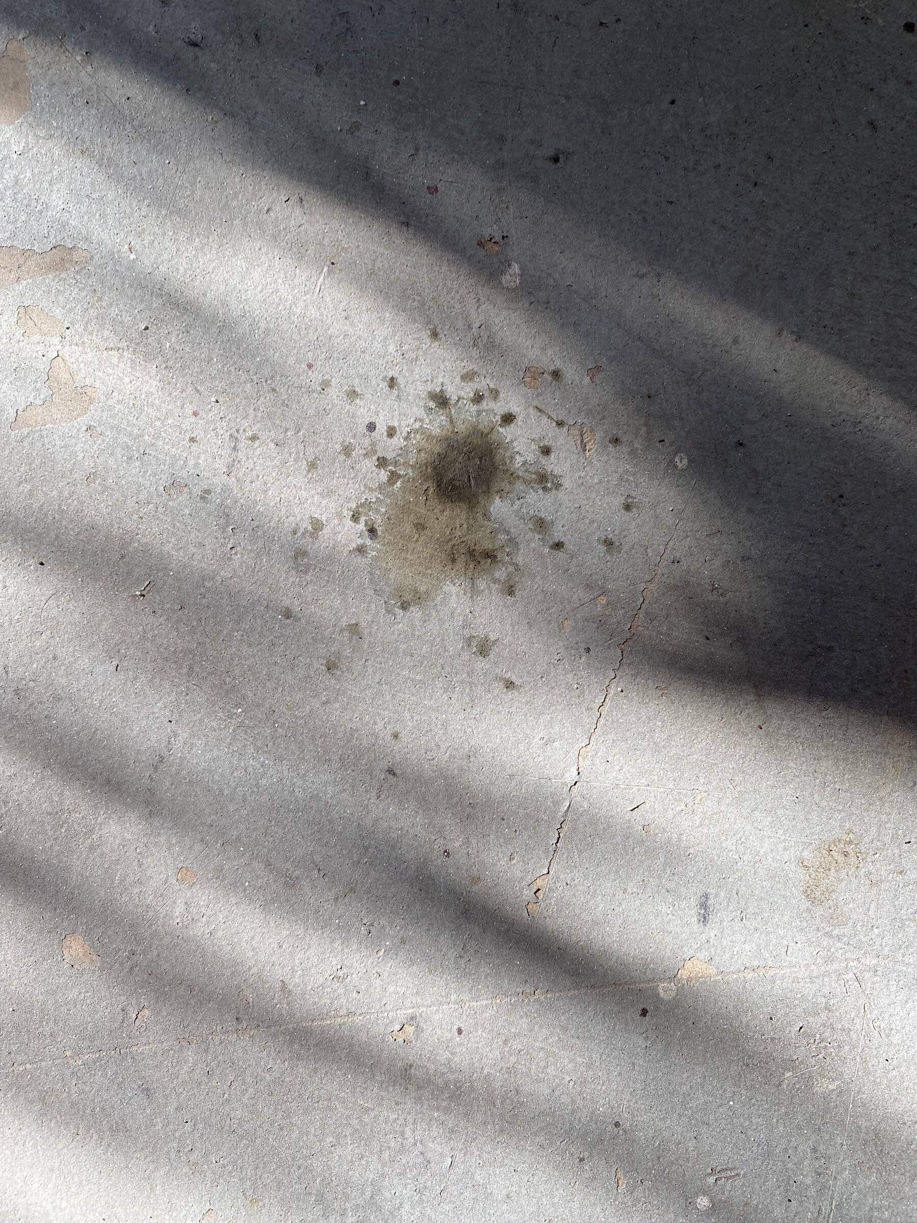

I noticed this small drops of oily substance on the Garage floor under the BS. Not much & it felt oily , rubbing it between my fingers . Now its dry in this photo.

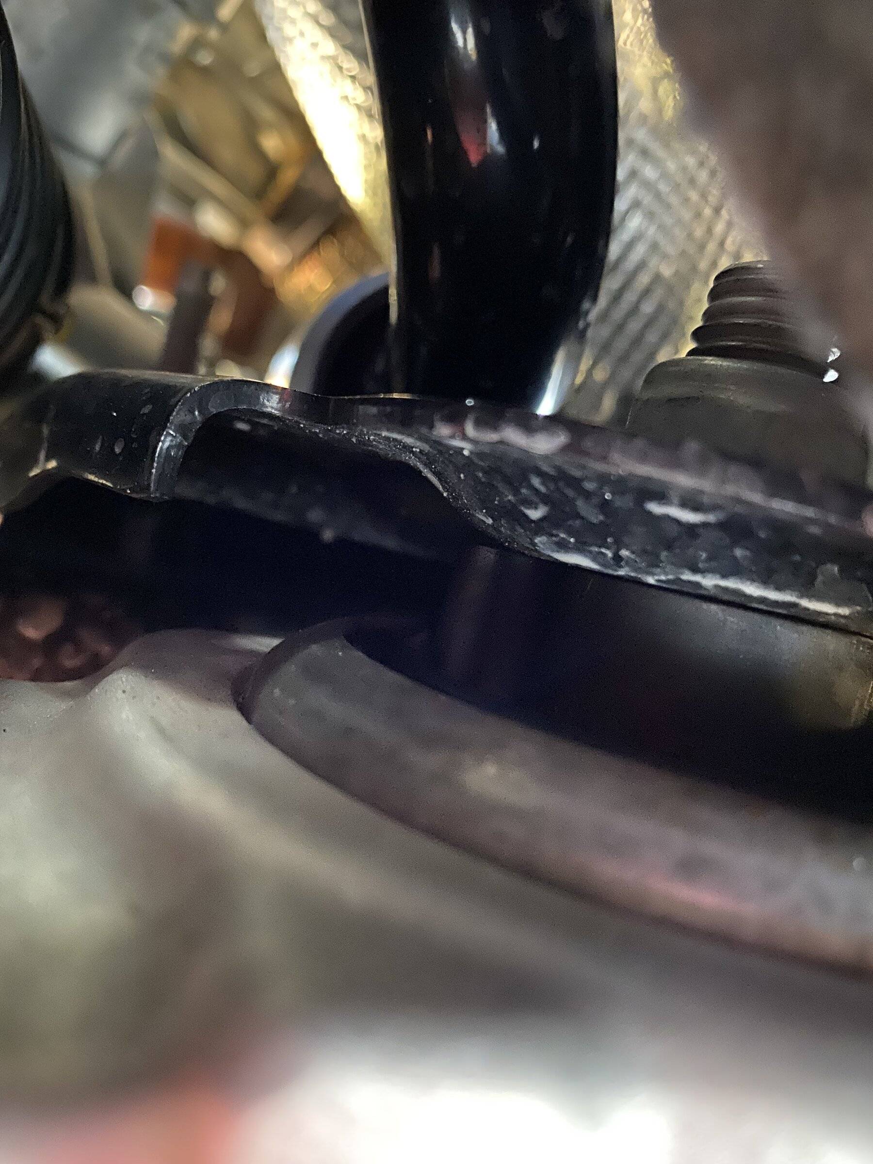

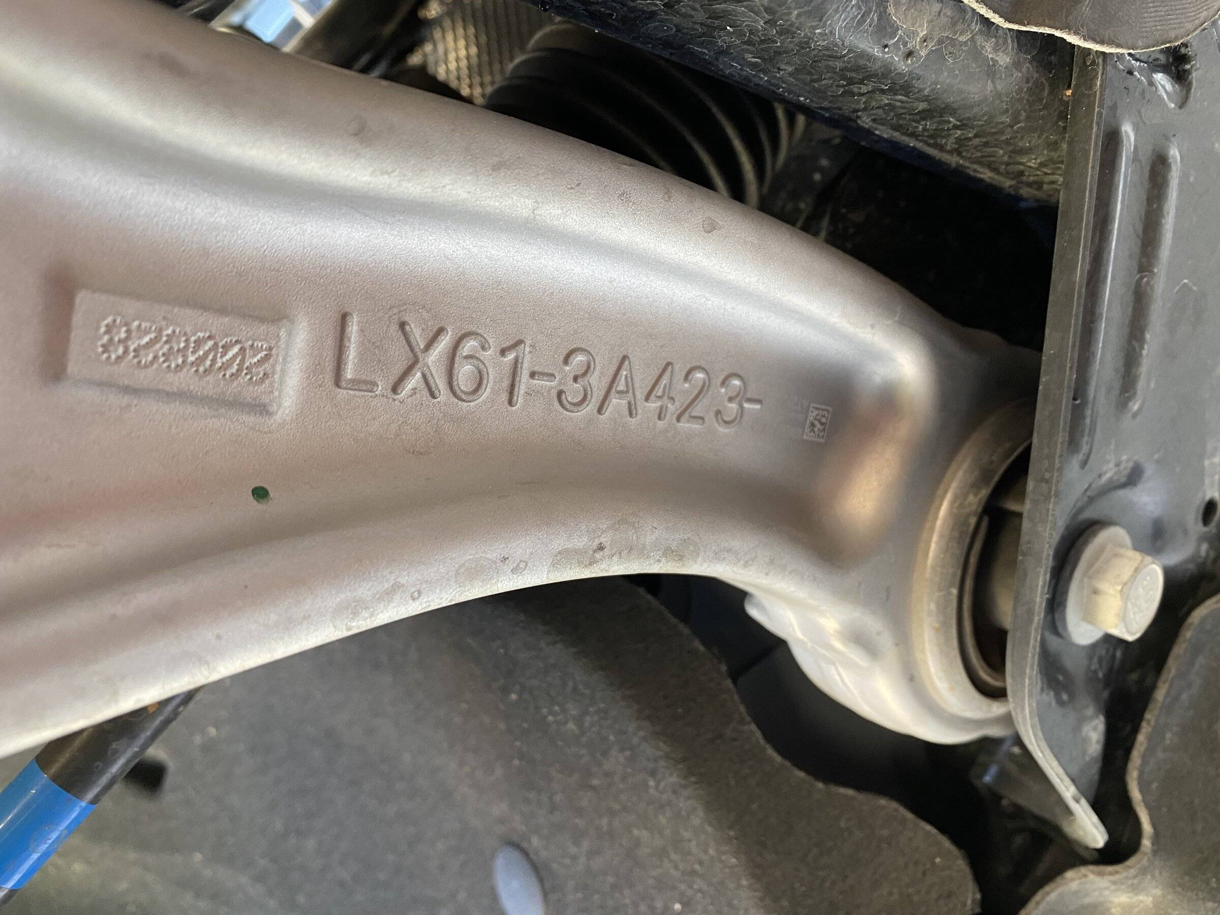

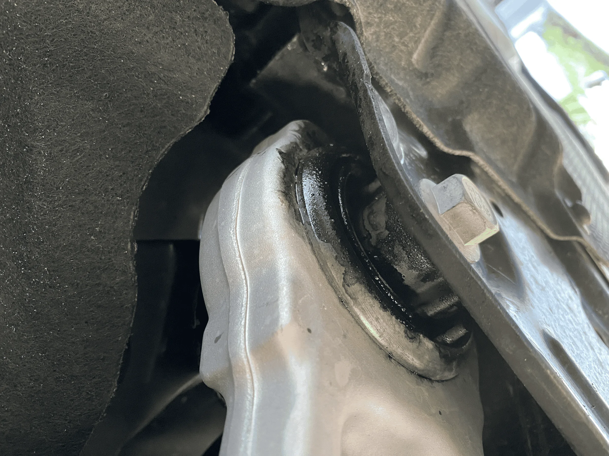

Checked the oil & it was fine , just this one spot & its back toward the Transmission more then from the Engine area , so today I put the BS on ramps & pulled the under body panel off for a look see , nothing any where I can see , not the Engine or the Tranny , it looks like its coming from one of the Suspension mounts , are they filled with something , strange . I looked & felt above & all around & could not see of feel anything , just what's around this mount , strange . I will drive down to the Dealer Monday & show them these photos .

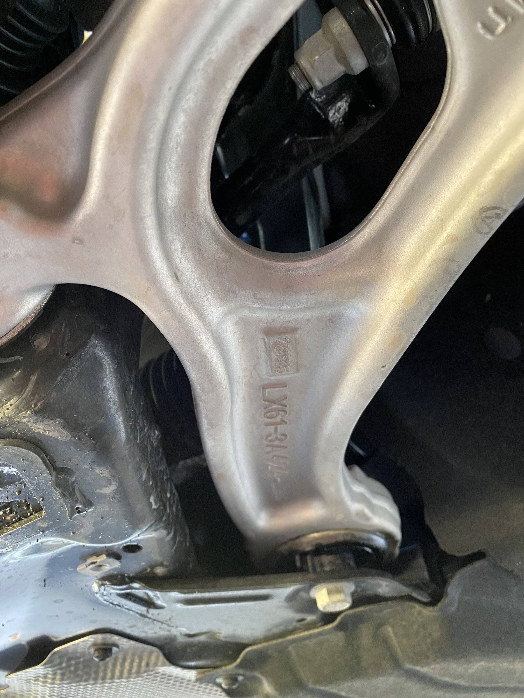

Passenger side & above drivers side , where the oily looking stuff is .

We had new 2009 Honda Pilot that had liquid filled front control arm bushings and they leaked. Not sure about our sports but yes there is such a thing as liquid filled bushings they are supposed to dampen vibrations better.

This was definitely oily the day before , but saying that , what kind of oil drys in 24 hours , its not absorbed by my Garage floor , it definitely was not there on the floor the day before. The Catalytic Converter & tail pipes were replaced as a recall, because it was said it was the wrong Cat. installed .
Strange its only in that one place & I first thought it was splashed up , but too precise , to be splashed from the road & it has stopped leaking , maybe empty of fluid ?

Well, BS went in this morning & they are replacing that Bushing , ordered a new one , looks like they are using three once used parts & the new Bushing . No one really said it was a liquid filled Bushing , but I'm kinda leaning that way .

I would have to assume bushing is liquid filled if they replaced the bushing. Anyway glad to hear it got fixed.
