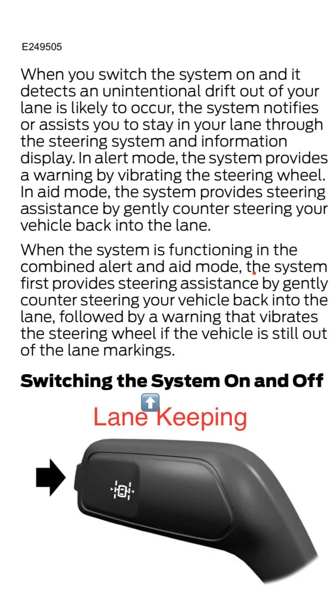

My understanding is, you can change the intensity but can’t fully turn it off? My SYNC doesn’t appear to give me a turn off option.
Correct, not with Sync but did you try this method to turn off Lane Keeping?
Ford Bronco Sport Steering wheel vibration when switching lanes? IMG_1463
