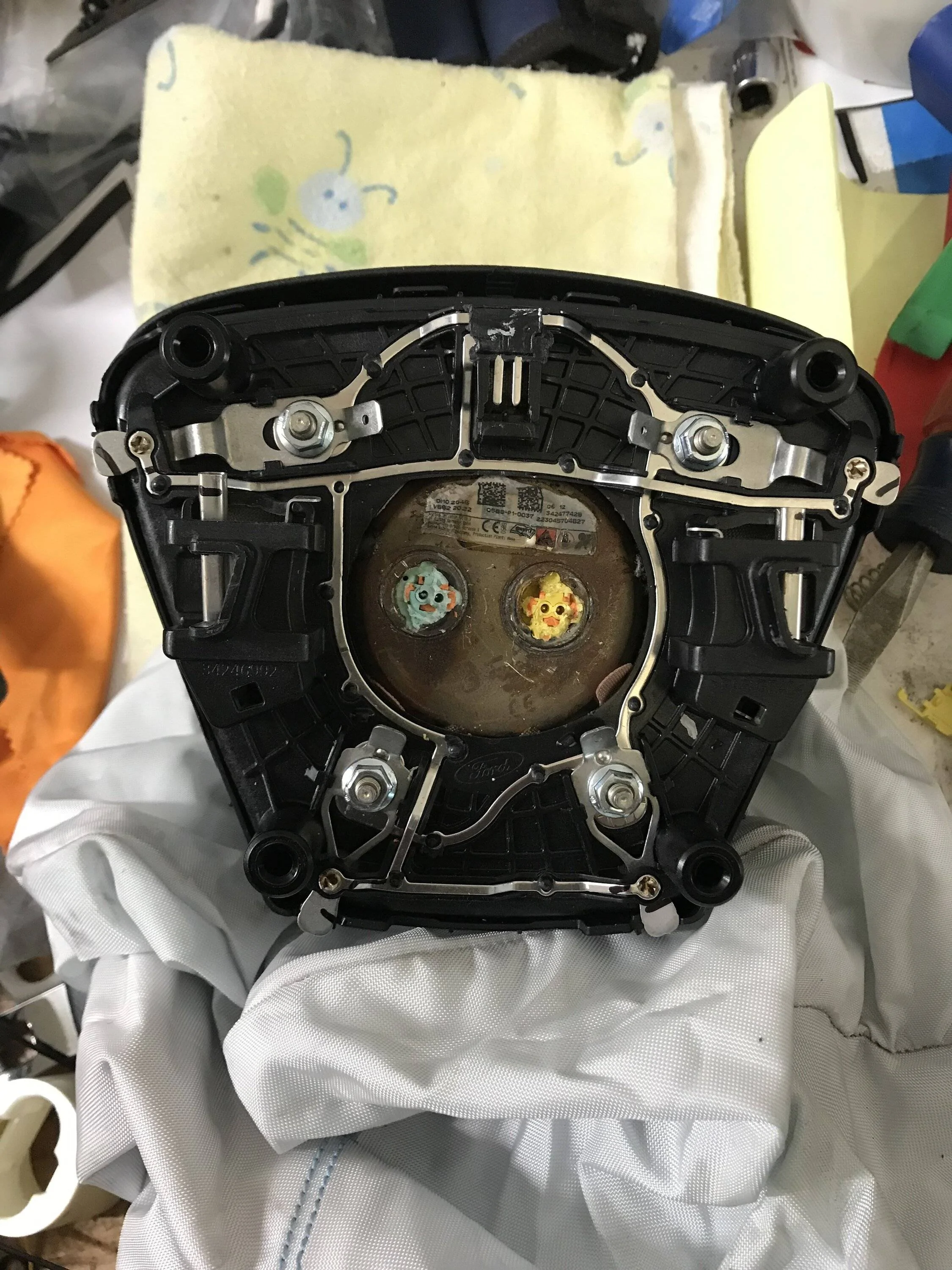

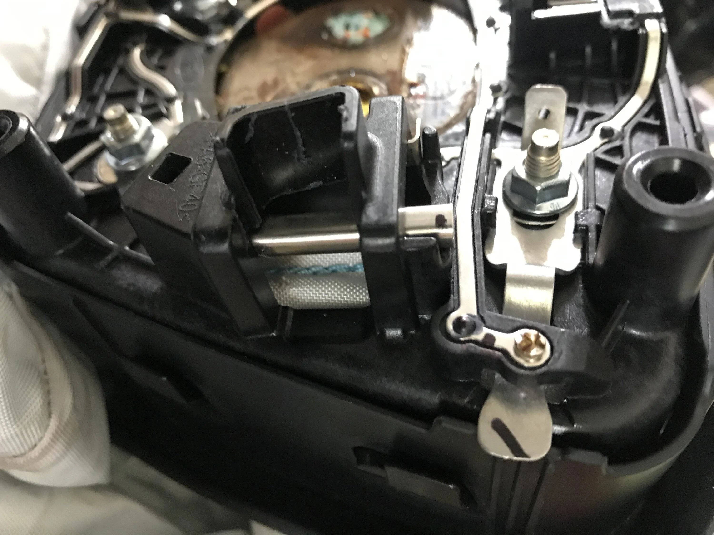

I am working on a 2022 Badlands steering wheel air bag and could not find any helpful pictures or videos so I took some pictures while changing so you can see the backside because it is different from other cars that I have worked on. The spring loaded fasteners were different from Mercedes, VW, etc. that have access holes in the steering wheel to access unlocking the spring loaded locks. I removed the upper plastic steering wheel shaft cover and positioned the wheel in about 9:00 and 3:00 o'clock positions to access the locks from the top, over the column cover. I also had to replace the connectors because they had melted somewhat.
