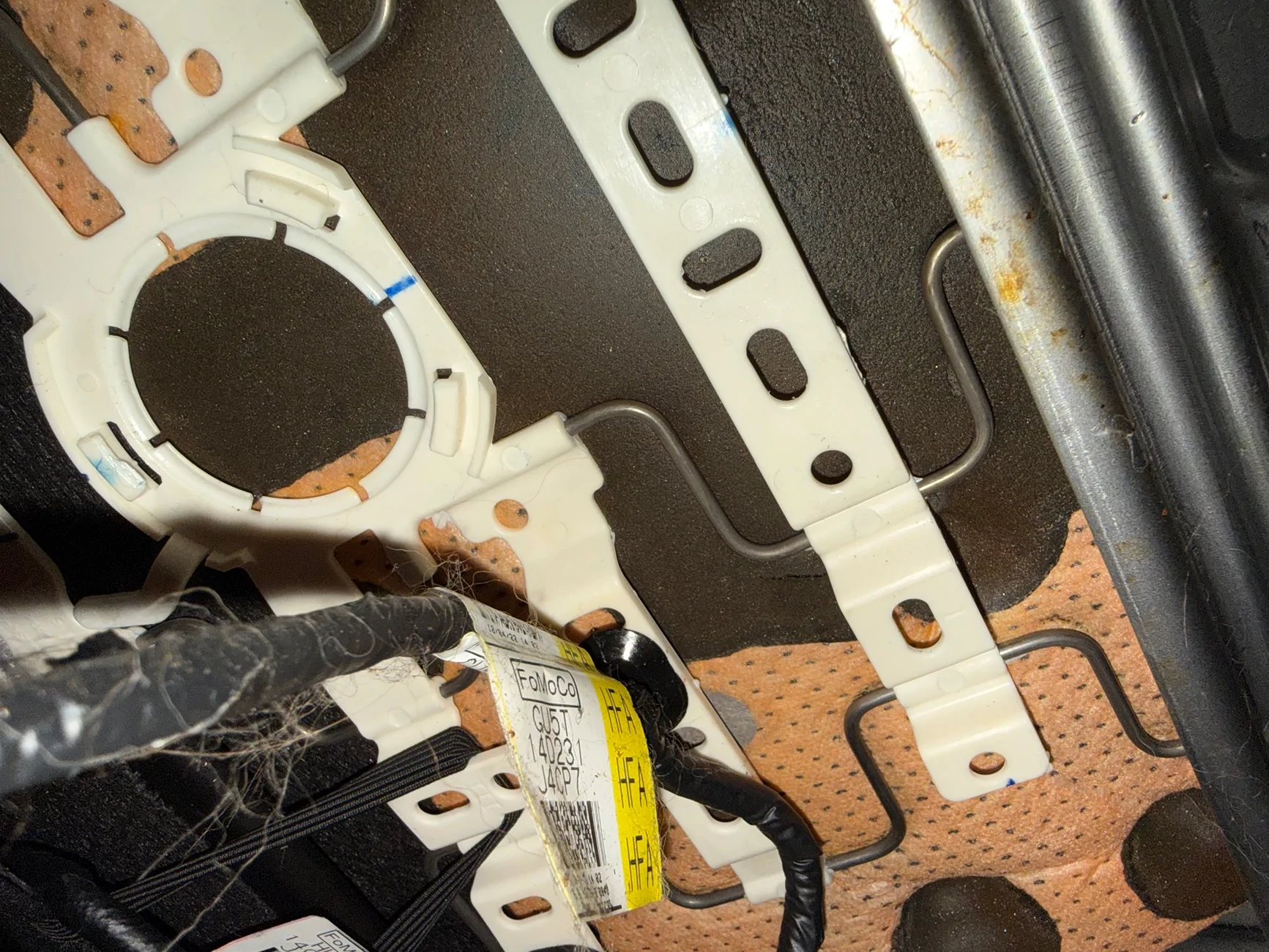

It’s not the fire extinguisher I’ve tested it without. The squeaking is coming from the white plastic that runs under the seat that wires and things are attached to. I can reliably mimic it by moving the white plastic. Just hoping there’s a quick fix other than taking to dealer
Ford Bronco Sport Squeaky driver seat, anyone else? IMG_9206

Try applying some silicone spray to the offending parts. That has resolved all kinds of friction related noise issues for me.
+1 for the silicone spray. It has zero smell and it will not stain either. What ever you do don't use WD-40 or penetrating fluid you will never get rid of the smell.
Oh, c'mon, WD-40 is man perfume! :)

What about getting some of the foam pipe wrap sold at Lowes & Home Depot & cut off a piece & put that in between the parts that are squeaking to stop the noise.
