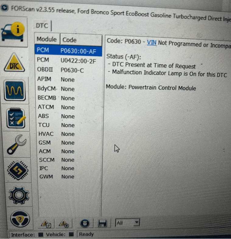

Hey all,
Hoping to get some advice in this thread with some hiccups I'm running into when attempting to update my tire size via Forscan. I've recently upgraded my stock 225/65/17 (2202mm circum) to 245/65/17 (2357mm circum) -- calculated circum via two different online tire calculators. I was able to successfully write in the new size, that's when the expected AWD error + orange service wrench came up on my dashboard and DTC PCM alerts came up on Forscan.
I followed the directions noted here (https://forscan.org/forum/viewtopic.php?f=16&t=15994&sid=2c2e7131453abf2d477a5b00351ca3f8)
to relearn the PCM vehicle data, however I noticed AWD module does not show/exist under my list of DTCs.
I am using FORscan v2.3.55 and Vgate vLinker FS OBD2 USB Adapter to try and make these changes.
I am wondering if I need to use a previous version of Forscan (perhaps v2.3.4 ?) or a different OBD adapter? or if AWD module is under a different acronmy?
Appreciate any help I could get here to get over these Forscan hurdles ?

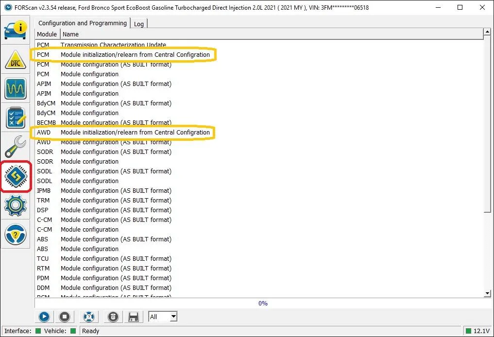

Your AWD module should appear in your DTC list (among a ton of other modules). I would recommend deleting your vehicle profile and making a fresh one.
The relearn functions will be on the "Configuration and Programming" screen. Referencing the below image, click the button boxed in red. Then you'll want to run the functions boxed in orange.
Ford Bronco Sport Speedometer Calibration With  Larger / Bigger Tires? CandP marked
Then you can reset your DTCs. After resetting them, check for DTCs again to confirm they cleared. The AWD module DTC sometimes wouldn't stay cleared for me. After relearning the AWD module (maybe a few times) it would clear up.
On a related note, I have 245/65R17 Falken Wildpeak AT3Ws and my circumference is set to 2242 after calibrating against GPS. My speedometer is within about 1.5% of GPS indicated speed (<1 MPH delta at 65 MPH).
Thank you for the advice and input! will definitely try this out once I get some downtime
