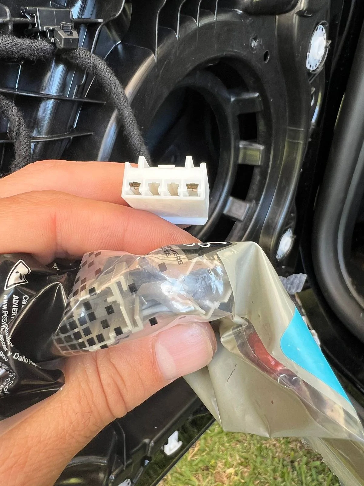

The good news is, I can take the door panel on and off in a matter of minutes now, with the help of my trusted right angle Milwaukee. The bad news, is that I only learned this because I took each door panel off to ensure that the harness they sent me was an ill fit. So I got nowhere with my install.
I guess this is what happens when you don't do a little bit more due diligence and simply take a websites "word".
But I purchased (4) Kicker CSC67. The Sonic Electonix site says they "fit for the vehicle". Now that I'm looking at Crutchfield, it says "rear only". The speakers, for whatever reason, seem like they would fit fine, on both front and rear panel, if I were to simply have the right adapters.
Can anyone help me figure this out? First maybe recommend the right adapter, and then also a confirmation on the speaker model fit?

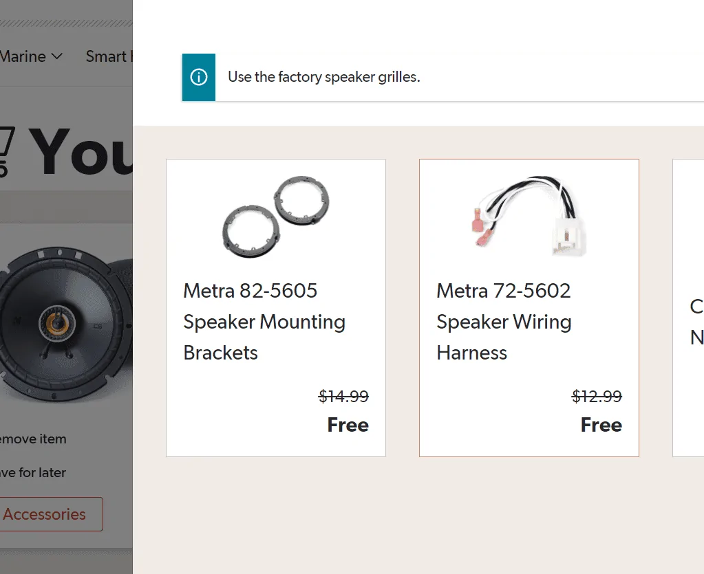

So Crutchfield, which I should've checked at first (because they are usually pretty solid for info) says I need these
Ford Bronco Sport Speaker Install Help 1712507819632-m1
Sonic Electronix sent me the 82-4301 adapter for speaker
and the 72-5603 adapter for wiring
So Strike 1 and 2 for Sonic Electronix. Hopefully its not Strike 3 with the speakers and somehow I can get them to fit in the front with some easy modding. We will see.
Can anyone confirm the screenshot of part numbers from Crutchfield??

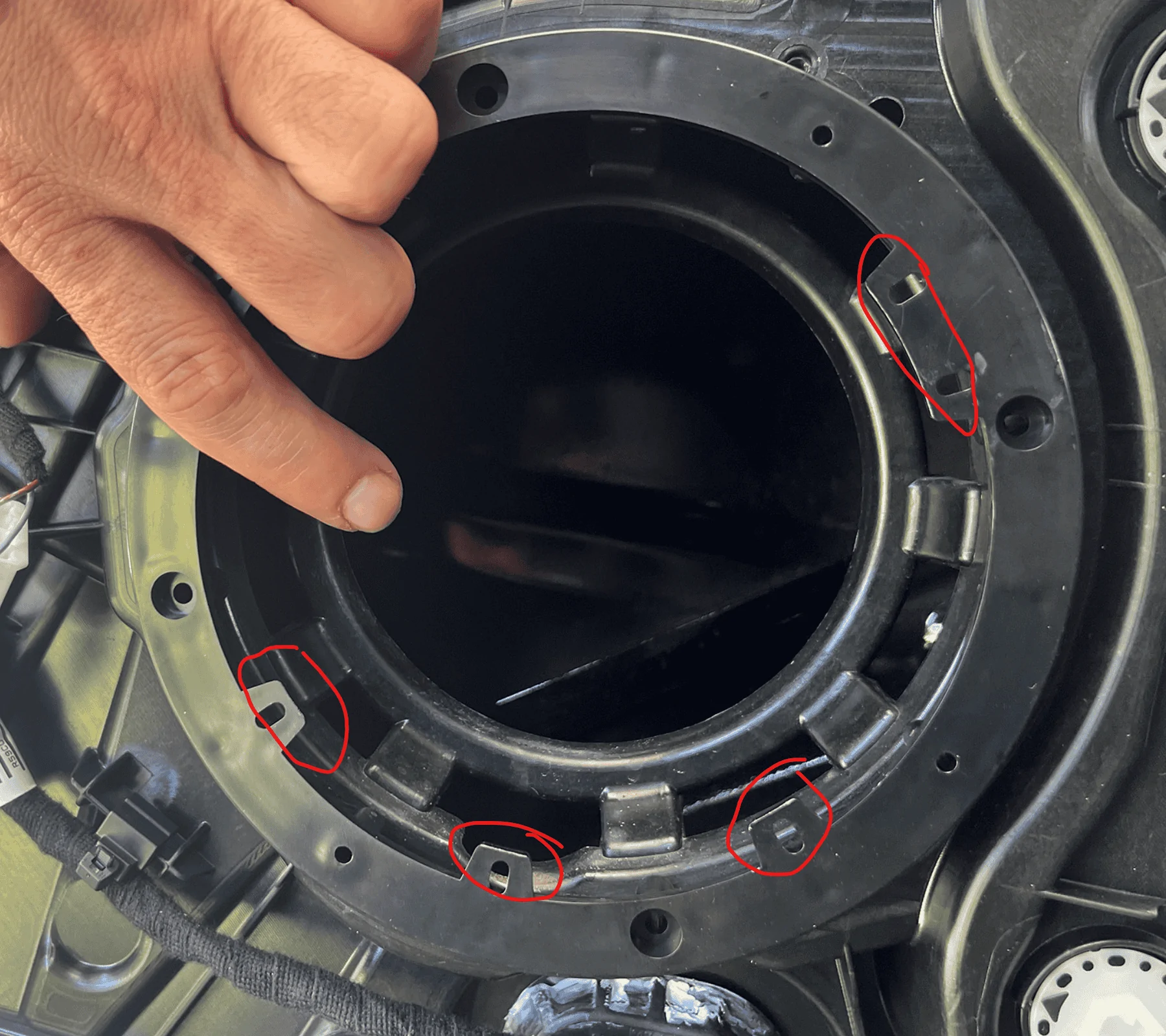

you gotta remove those little tabs on the inside of the speaker bracket. They can pop out with your finger

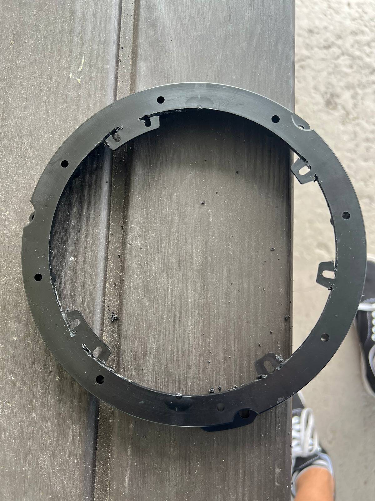

Are you talking about these? Like with a dremel or something? If so, I feel there shold be a better fitting adapter rather than having to do that.
Ford Bronco Sport Speaker Install Help 1712511583296-1
And it still doesn't change the fact that the Metra adapter wn't line up over the factory holes.
Yes… those tabs will come out.. also make sure you have the proper bracket (Metra 82-5605)

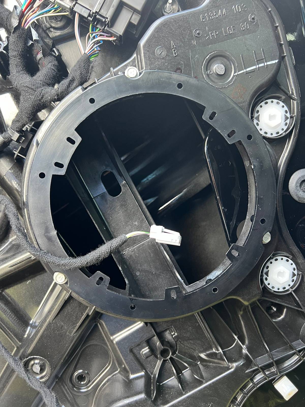

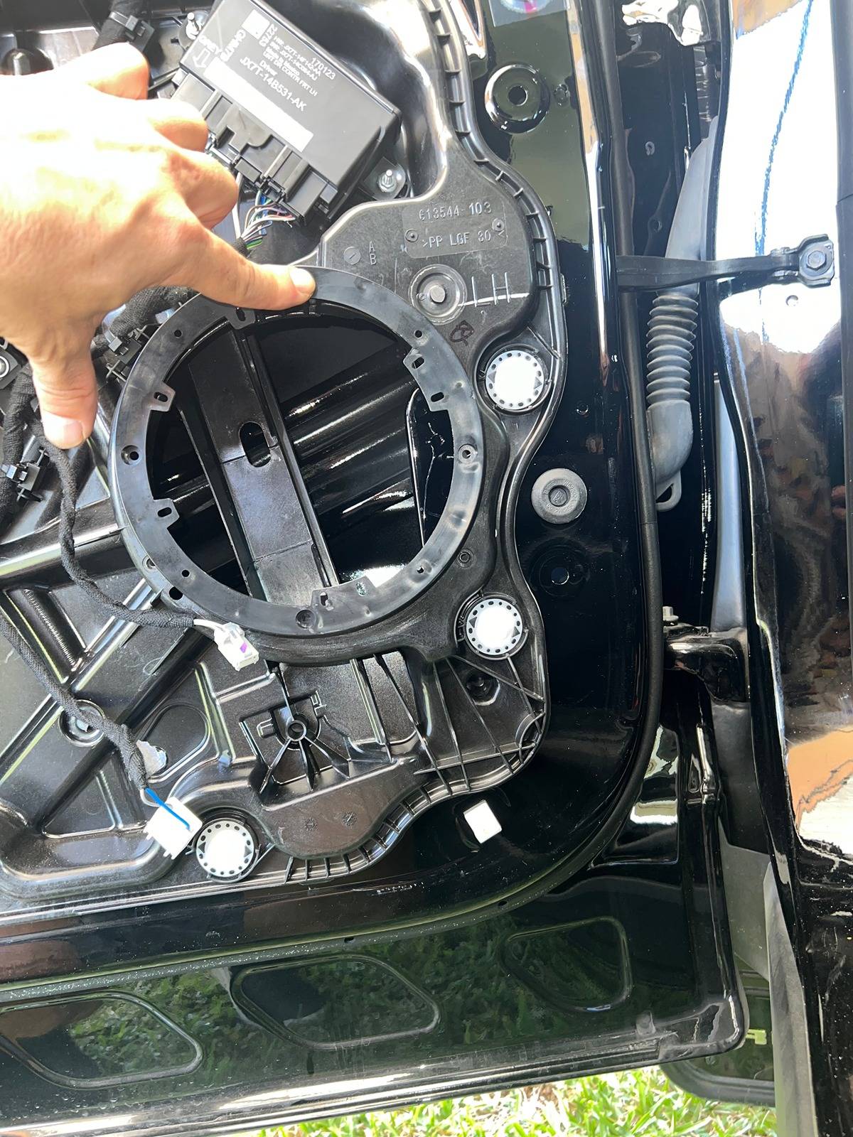

So yeah. Wrong recomendation by Sonic Electronix when I got the Kickers. But my fault for being lazy and not doing a tad bit more due diligence.
Not only that, but was completely unaware of the 'fab work' that had to be done on the adapters regardless.
Ford Bronco Sport Speaker Install Help IMG_5562
Ford Bronco Sport Speaker Install Help IMG_5563
I got these 6.75 Kickers in particular for their RMS rating. This is the first step in trying to get my 5 channel amp and sub into the car. I've been delaying on it. Its basically the same setup that I had in my Mustang, since its basically the same OEM 4 channel stereo with 6.75 speakers. However, I've tried a couple of different 6.75 with my amp, and just ended up blowing them down the road. These Kickers have twice the RMS rating as those.

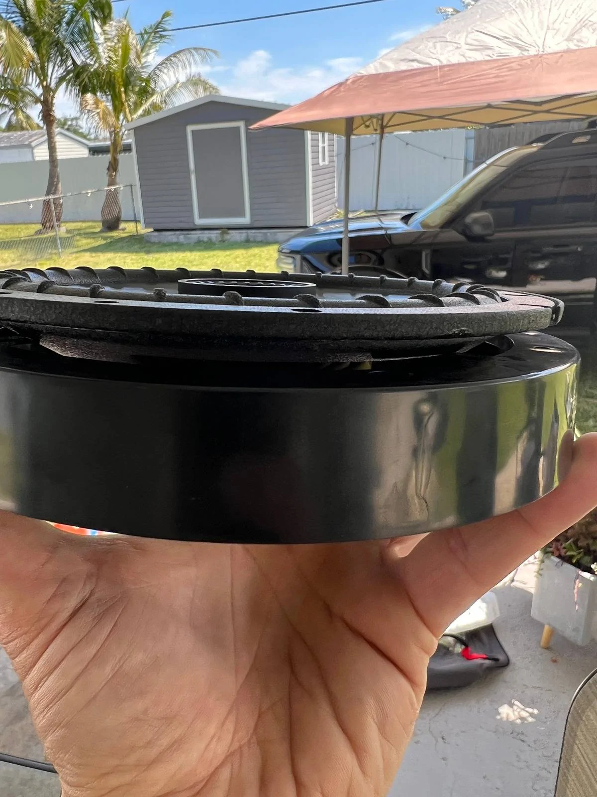

Since Crutchfield said they would "fit" in the rear, I tried installing them with the Kicker grill there. However, nope. Did not have the clerance to pop the door panel back in, so I had to ditch the grills in the rear. Funny thing is, that it really looked like there WAS a little bit more clearance in the fronts to get the grills in, but I didn't give it a second thought and just kept them all uniform without the grill.

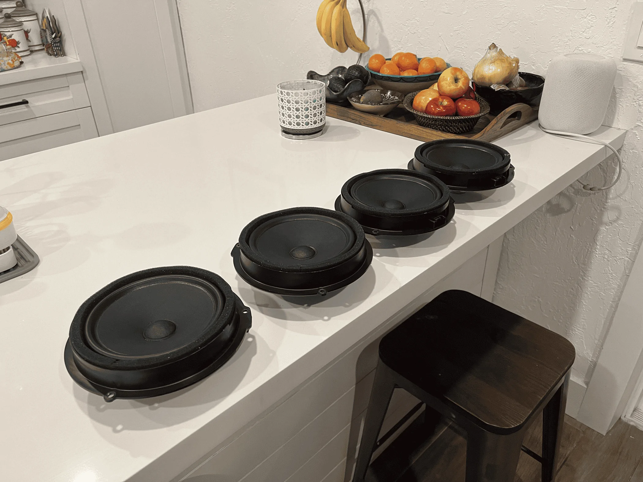

Here are the crappy OEMS I took out
Ford Bronco Sport Speaker Install Help 1712797314295-1g

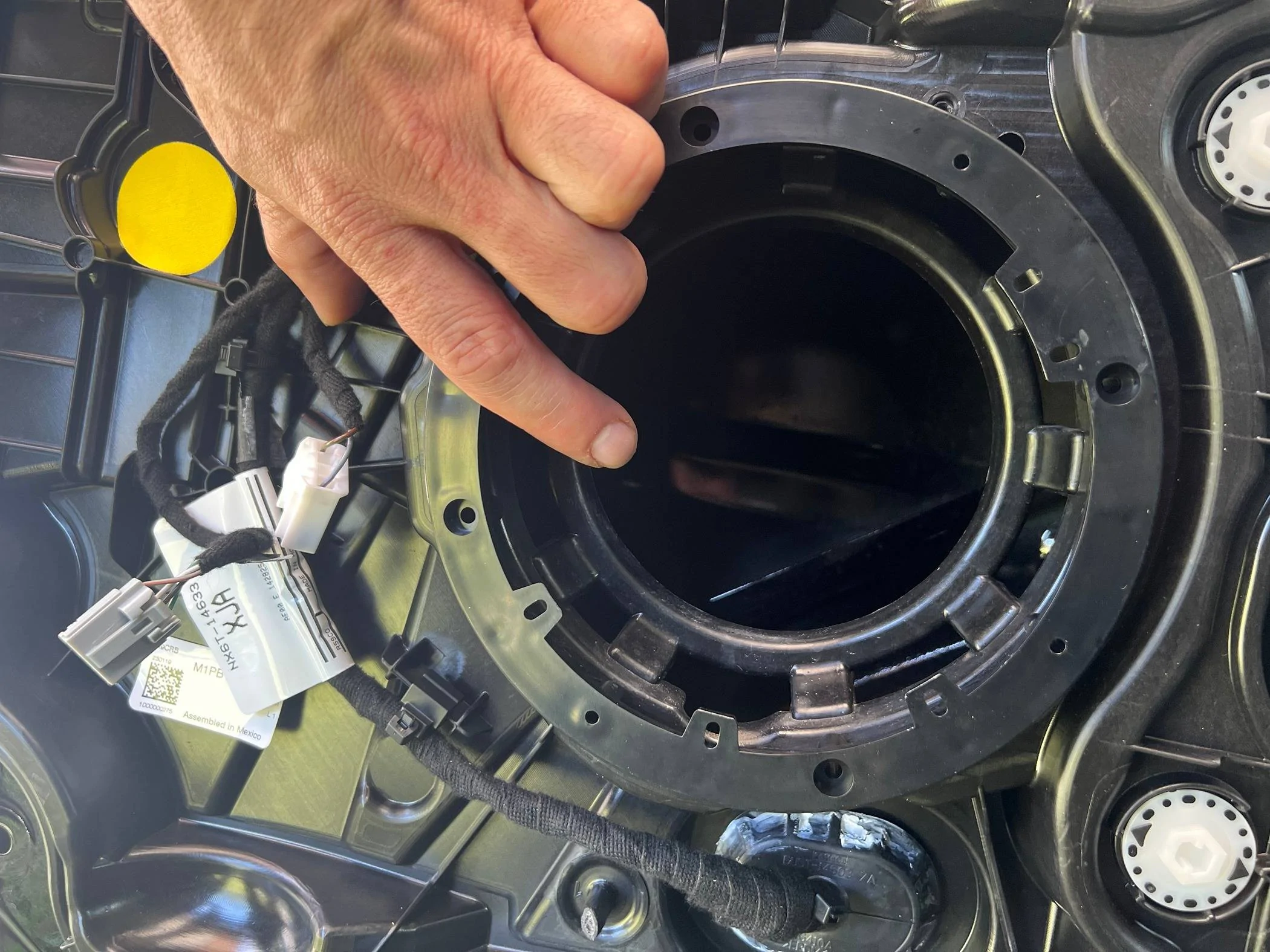

Alright, moving right along and trying to do a bit more due diligence this time before taking a part my dash.
I have a question.

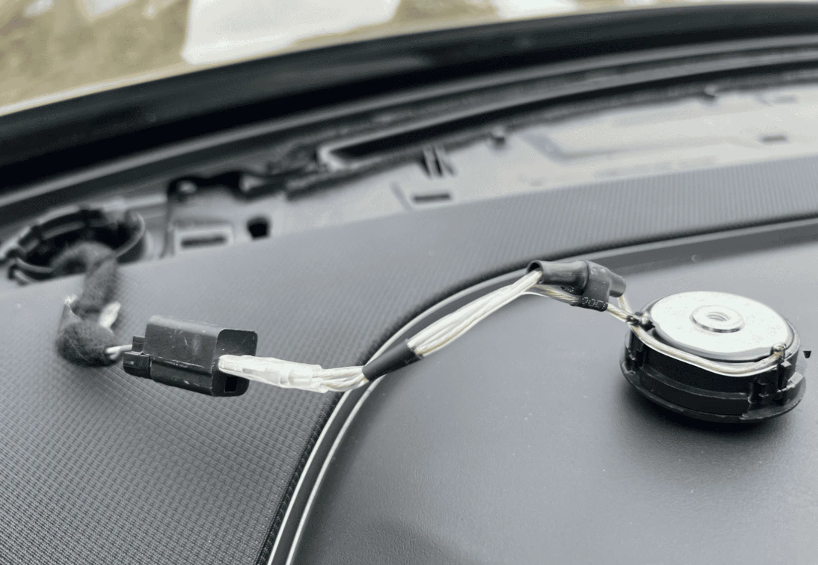

Are the OEM tweeters wired all the way to the pos/neg speaker terminals? Or is there also a plastic OEM clip that you can unfasten?
This is the only pic I could find on this site that has a good look of how the wiring comes out of the dash, but its AFTER the person snipped the OEM wires already.
Ford Bronco Sport Speaker Install Help 1713117268095-0z

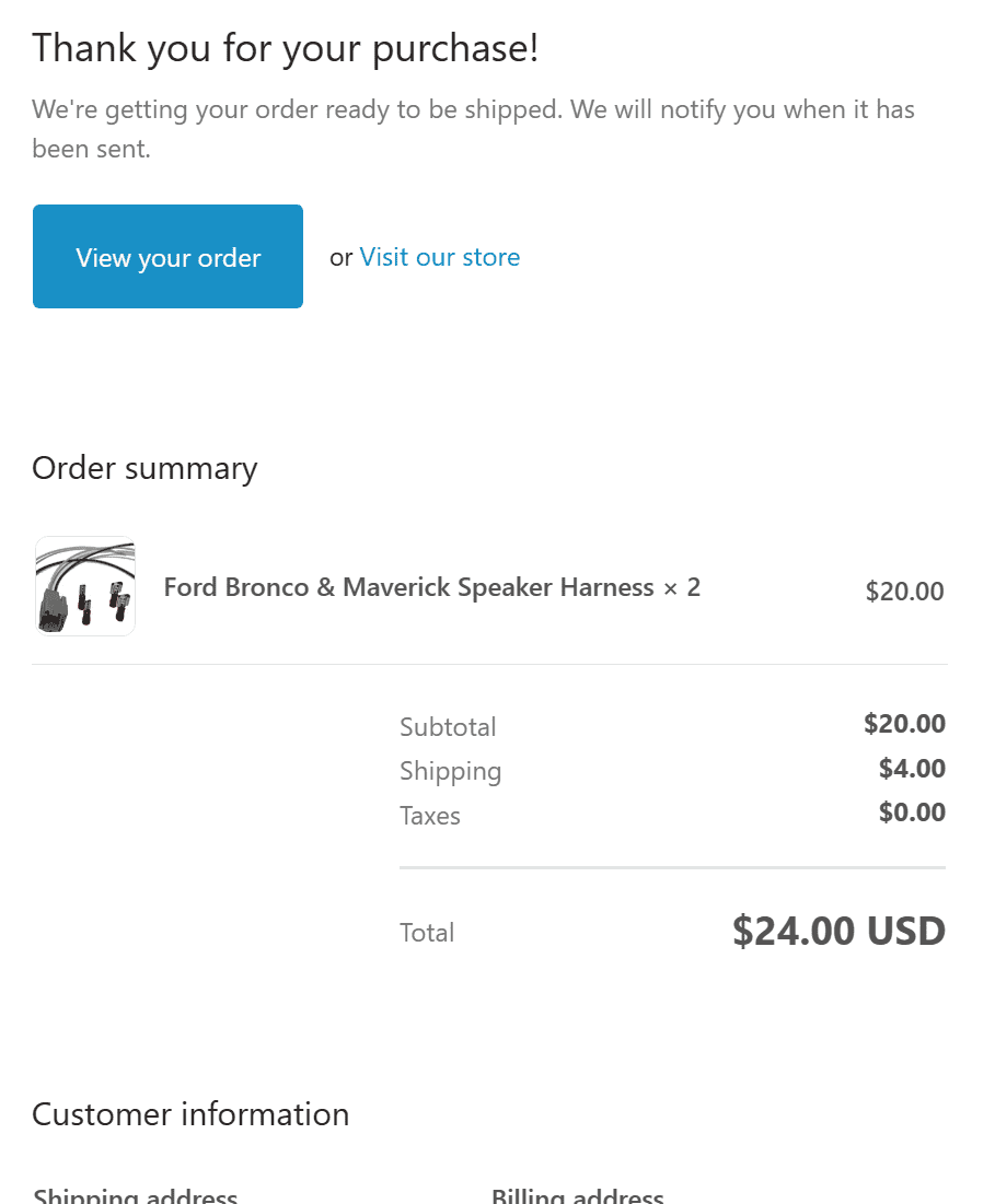

Alright, went out on a limb and just ordered them. I imagine they are clipped in. They'll be worth the money if they keep me from snipping the OEM wire.
Ford Bronco Sport Speaker Install Help 1713186685719-wx
