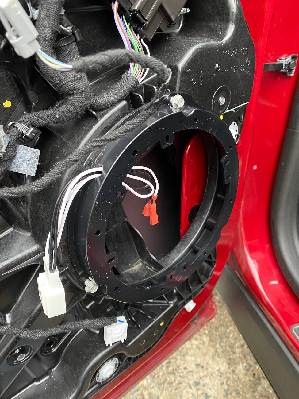

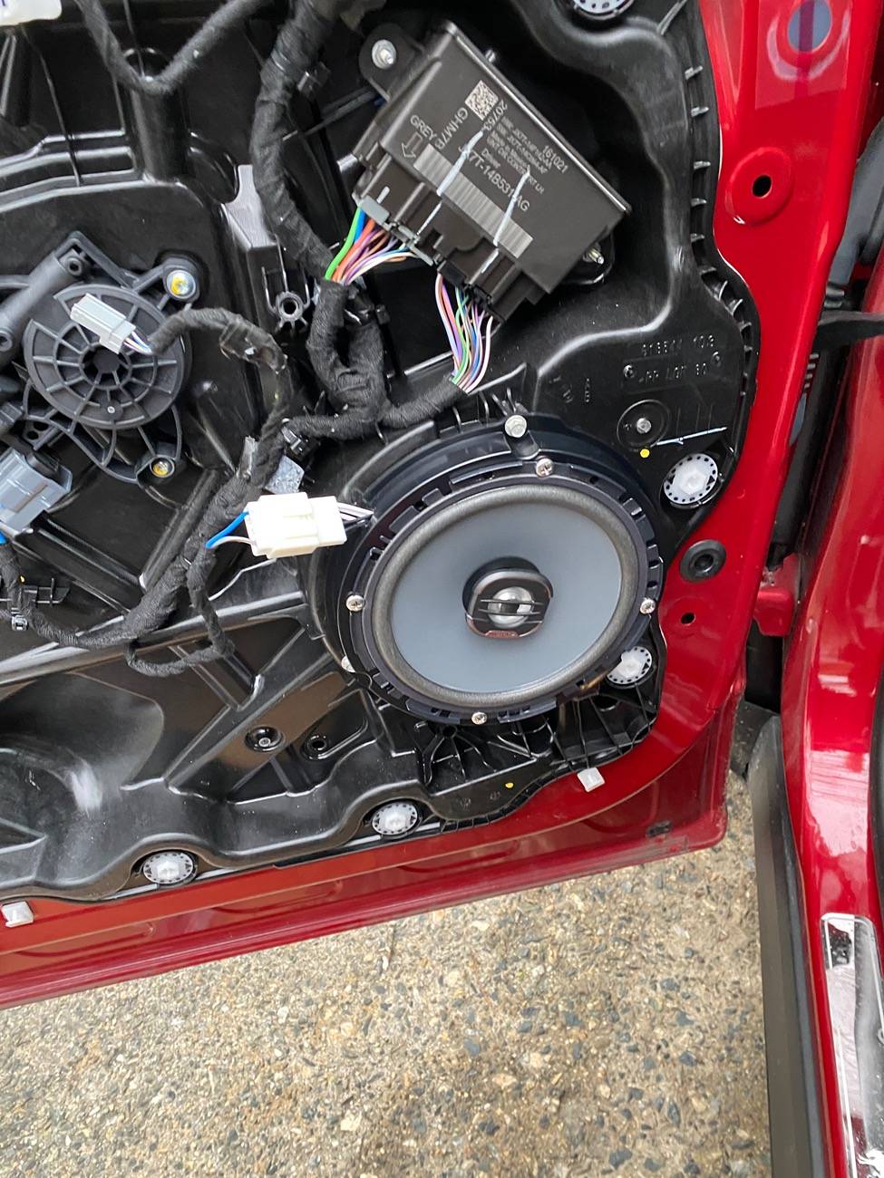

This is what I did when I installed the Hertz X170 2 way speakers from Crutchfield. This is the same harness and bracket as yours. The first pic is a mockup and the second is the final installation. The tabs on the inside diameter of the mounting bracket are designed to snap off with a bit of thumb pressure (the bigger tabs requiring 2 thumbs of pressure). There is no need to use any kind of cutting device to remove them. If your thumbs don't work like they used to then a pair of pliers should do the trick. There's many different mounting options with all of the holes provided in the speaker as well as the holes provided in the bracket. It may take a few tries to find the best alignment for your particular speakers. This is the best I could come up with to make use of 4 screws rather than 3. I forget the drill bit size I used to make the hole for the pigtail but it was just big enough to allow the connectors to the speaker to pass through and no bigger. The only issue I ran into was that the screws that came with the speakers were too small for any of the bracket holes so I bought some stainless screws from HD and that did the trick.
