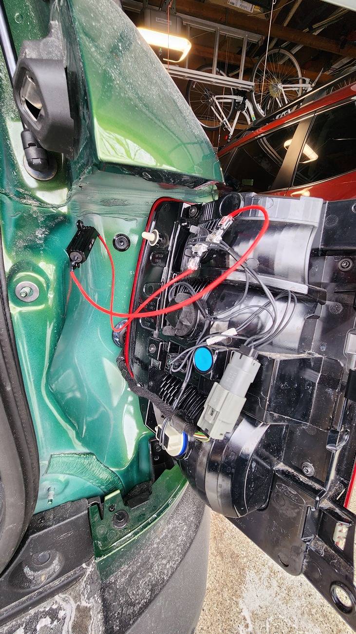

I just purchased LED bulbs from F150LEDS.com for my 25 Badlands and installed them today. This included rear turn signal LED bulbs and their CREE LED brake light bulbs. I did need to install their supplied resistors (that came with the brake bulbs) onto the turn signal wiring to prevent the hyper flash on the dash when using the turn signals. The bulbs look and function great now. Attached is a photo of the resistor installed. You need to tap into the two outer tail light wires for each resistor.

:crying: the mounting holes.
Did you use some silicone or something on the holes?
No. The area behind the rear light is protected and screws go in very tightly so didn’t think any silicone was needed.

I've had those tail lights out a few times. Protected by what? Did they change something for 2025? I've still seen it get dirty behind that lamp. Water can easily get behind there. I'm not a fan of poking holes in the body. I would just be worried about future corrosion. Your wire taps are okay at least they have the sealant on the inside. The weakest point of the resistors is where the wire goes into the heat sink.
I used resistors on our old 2021 but I crimped them inside the rubber boot.
I eliminated the hyper flash with forscan on our 24

I’ll keep an eye on them. My Bronco was pretty dirty and salty and the area behind the tail light was nice and clean. Should be just fine. I installed resistors on another vehicle of mine, similar to this install, 11 years ago with no issues as of yet at all.
