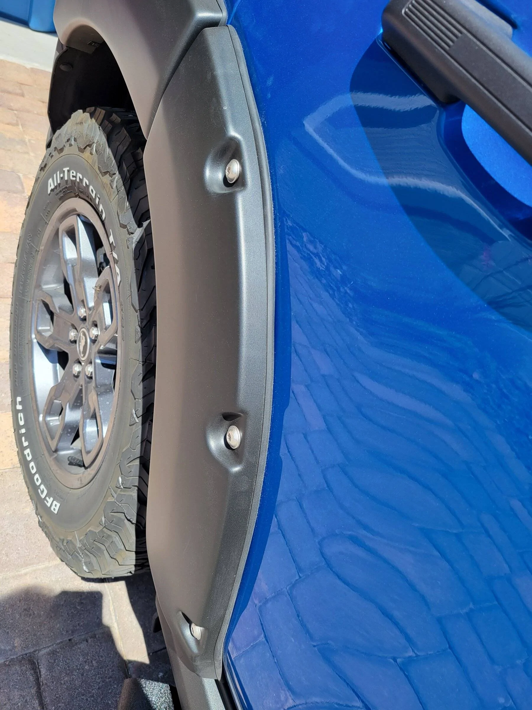

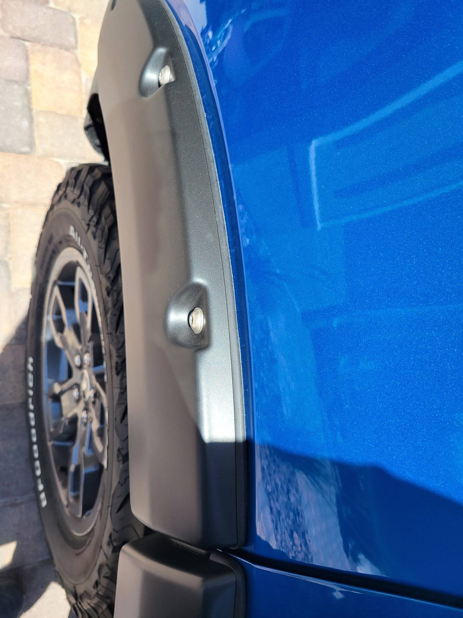

Hello all! I wanted to make sure to spread the information regarding the fender flares from rough country. I am 100% satisfied and the quality is on par to the ones from FORD. $200 cheaper though and the fit is amazing. Took about 2 hours for the install. See attached. Next is the roof rack and then the lift kit!

Do they install with clips like the Bushwacker flares?

Yes they attached using clips. 100% identical to the one I saw at a dealership. Very snug and no complaints.

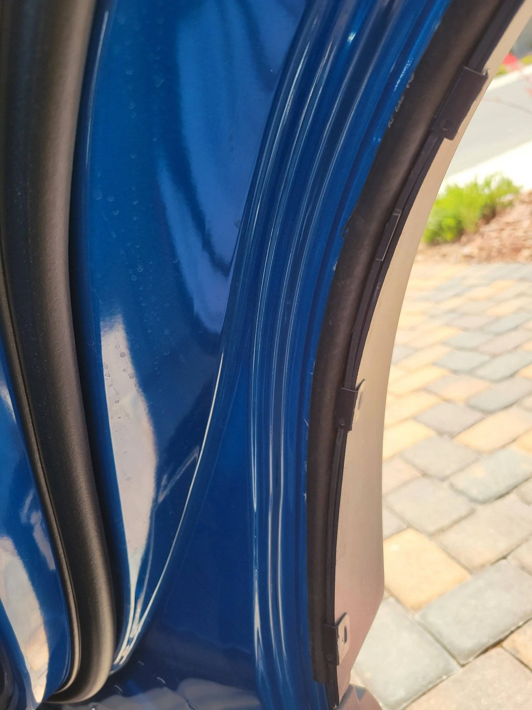

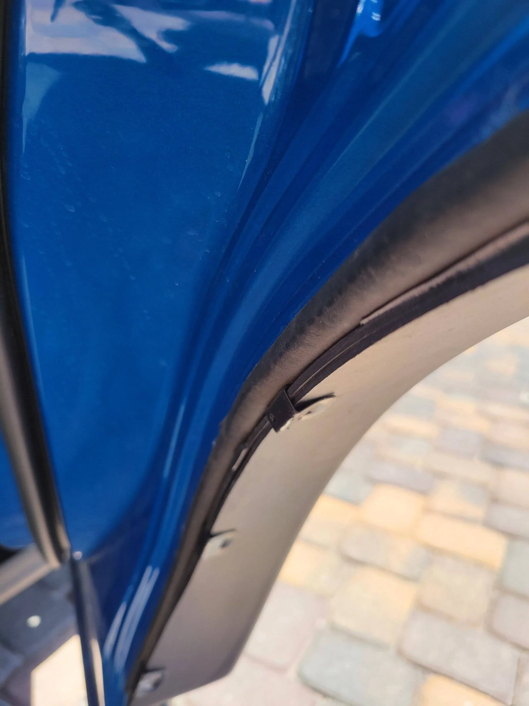

I have the flares from Ford and I will have to take them off for the winter because the flares on the rear doors are not that tight of a fit and will fill up with sand and salt. Do the ones from Rough Country have that problem?

Same issue. Found a solution I feel works well and doesn't look like I butchered it. See attached. I inserted a sliced fuel hose in my door gaps that were causing issues when the flares flexed from driving in high winds. With the hose it won't allow it to flex which is causing it to be loose. Taken it up to 80 mph now with no flexing.
