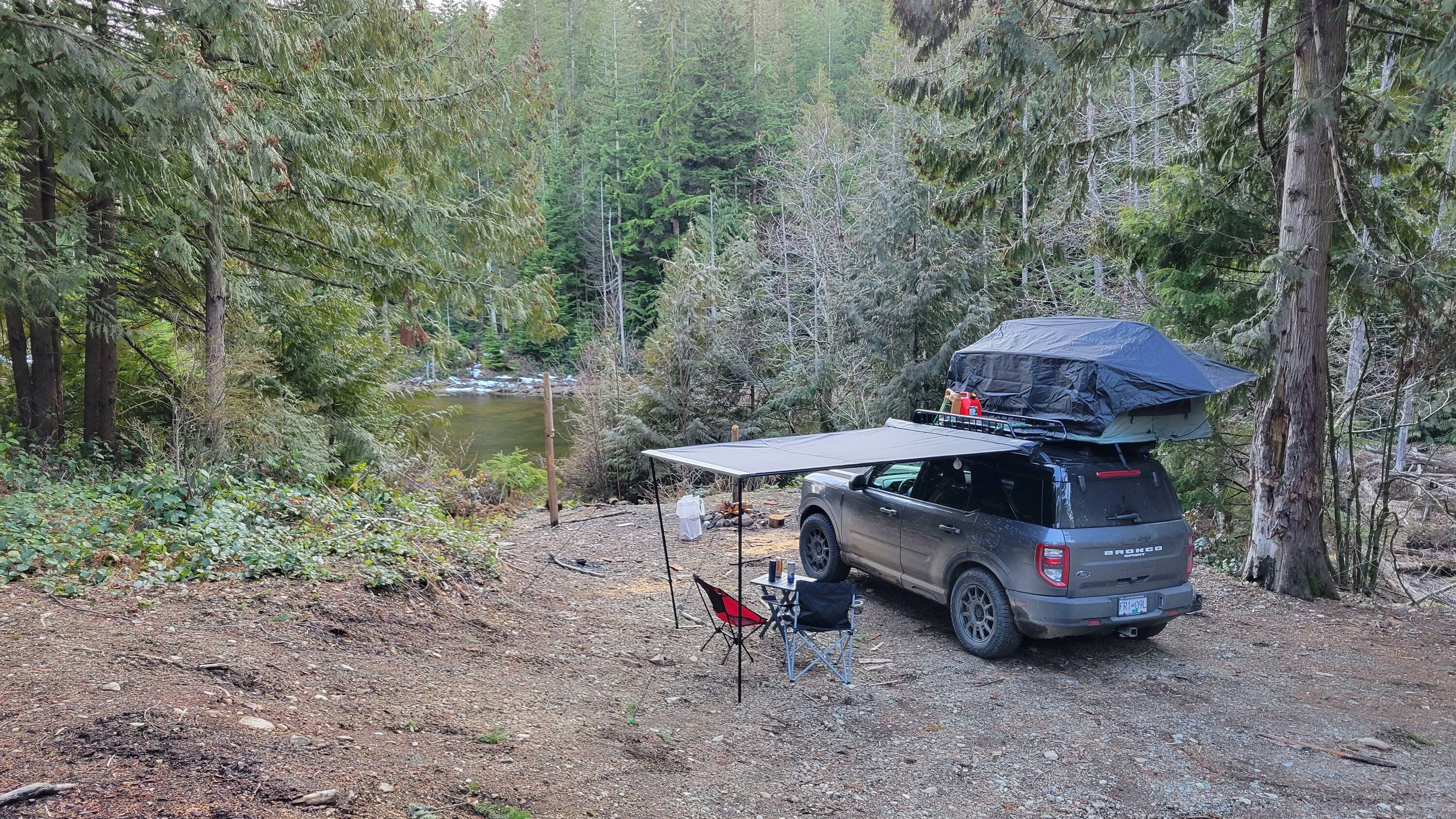

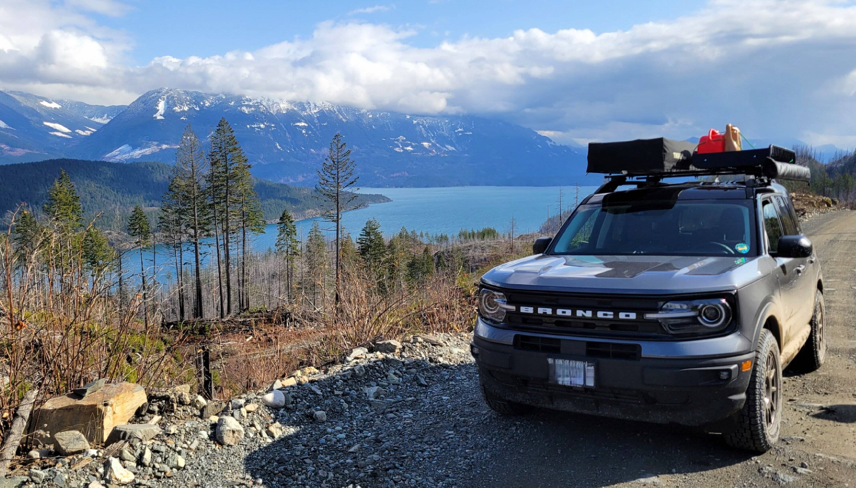

I have a thule foothill rtt and it's been great after changing to an air mattress inside of it. It's only 110lbs and only takes half the roof space.
