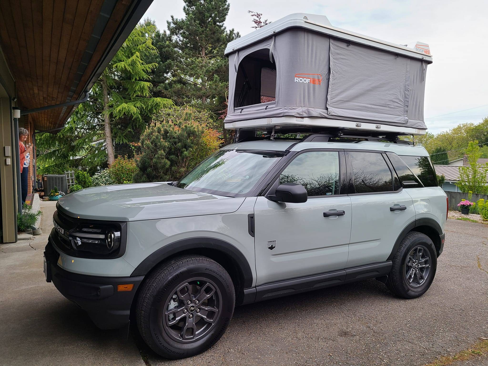

we have the smittybuilt tent, with the annex room on the thule wingbar evo setup. zero issues.

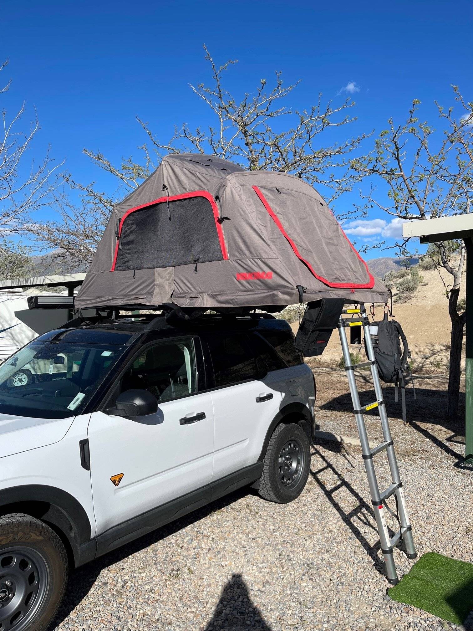

I went with the Yakima Skyrise HD3. Also have the Slim Shady awning, and the Yakima crossbars.
Ford Bronco Sport Rooftop Tent Recommendation for a Big Bend BS with 53’ Thule Wingbar Evo crossbars IMG_0159

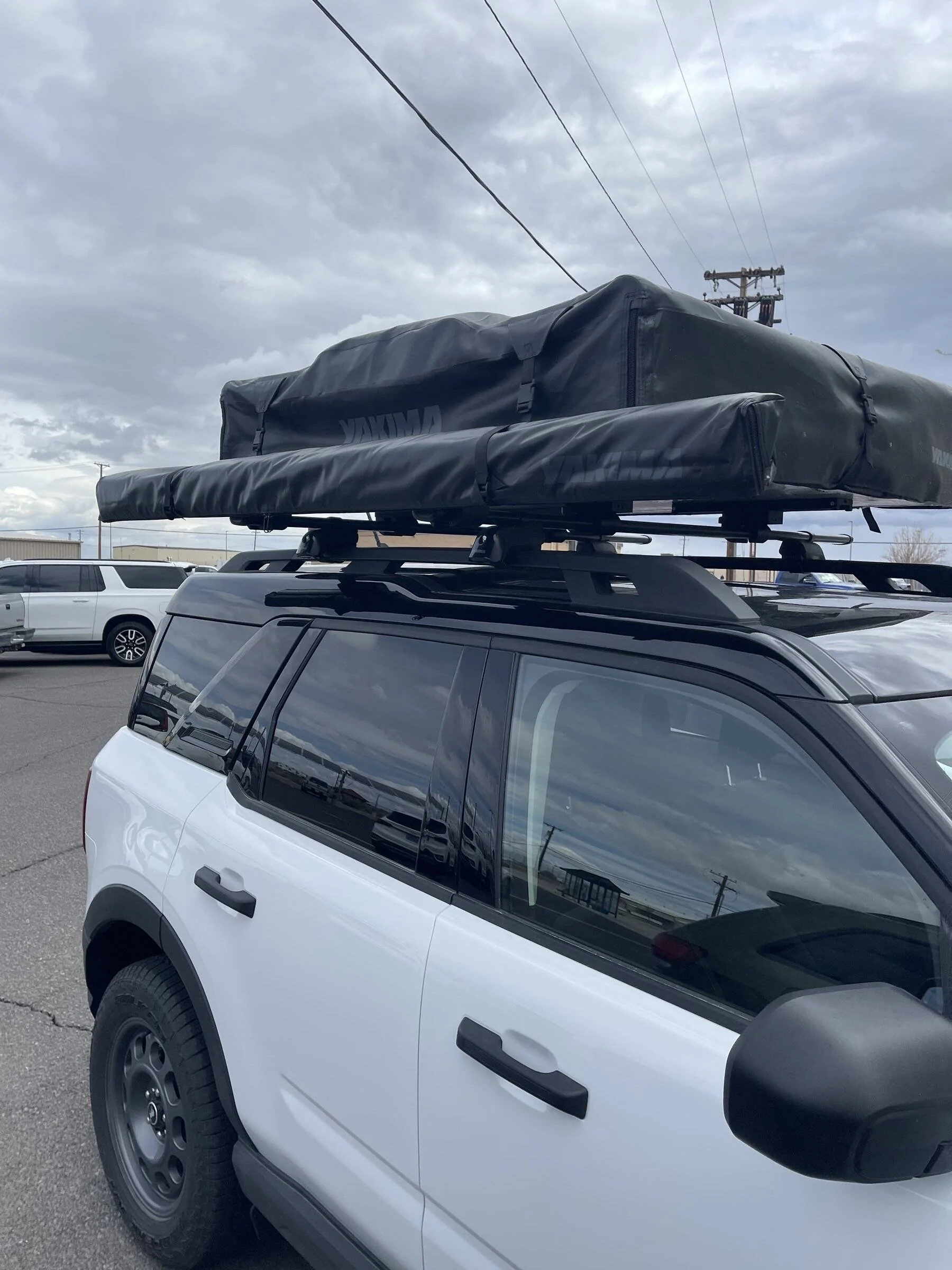

I have a bronco sport and I'm looking into getting a RTT (probably the one from Rough Country) but to be honest I would like the tent to open towards the back not to the sides, I have that taller crossbar so my tent would be sitting maybe 1 or 2in higher than yours. Would I be able to open the trunk? Even if it doesn't open all the way up, just about 80%, that would be ok. But would I have enough clearance for the ladder with the trunk open? Would it work? Thanks
Late reply I know but haven't been on in a while. I don't think you would be able to open the trunk much when the ladder was down. I suppose it would depend on the tent. Picture for reference.
Ford Bronco Sport Rooftop Tent Recommendation for a Big Bend BS with 53’ Thule Wingbar Evo crossbars BRONCO RTT
