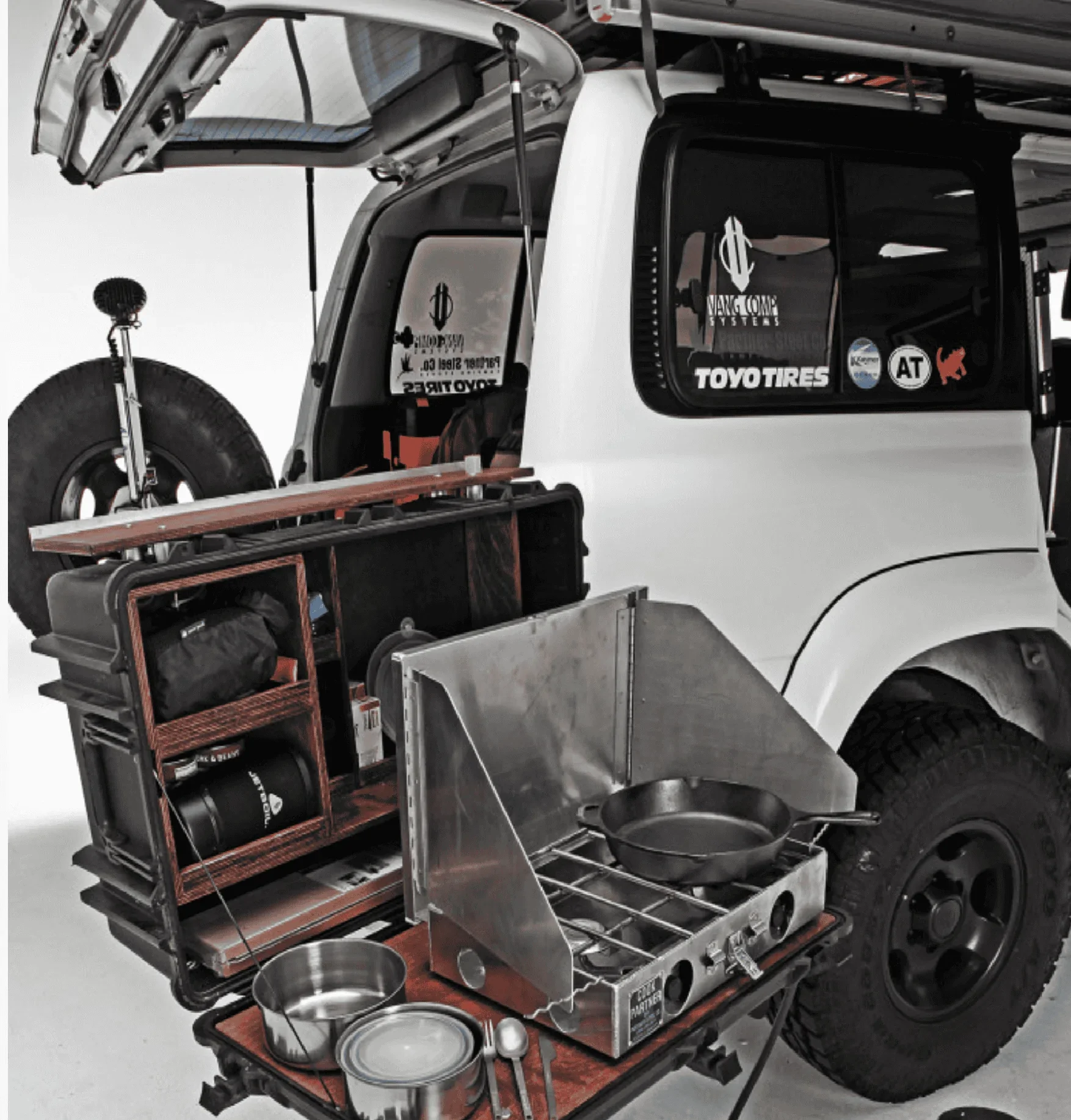

Getting back to the hitch rack cargo carrier - anyone think it'll work with a Kuat Pivot?? I'm gonna reach out to Kuat but may get a "that's not under warranty, not the purpose of the Pivot, & we're not responsible response."
Hoping to get get the cargo out of the way and still access back of BS, have a little swing away kitchen setup at standing height if needed :) That way at least roof could handle bikes and recovery gear.

Swing away kitchen? That would work for Bronco Sport... explain please!
http://www.kuatracks.com/product/pivot/
No idea if it'll work but thinking about attaching a hitch cargo rack type device to carry cooler and retrofitting the setup for a table/kitchen....we'll see. I was just spitballing, again, gotta wait for it to be delivered and see the recommendations, most likely minimum insertion length. 250lb limit on the Pivot, otherwise actually see a few other options on the market just for this!
https://www.stowaway2.com/swingaway-hitch-frame or
https://www.stowaway2.com/hitch-grill-station
