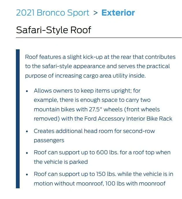

Do we know what the dynamic and static roof weight limits are? The Bronco 2 door and 4 door had this information posted in the specs section of the website but the Sport did not. I am interested in purchasing a roof top tent and would love to see at least a 450lb static limit.

Here is what I could find for you

Thank you so much Albert! 600lbs is perfect for a roof top tent +2 and gear. Excited to hear this. I am really surprised that the Sport has a higher rated roof weight than the 2 and 4 door.

Well the rating that the Big Bronco boys are up in arms about is the travel weight which is just a bit more less that Sport has of 150...
Travel weight is what you can have loaded down towards the roof while at highway speeds which has it own force...and I will stop there..

The moonroof (on FE) lowers the weight to 100 pounds which is going to eliminate all tepui tents. I guess I will be looking for a ground tent option. Too bad.

So... to clarify... in motion, everything on the roof is capped at 100 Pounds with Sunroof.
Do you folks see that as an issue at all regarding racks and carriers?
As in. Seems like all these roof racks and carrier are around 30 pounds give or take. So gear needs to be under 70 pounds to be super safe... Is 70 pounds of gear a lot of room to make it work or is it cutting it thin?
Also, 600 pounds of weight... same for sunroof or without it... so basically the aerodynamics while driving are such that it just can't handle 150 pounds of weight.
