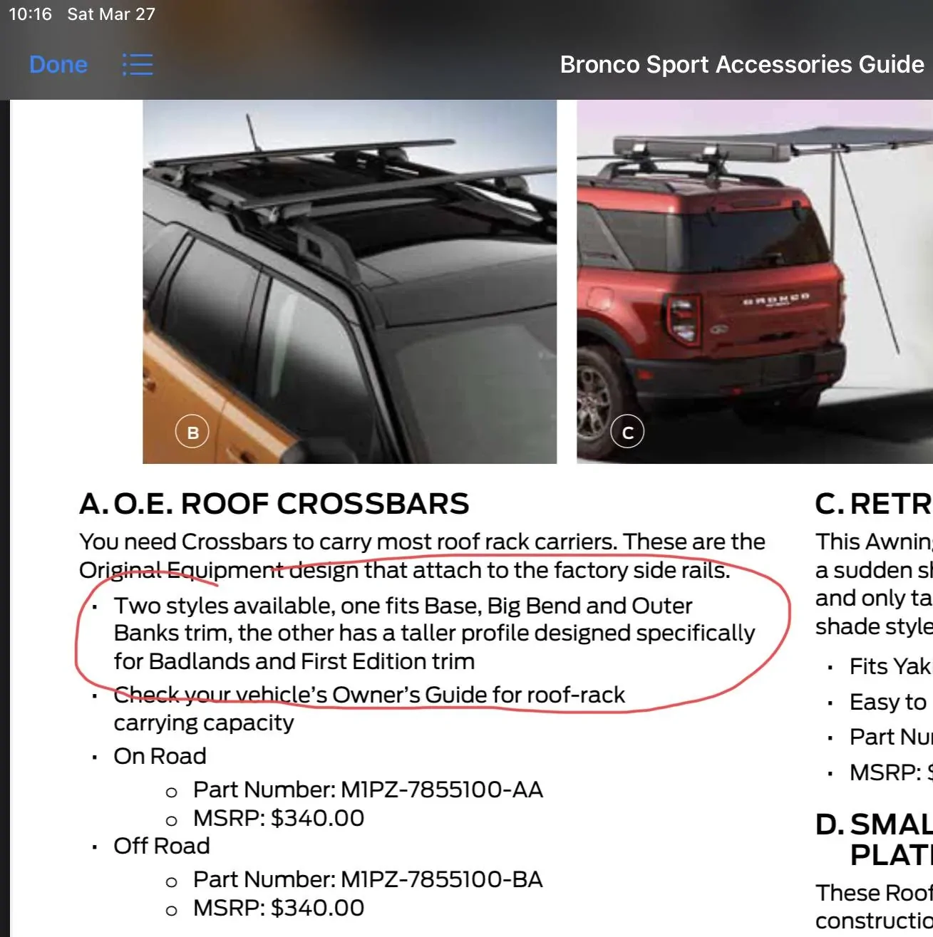

From what I remember from another post that you get a front set and backset because the rail changes size. The poster said he had a like issue until he caught rail size change. Could this be your issue?

The size of the rails doesn't change but the distance *between* them changes from front to back. Also note there are unique crossbar versions specific to "on road" (base, BB, OB) and "off road" (Badlands and FE) models.
Where did you find that information? I'm genuinely curious because if that's indeed true, it seems like a recipe for headaches for both Ford and the consumer.

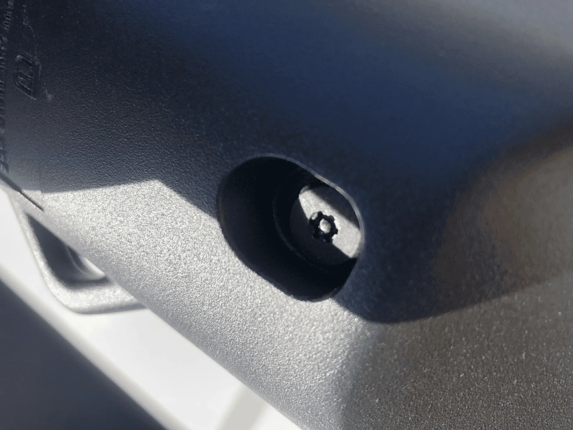

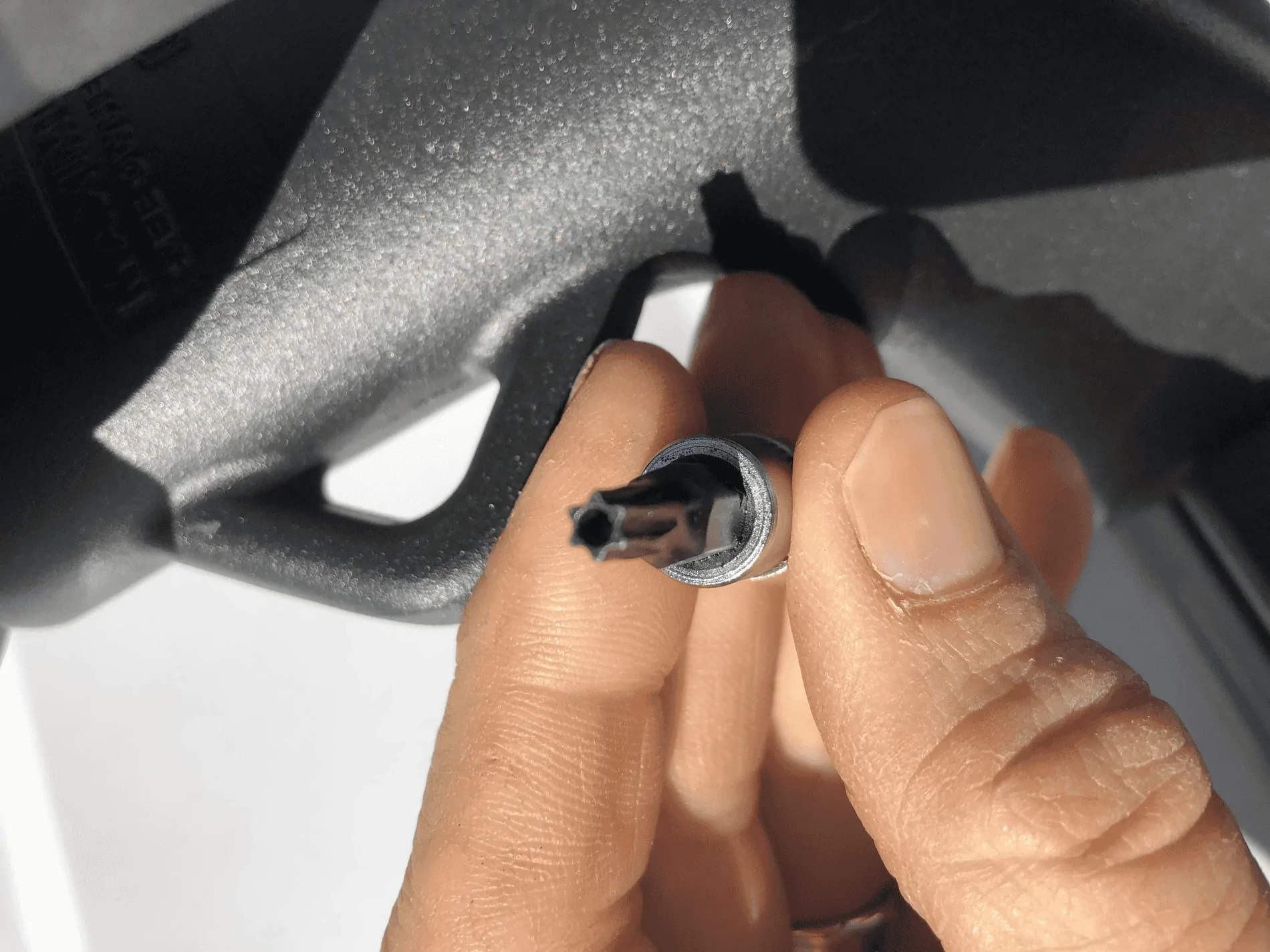

My dealer neglected to leave me the torx key, could you share the bit size?
Thanks

it is a T25 security tore bolt. make sure you get a security bit or Allen key. they have a hole in the center of the star shape because the bolt has a nub inside the head. T25 security
