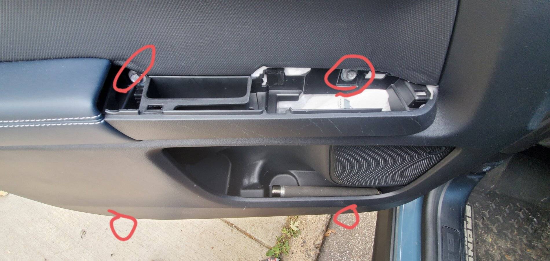

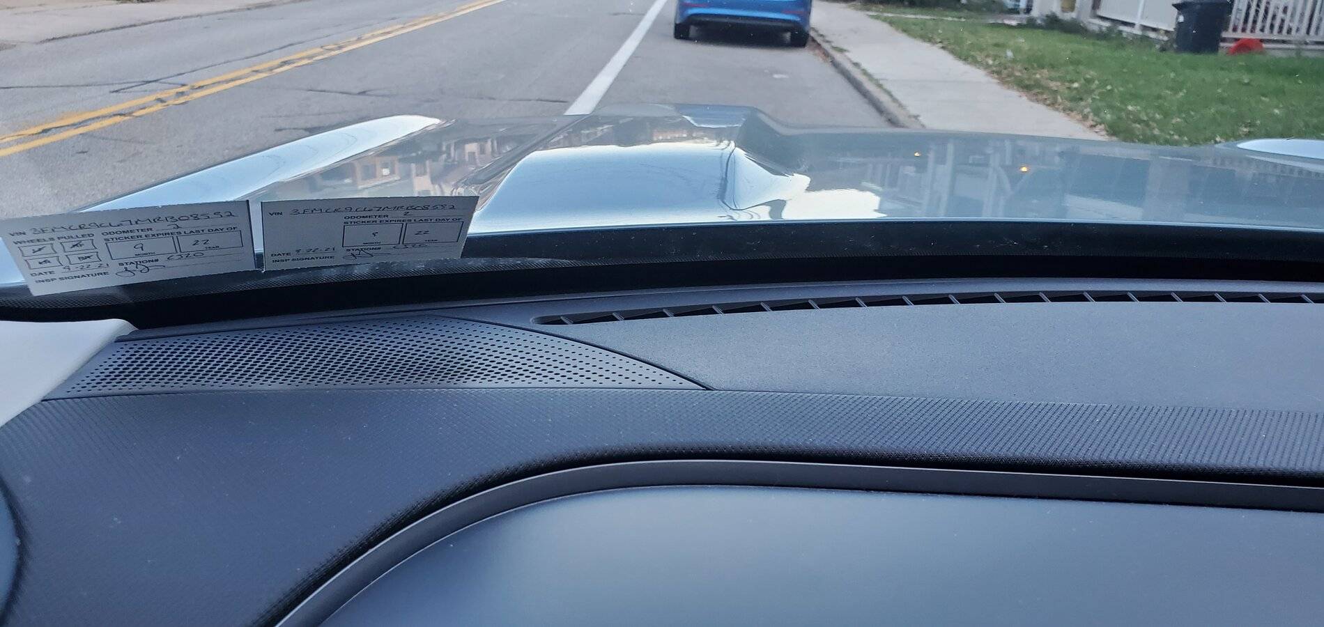

So I replaced my non B&O speakers and all the doors in my outer banks. I bought new tweeters as well but I can't figure out how to get to them. I started popping up the piece that runs along the front of the dashboard near the windshield. But there are two places at each end that won't pop up easily. And I don't want to pry too hard because I don't want to break it. How do I get to these? Do I have to remove the a pillars? Has anyone done this yet?

Just replaced mine. You must remove the A pillar. Pull out from the top then upwards. There’s a bolt under it that needs removed. Then you can remove the entire grill to grill section. I took some snips and cut off the factory tweeter mounting bracket and used the hole under it. Wrapped 3m sticky tape around tweeter housing and stuck it in the hole. Probably better ways to do it but it works for me.

Not as much as I’d like. I ended up moving them to the A Pillars last night with some adjustable aluminum pods I got on eBay. There was just enough room to squeeze the hardware in there without touching the vent. Now they sound perfect. I’m going to be hooking up an Alpine amp to them when I have the time.
