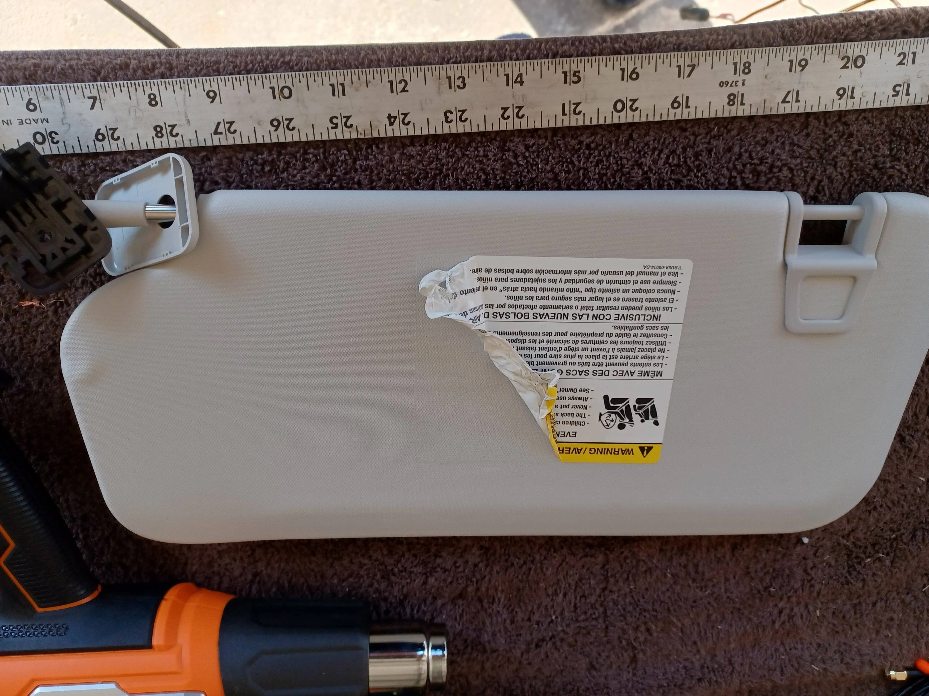

I got mine off today with a heat gun on LOW! A hairdryer will work too. Pick at a corner with your fingernail until there is enough to grab. Warm it up slightly, and it will come off in one piece. I keep my visors down most always; To me, this looks much better.
Be advised... There is still a visible residue even after mildly scrubbing with different solvents, including acetone. Can't see it unless you're holding them up to the light. IMHO: Not noticeable when mounted.
