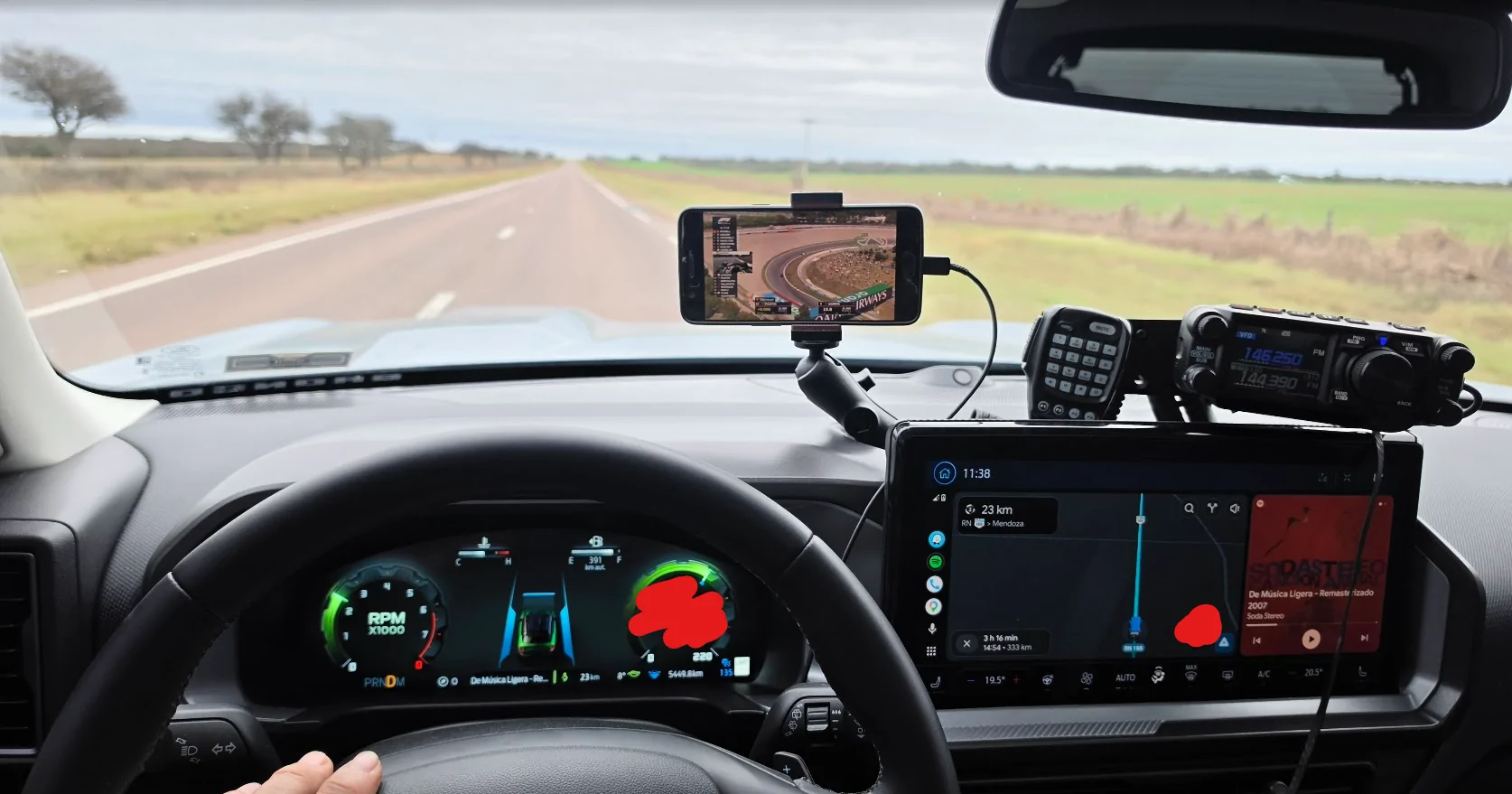

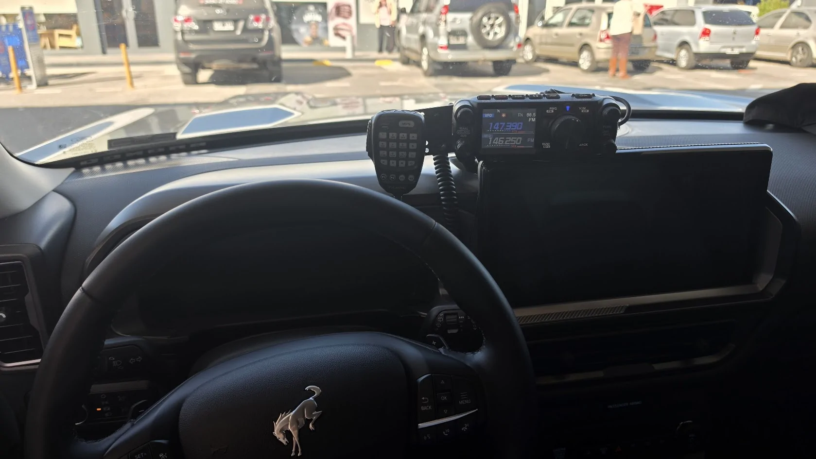

Just to share... No need the Bulletpoint Rubigrid... Just 2 RAM MOUNTS, 1 inch ball RAM Mount.
One for Phone and/or universal camera (goPro, etc). the otherone
Ford Bronco Sport remove screws from behind screen 1782222872626-22
Ford Bronco Sport remove screws from behind screen 1782222896483-d3
Another configuration
Ford Bronco Sport remove screws from behind screen 1782226624811-vv

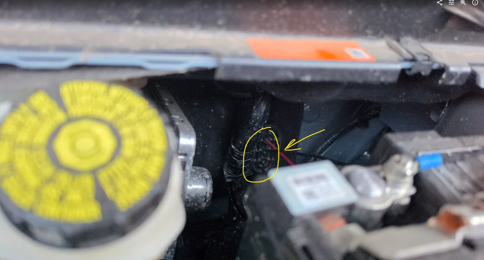

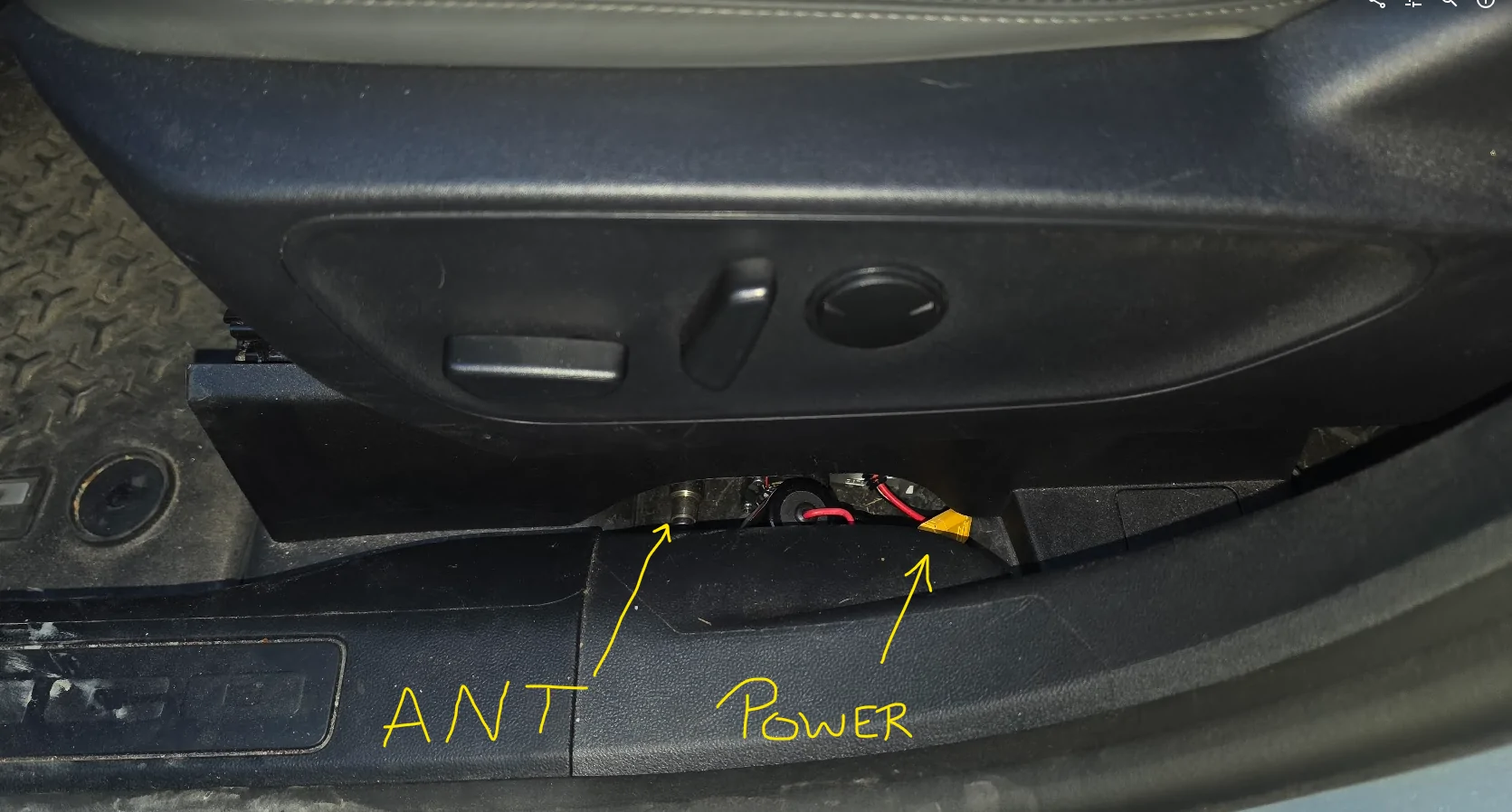

Looks great. I still have some thoughts for my self. Where is the best/easiest place to mount the radio, not the head the main part, and how did you do the wiring to the head?

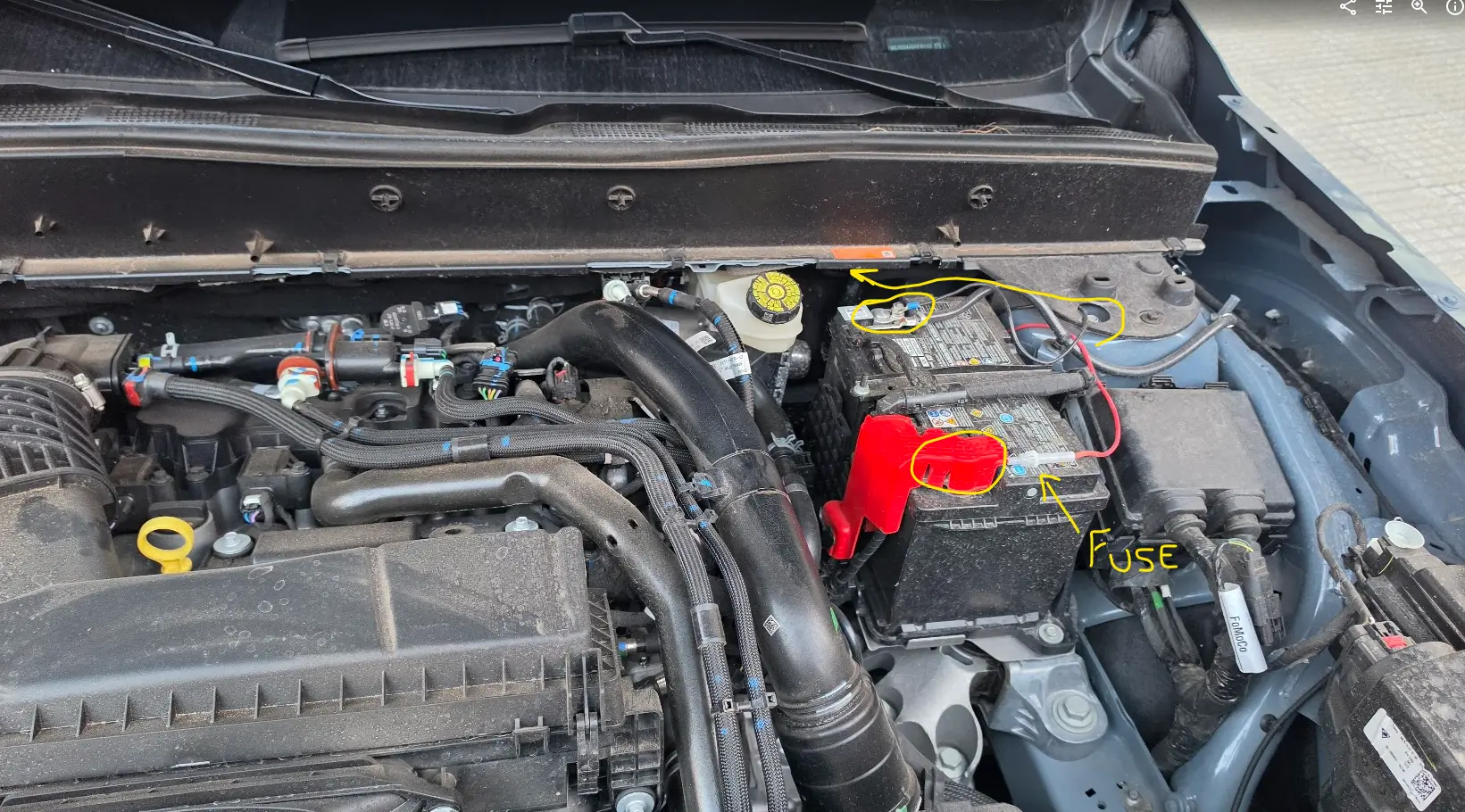

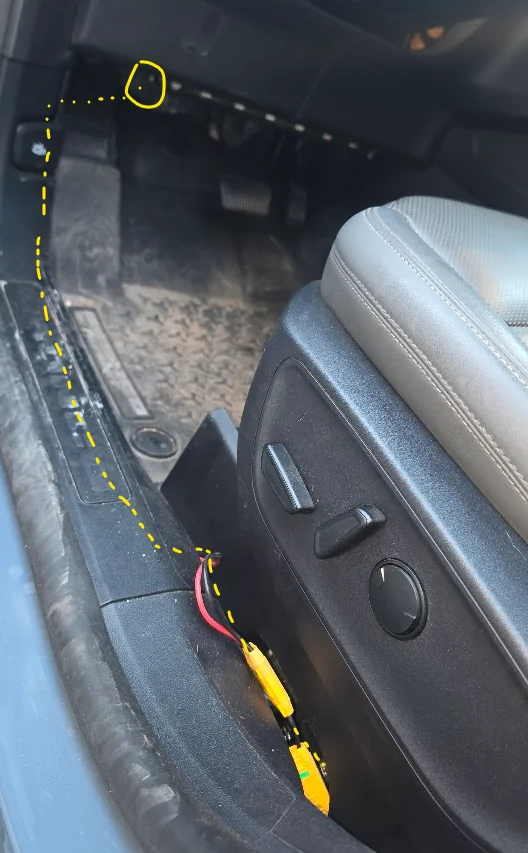

Thanks! I’m actually planning to improve the installation quite a bit soon, and once I do, I’ll make a proper post in the group with more details and photos.
For now, I have the main radio body mounted under the driver’s seat.

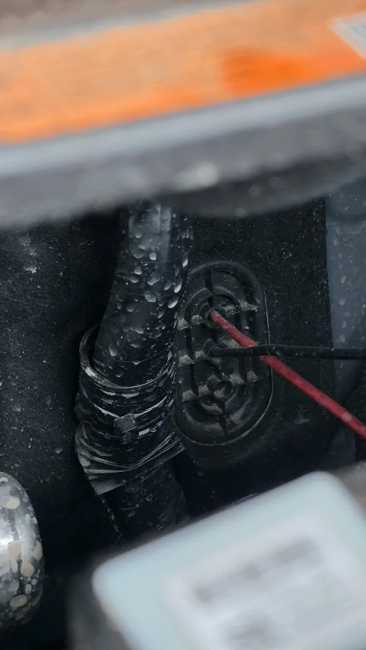

The power wires come directly from the battery, pass through a rubber grommet near the steering column, behind the brake pedal area, then run behind the lower trim along the driver’s door sill and end up under the driver’s seat.
Ford Bronco Sport remove screws from behind screen 1782300747666-n2
Ford Bronco Sport remove screws from behind screen 1782300782762-96
Ford Bronco Sport remove screws from behind screen 1782300823081-71
From the inside.
Ford Bronco Sport remove screws from behind screen 1782300845755-5o
Ford Bronco Sport remove screws from behind screen 1782300887030-gk

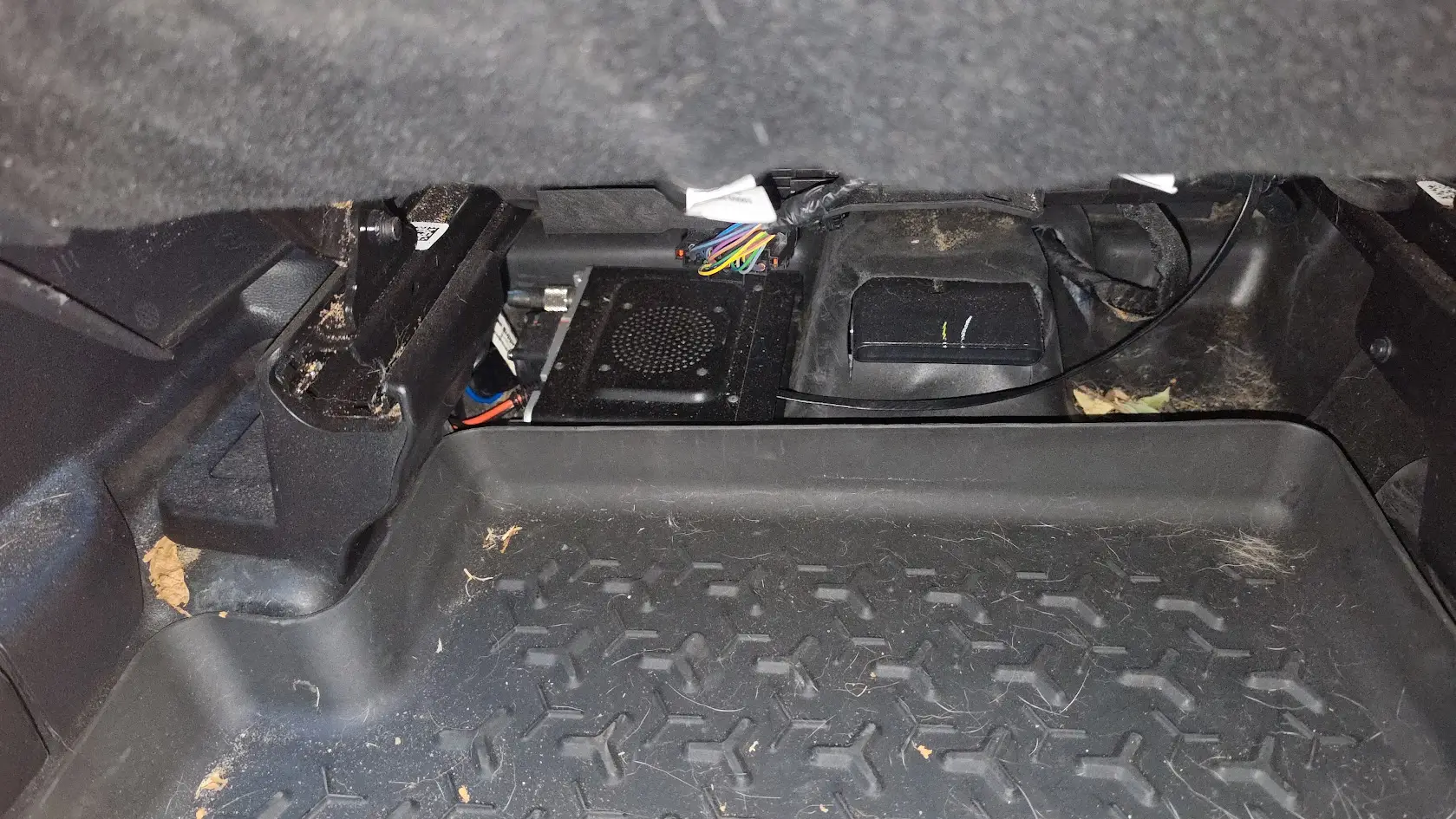

Ford Bronco Sport remove screws from behind screen 1782300986541-rs
From the back of the driver seat.
Ford Bronco Sport remove screws from behind screen 1782301003672-kx

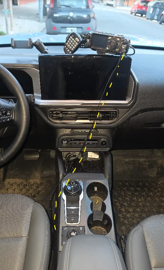

From there, the UTP/control cable goes from the main unit to the head unit. That is currently the part I’m not fully happy with: the cable runs visibly through the center console up to the accessory tray, where I currently have the head unit mounted.
EXAGERATING THE PATH....
Ford Bronco Sport remove screws from behind screen 1782301085808-qt
My next plan is to redo that part. I want to mount the head unit in the overhead sunglasses holder area, then route the UTP/control cable above the headliner, down the A-pillar, and back down toward the area under the seat.
From the inside.
From the inside.
