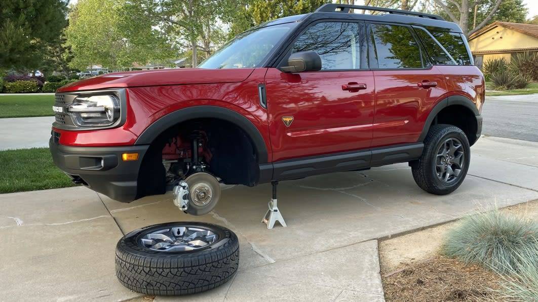

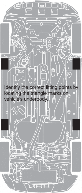

Here is one location anyway........
Ford Bronco Sport Recommended Jack Stand Placement? 0_lede-copy
Ford Bronco Sport Recommended Jack Stand Placement? 2021-Bronco-lift-points-350x823

I've used the solid pinch points with great success. Had the entire vehicle up on four stands no issues at all working on the oil, tire rotation, etc

Thanks - that was my go to
If you are using the "solid pinch points" for the jack stands, then where are putting the jack?
6,727
13,167
I haven't needed to put the rear of the vehicle on jack stands yet, but I used the frame just inboard of the lower A-arms for the front.
So where did you lift with your floor jack when utilizing 4 jack stands?
2,164
3,157
Belleville, IL
When I need it up on 4 jack stands, I use the front pinch point as a jack point, the rear pinch point for the jack stands in the back, and then the subframe just inside the A-arms for the front.
