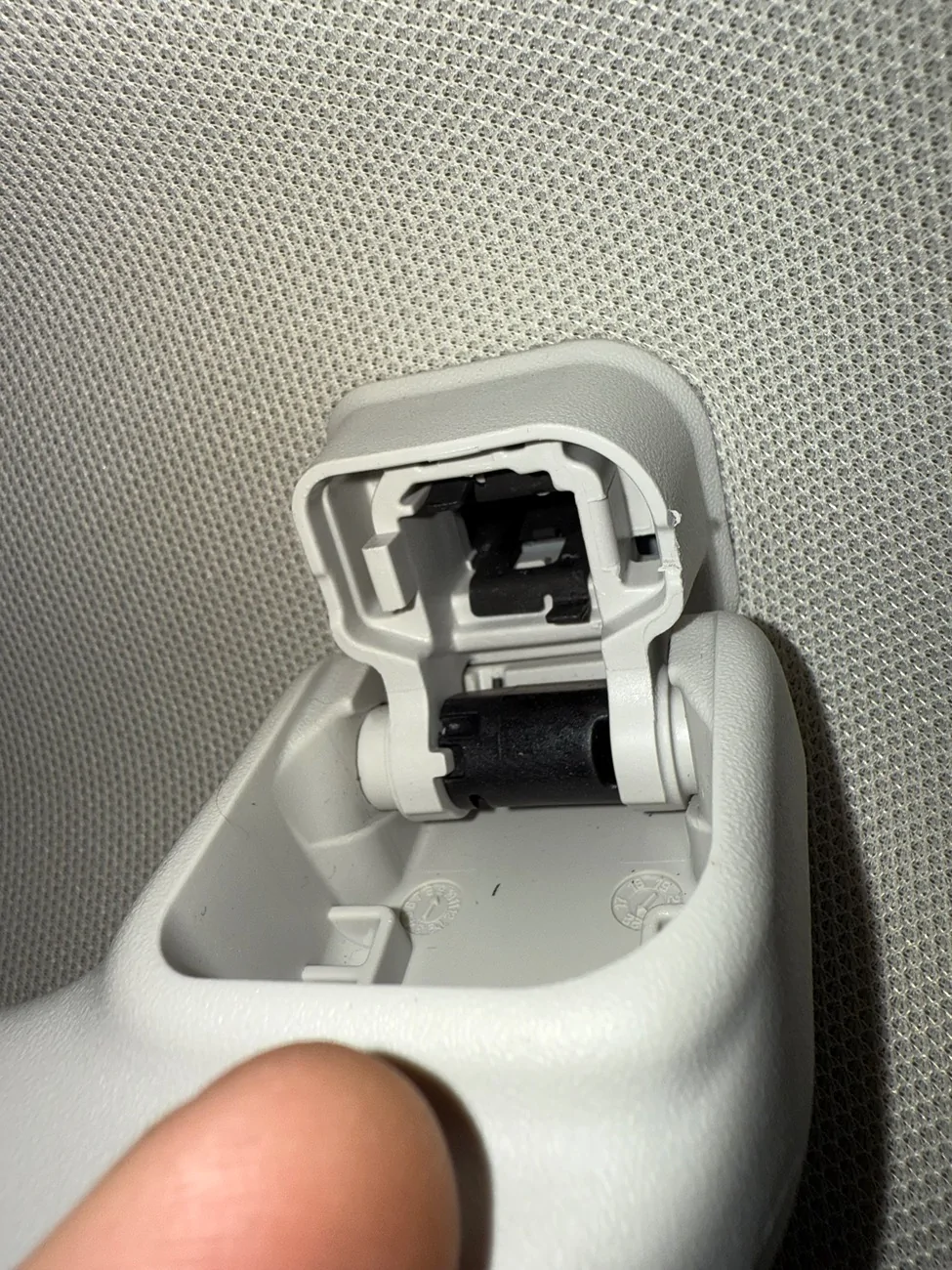

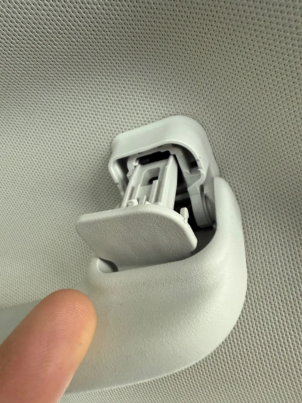

UPDATE:DID NOT FIX IT FOR MORE THAN A DAY
FIXED IT! OH THANK GOD JESUS!
Idk why this particular tapping/rattle noise was so enraging to me but after a couple weeks of trying EVERYTHING I got it to finally shut up on my way home today.
The whole story is as follows

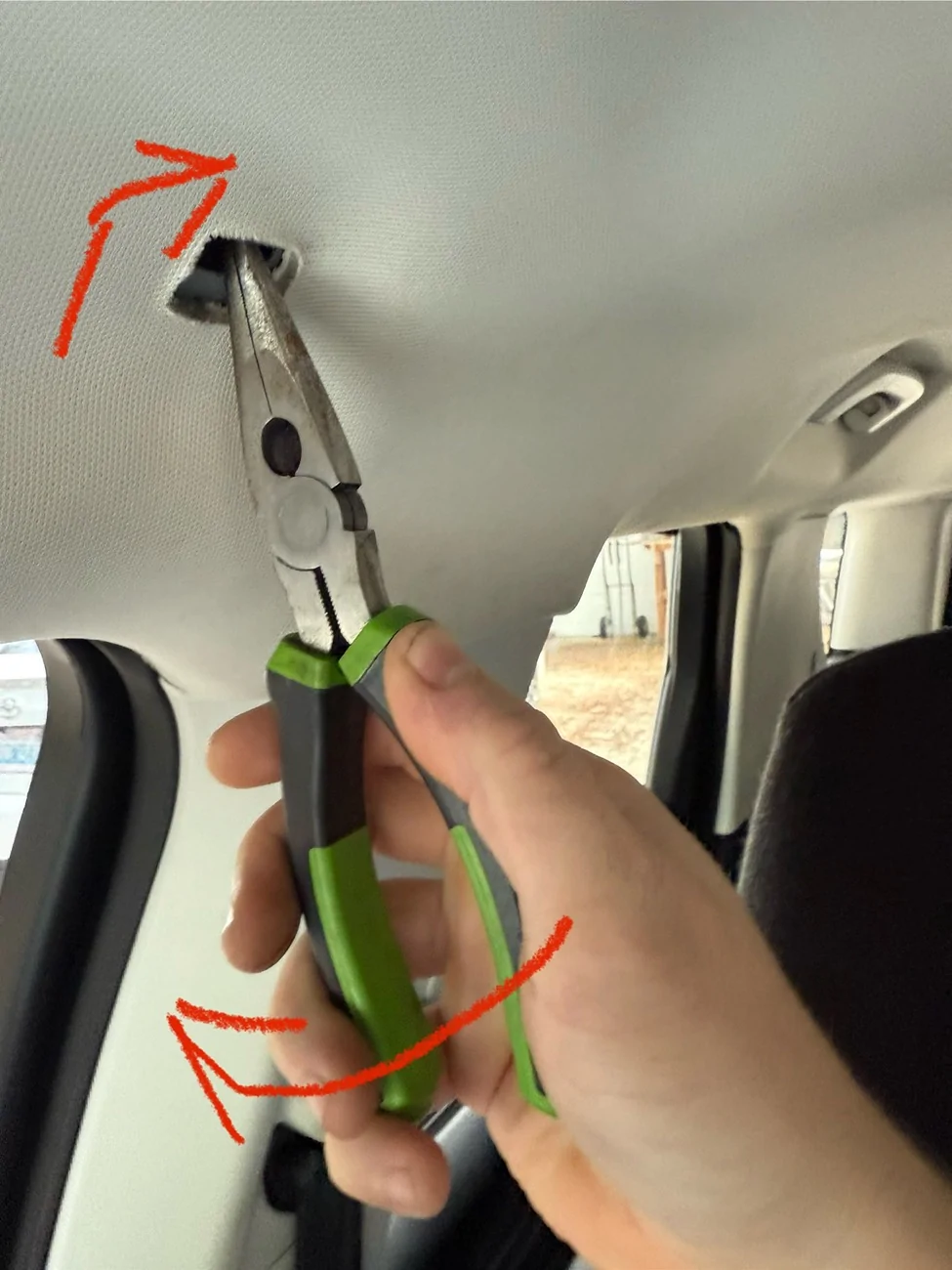

I initially put cloth tape behind seatbelt mounting bracket on B pillar and taped white plastic housing at top of B pillar behind headliner. Neither were my issue.
While my wife drove I had my trim removed and headliner lowered and I touched every bolt, plug, wire, plastic etc with absolutely zero effect on rattle (careful not to trigger air bag, I realize how not smart that move was but I was reaching a point where I didn’t care if that airbag took my head off if it meant getting rid of this god forsaken noise)
The only thing that for sure stopped the noise was pushing on the metal bracket that holds the right side of grab handle. If I pushed on headliner directly under the hole as hard as I could it would stop it as well.
So while driving today on my way home I put needle nose pliers in the hole of the bracket at an angle and when the click would start I applied pressure. Lo and behold the sound stopped. If I removed pressure it started again. So out of frustration I applied enough pressure to bend the bracket ever so slightly, not as hard as I could so as not to destroy the hole for grab handle. But just enough to feel like it was readjusting the angle. And voila, the noise is gone.
I realize this little maneuver does not require a write up but I feel like I have my sanity back now and am sharing this for anyone in the future so they don’t have to endure the constant rattle.
TLDR; used needle nose pliers inserted in right side of bracket for grab handle and bent it (pushed handle of pliers towards passenger window) til the rattle stopped
