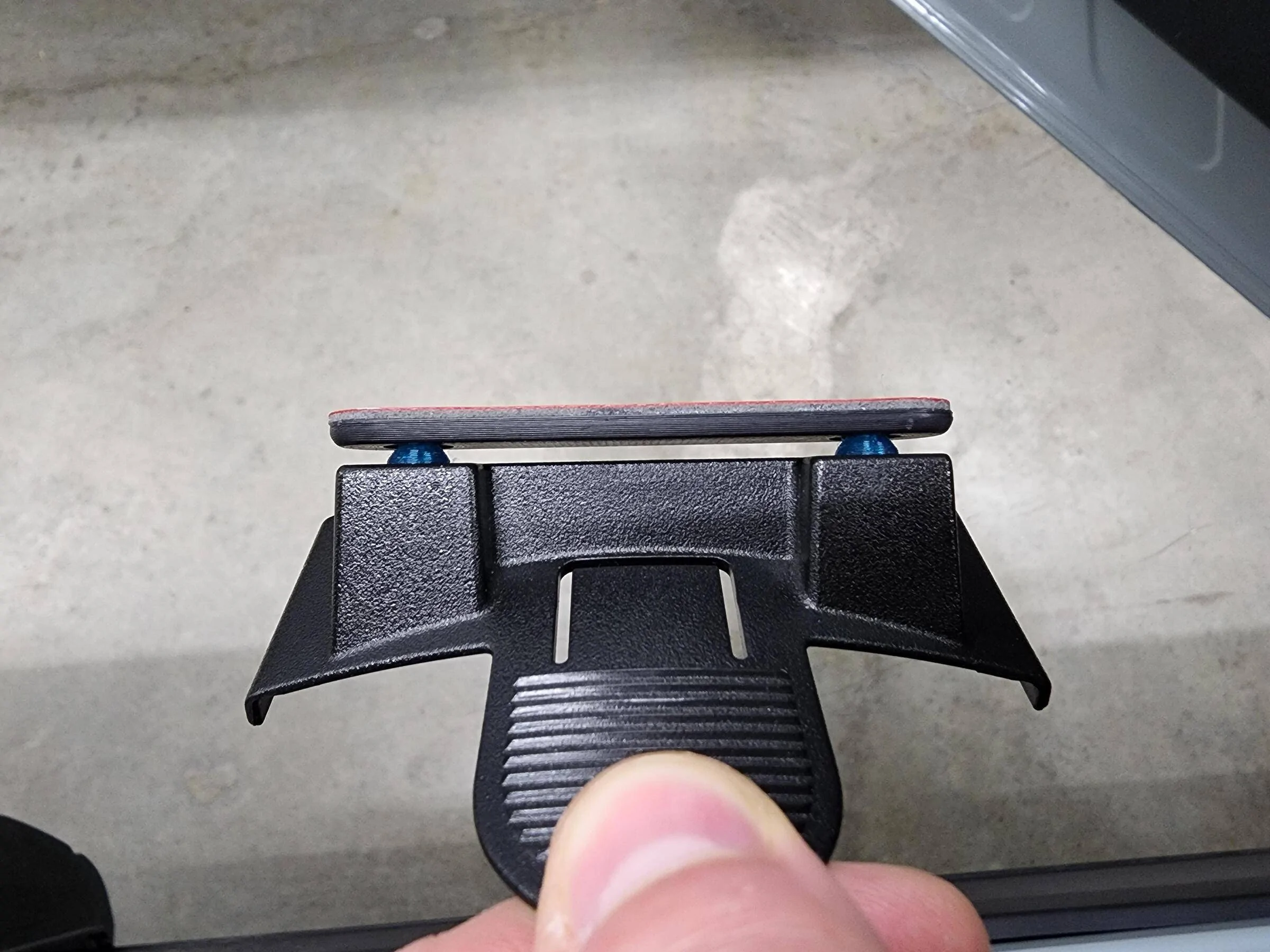

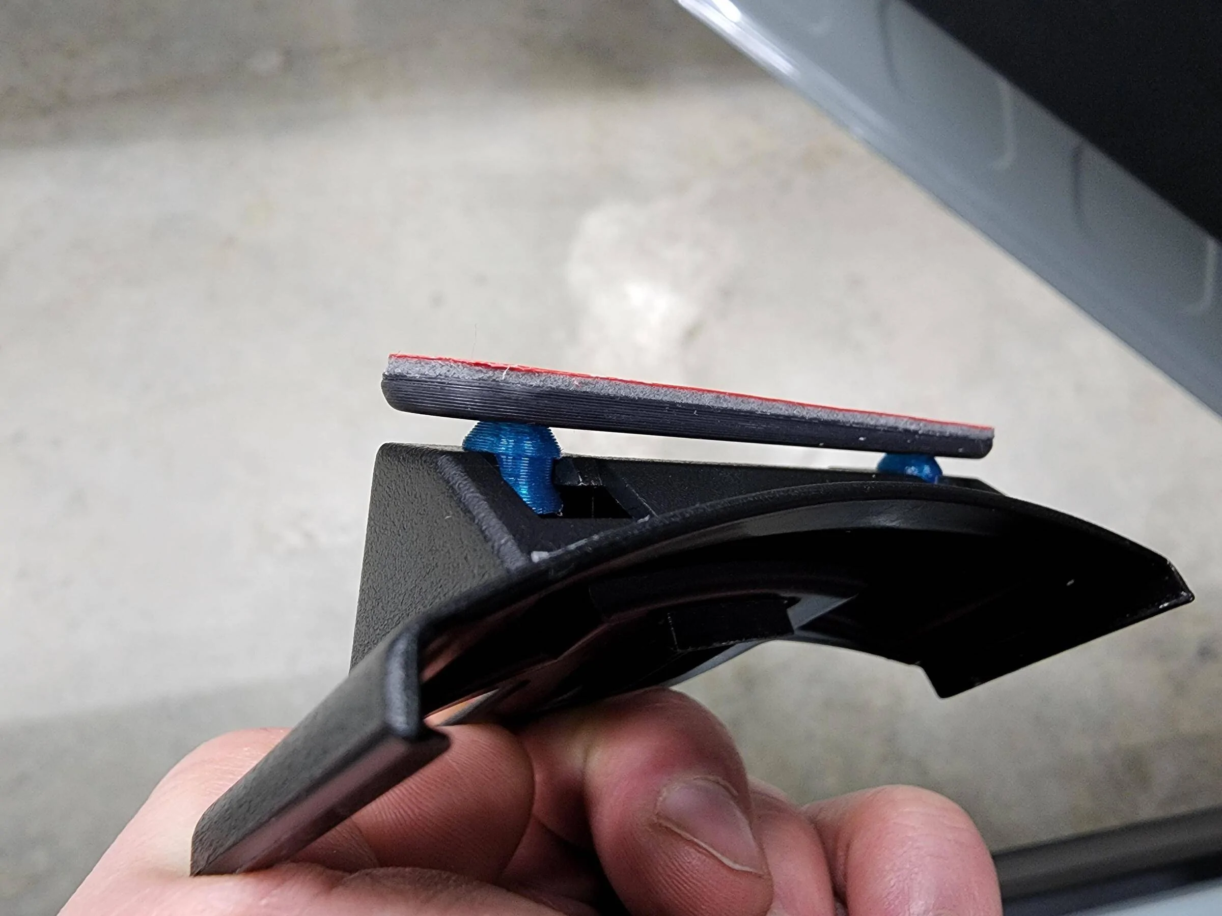

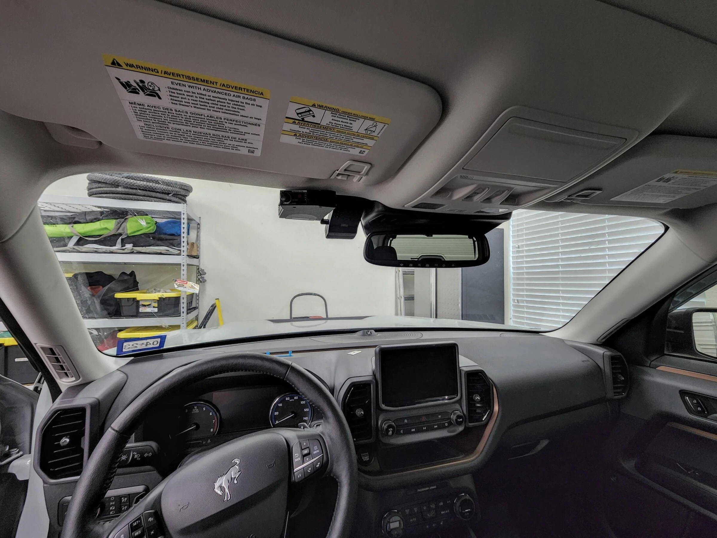

My Valentine One radar detector has always had problems sticking to the windshield. Suction cups are trash, so I've tried gluing the suction cups to the windshield. It works for a while, but eventually gravity prevails. Nothing wants to stick to the suction cups once summer rolls around.

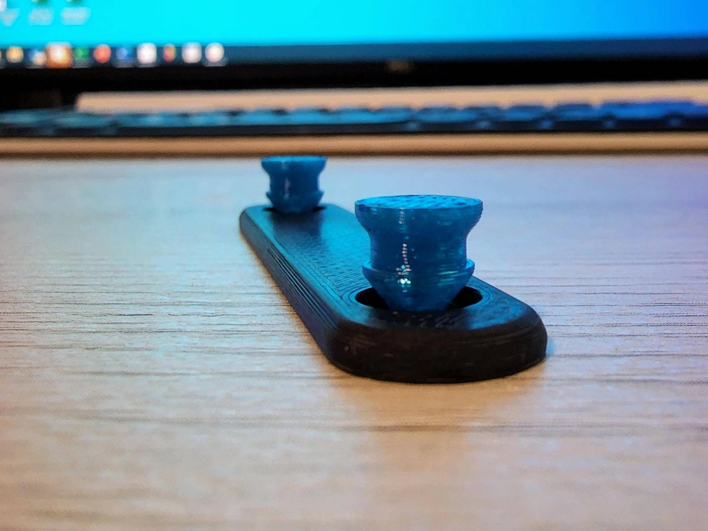

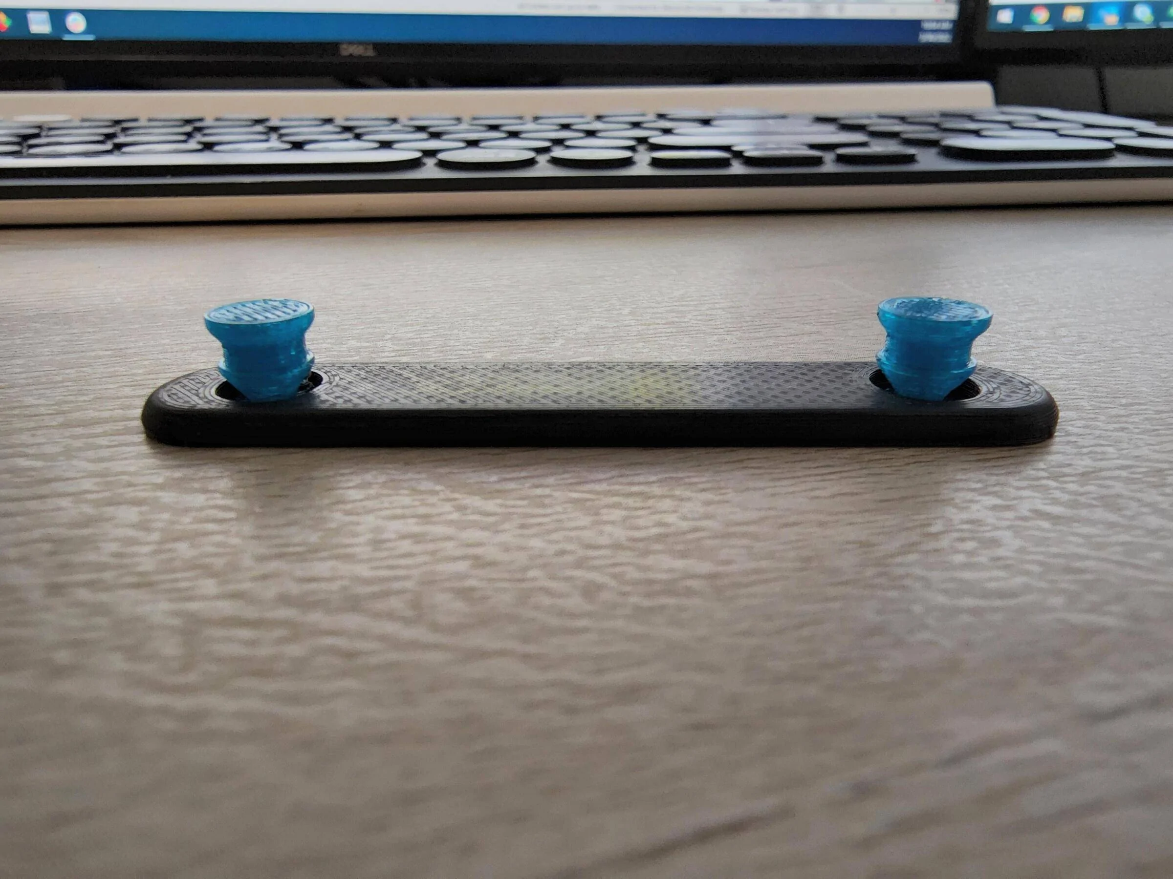

3M VHB tape has never let me down, though! So I 3D printed a mount that will allow me to toss the suction cups and use VHB instead. The black plastic is ASA and the nubs are TPU. The TPU makes engagement with the mount easier, provides some vibration damping, and allows angular adjustment.
We'll see if it survives the Texas summer! I'll have more pics of it installed this evening.

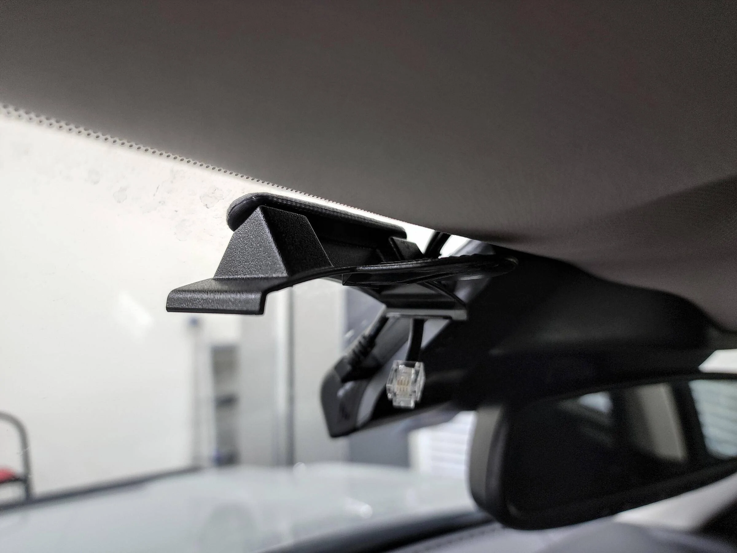

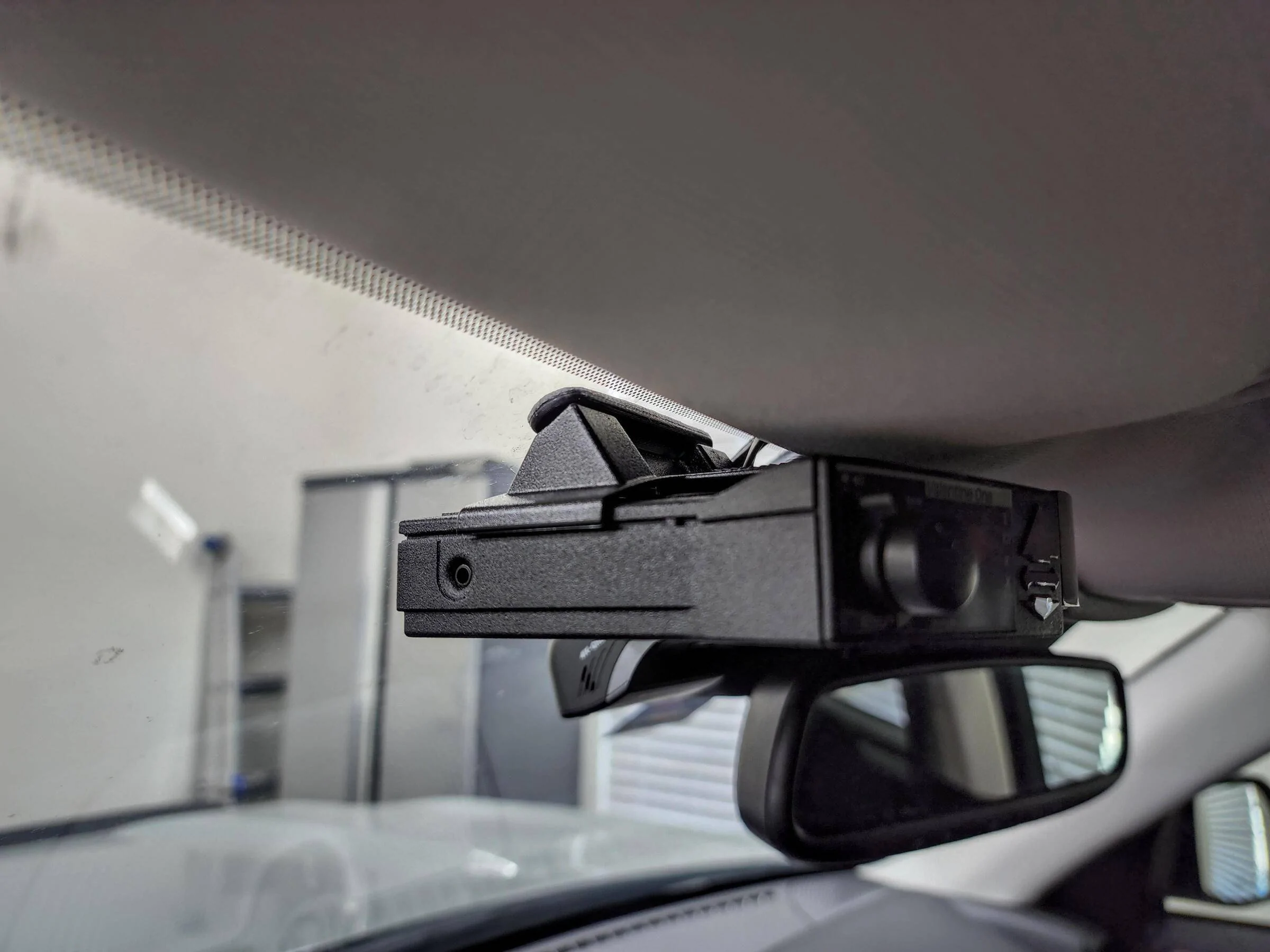

EDIT: Installed pics added.
Ford Bronco Sport Radar Detector Mount - 3D Print c6R0rGM
Ford Bronco Sport Radar Detector Mount - 3D Print dIlQyR
Ford Bronco Sport Radar Detector Mount - 3D Print VkUTlVx
Ford Bronco Sport Radar Detector Mount - 3D Print Pin9VL7
Ford Bronco Sport Radar Detector Mount - 3D Print dVAvHNn
Ford Bronco Sport Radar Detector Mount - 3D Print 6xmLrff
Ford Bronco Sport Radar Detector Mount - 3D Print KAH9m4O

I'm not a fan of mirror mounts for the BS. The plastic surround for cameras and such already blocks a lot of windshield. Plus I have to have my toll pass sticker horizontally centered on my windshield, so the detector would have to hang pretty low to clear that.

Looks good. I can see how a mirror mount would not be preferred on the BS.
BTW, because of the load on the tape, this design might peel off relatively easily. If you extended the top of the bracket you made up toward the headliner, the tape would be under less load. Just something to consider if this particular design doesn’t hold up the way you want.
