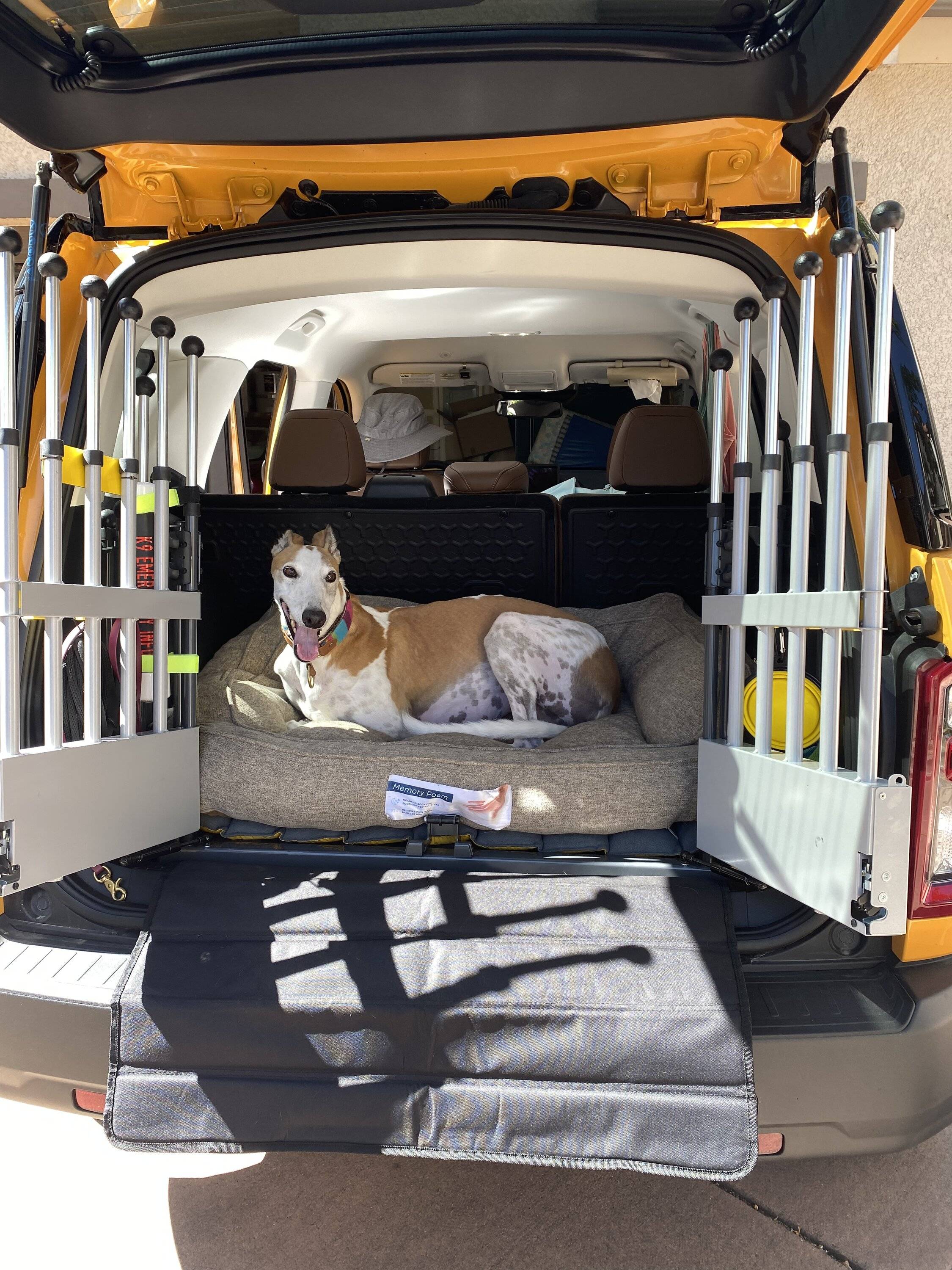

Thanks for the suggestion! As for the kennel, I think I have settled on the MIM VarioGate or some variant of it. It offers the best crash protection and room with the benefits of being 'portable.' I personally don't mind having him in the passenger compartment, but I noticed seats appeared too high/tall for him to get in and out of easily.
