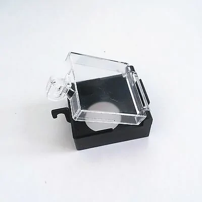

Plexiglass cover for your shifter? Easy mod.
