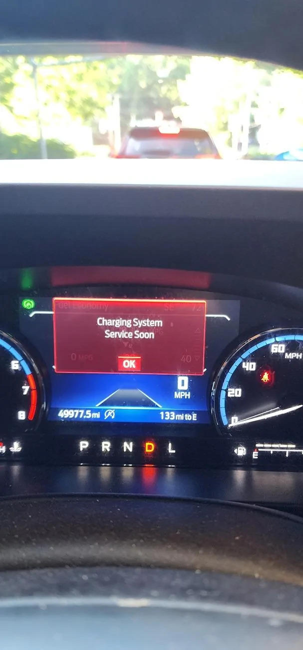

My Bronco sport was runing pretty good before I did the update (recall 24s24). Didn't really have any weird issues besides bad gas mileage. After I did the update every time I'm idling I get charge system service soon. My gas mileage dipped to about 16 MPG. Before that I was averaging around 20. I am pretty freaking upset. I was on the fence about getting the update since my car was running fine and everything was working as it should.
@SondraBurnsRed I recall seeing a Fb post where during the install of Recall 24S24 there was an issue where it appeared the 24S24 installation did not complete correctly… was that your post?
Were you ever able to revert back to BCM/PCM Configuration software prior to Recall 24S24? (Or get 24S24 completed correctly)
I also recall seeing the Purge valve solenoid was replaced, not sure if that was your vehicle and was a cause of the bad gas mileage?
Did you resolve what was causing the drop in gas mileage from 20 to 16mpg?
