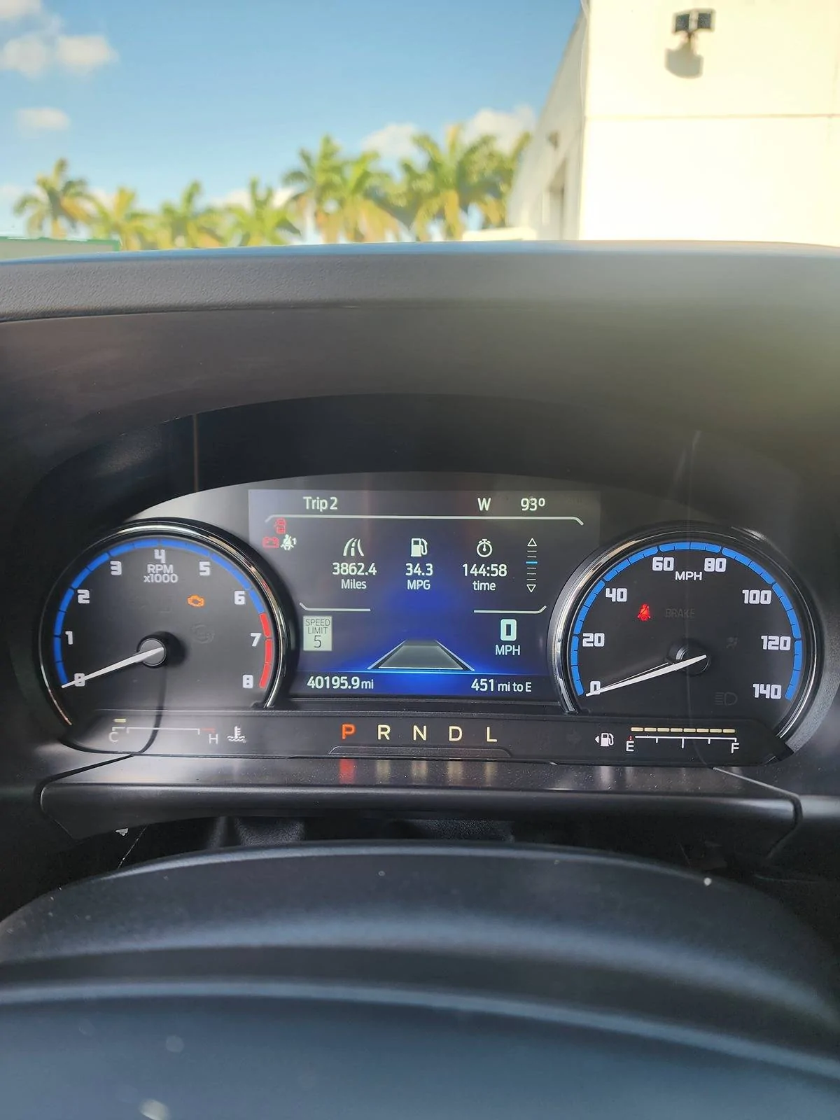

My before the mods and after the mods calculation method is the same.
Milaege ÷ Gallons = MPG.
I also adjusted my Fuel Bias using the Engineering Test Mode programmed into the ECU. The factory setting was off by 10%. I readjust every 10k miles to reflect the most accurate MPG. My current long term MPG is 34.3, (3862.4 miles).
I use Chevron 87, full syn Motorcraft oil, 38 psi tire presure on stock 18" wheels and cruise control as much as possible. I have gotten over 45 MPG one tank averages with a tail wind on 45 to 55 posted roads. MPG killers are city driving, head winds and going over 65 MPH. Of course cargo and passengers effect MPG as well. Higher octane fuel adds maybe .5 higher MPG but the extra cost doesn't offset the gain.
