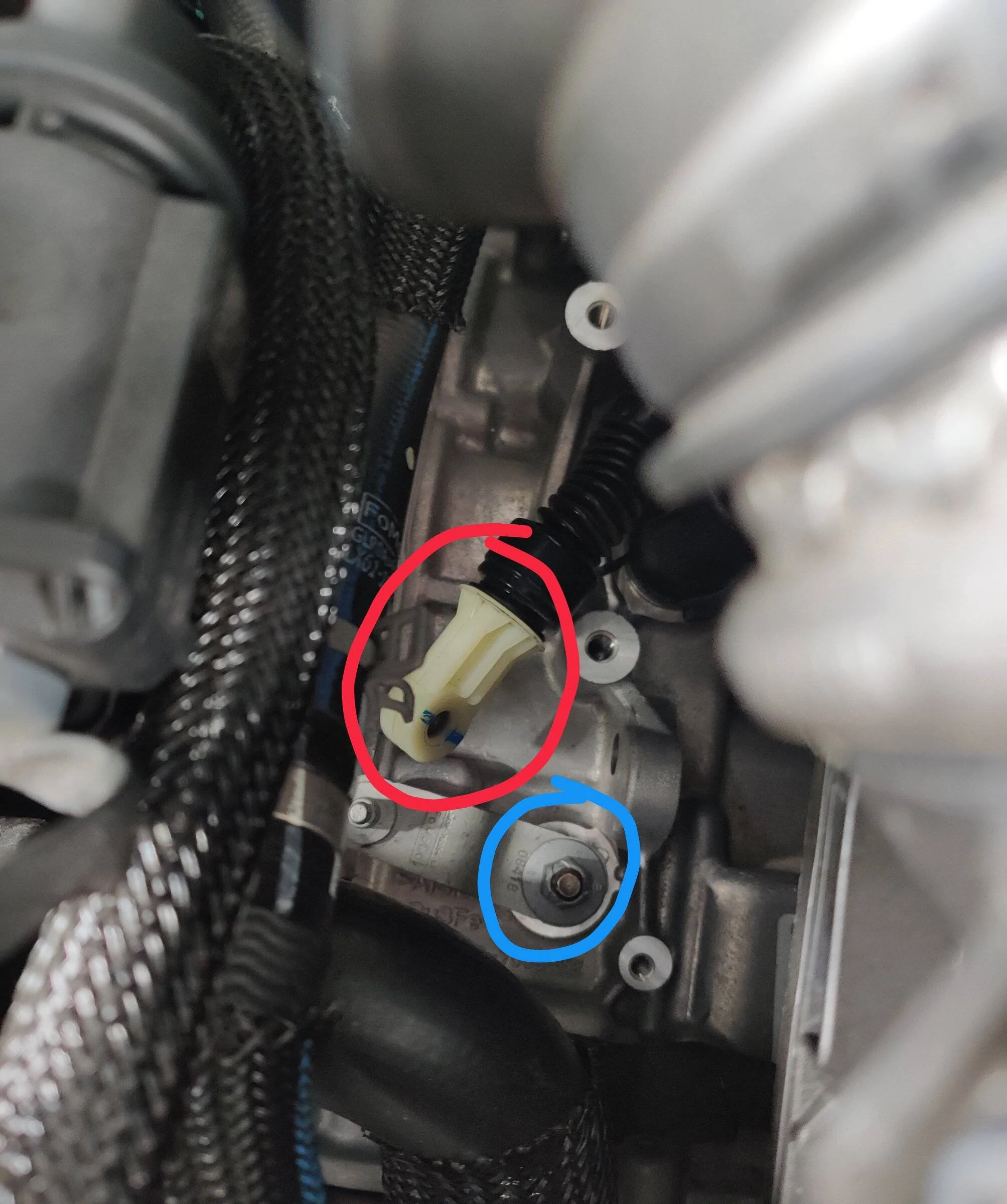

Update: i took my BB to the dealer for maintenance and they didn't find anything, i pointed out about the grinding noises at low speeds but they said it was "normal".
That aside, as you can see in this picture i've disconnected the park release cable thinking that the noise would be gone as mentioned in this forum. Turns out it didn't and for some reason i can't seem to connect the cable (red) back on. i try to pull it but it doesn't reach the connector (blue). any ideas?

I have no knowledge of how this cable works but I'll give my 2 cents. Start your BS (maybe even put it in neutral, chock your wheels), will that give some slack to that cable?
