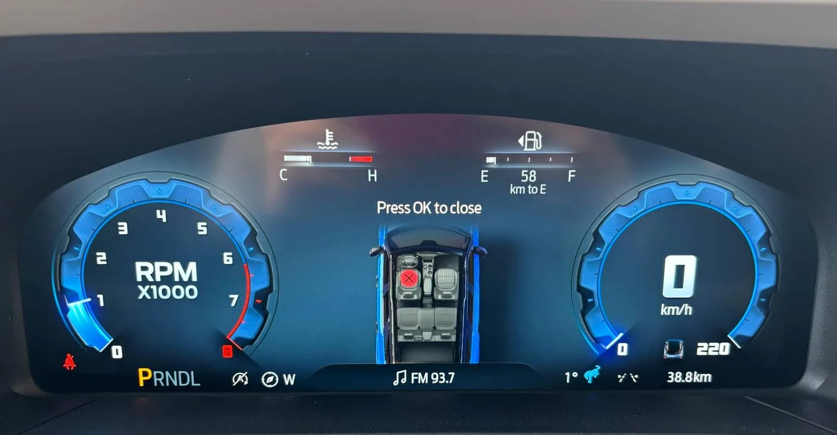

My Fuel Gauge has only registered 7/8's of a Tank for Months Now never goes to Full anymore. Monday the Pump kicked out Pumped another $1.60 in it still reads 7/8's of a Tank.
that's something I would take in and have fixed if your still under warranty, either your float is stuck or something is wrong with the conversion between there and the dash

Do you mean when filling up it stops at 7/8's or it stays at 7/8 and never moves down? Unless you happen to be using the same pump the whole time (unlikely) any reason you haven't taken it to the dealer yet. That would drive me crazy.
When i Fill Up it only shows 7/8's of a Tank the Gauge moves and was down to a 1/2 Tank on Monday and like i said i Pumped another $1.60 or $1.40 in it after the Pump Kicked out. Other times i Stopped Pumping as Soon as the Pump Kicked or before it kicked Out doesn't matter only shows 7/8's of a Tank. I need to take it in for some Recalls and i'll have them look at it then. Maybe the end of the Month when where I work is closed for a Week. I hate spending my Days off Waiting at the Dealership. I might look into the Mobile Service but not sure if they would look at the Fuel Gauge om a Mobile Service Call. FWIW it just started doing this in the Past 4 months or so.
