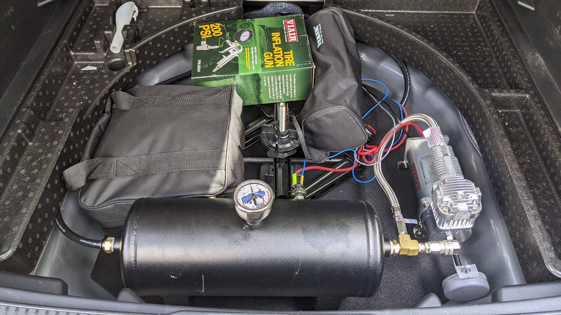

First, nice NBC shout-out. You can easily get small tire fillers that plug into BS. You can get a larger removable one, they make nice contained in box units I've seen. You can also go full install compressor and tank. I removed my spare tire and added compressor tank with hose attachment for air or pneumatic tools. Makes changing a tire a breeze. Just depends on what you feel you'll need and what that value you place on it's importance.

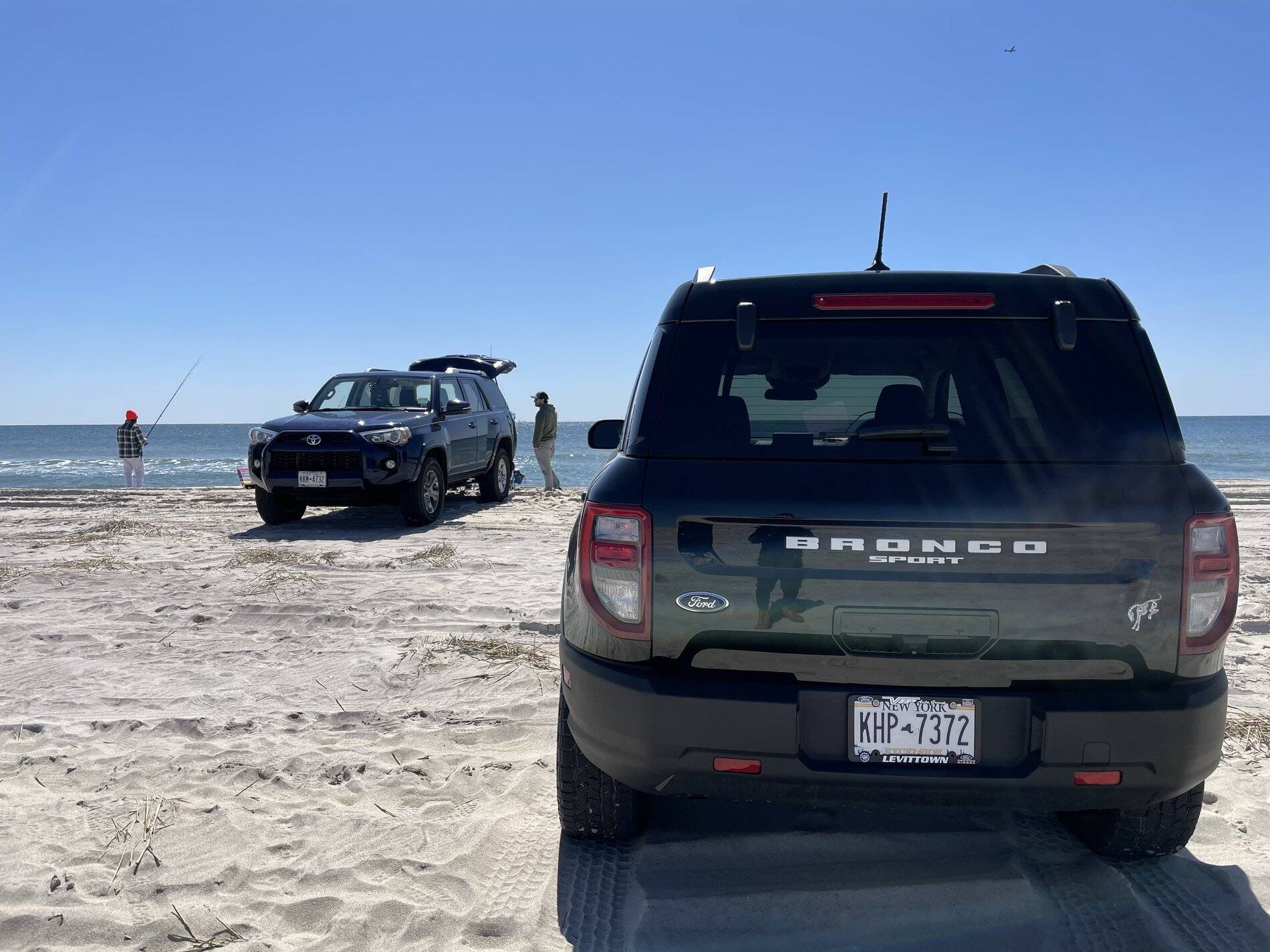

Took my Badlands onto the Long Island beaches yesterday for the first time (democrats point at Robert Moses). If you have the 4x4 fishing pass just make sure you have all the mandatory supplies, and a pair of recovery boards, one of my buddies got stuck this weekend and had to use these to get him out. i wasn't checked but have seen people get checked before for supplies. As far as compressors this is what I use:
https://www.amazon.com/Viair-00088-88P-Portable-Compressor/dp/B005ASY23I?pd_rd_w=mFLV3&pf_rd_p=4b669301-73fb-4bbc-9a24-97512428ca05&pf_rd_r=QYMEPJAMSC4PPACDK0MX&pd_rd_r=9e80c606-f5df-4bb7-9e68-f4a9c4254bfb&pd_rd_wg=12ulH&pd_rd_i=B005ASY23I&psc=1&ref_=pd_bap_d_rp_8_t
I aired down to about 18, threw the bronco in sand mode and cruised, no issues at all. Just keep an even pressure on the throttle, dont turn too quickly and keep your momentum up!
