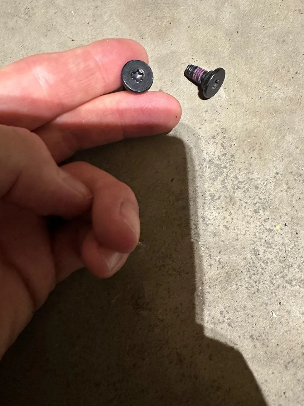

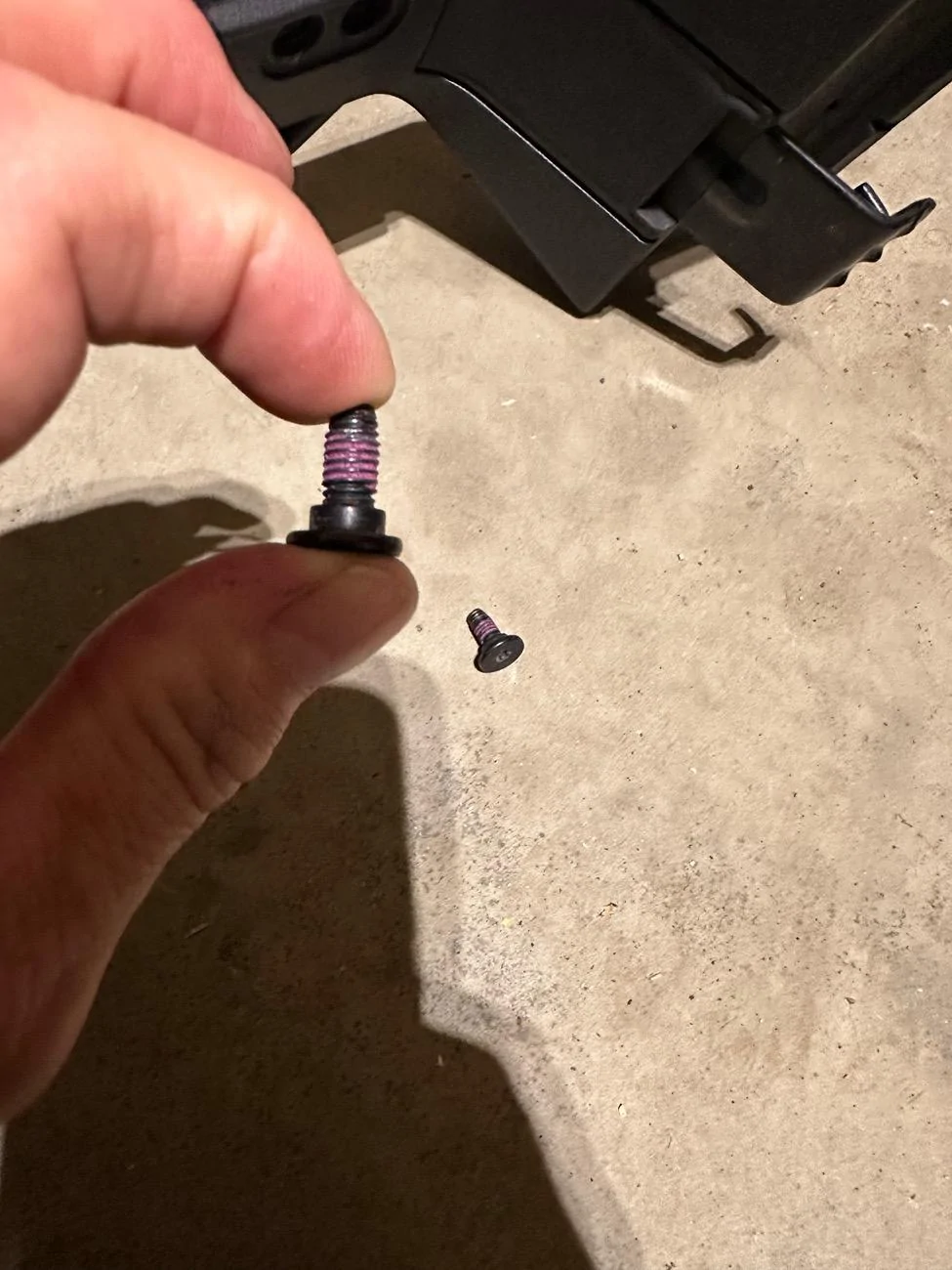

Omg i can’t get anywhere finding replacement bolts for the OE Crossbar kit - off road style. Anyone have any luck?

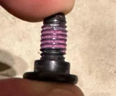

unsure whether your bolt is stripped or the crossbar threads are stripped
compare thread height near shoulder to the remainder of threads
thread channel on bolt appears filled with pulled material from crossbar
guessing crossbar threads are aluminum and bolt is steel
if anything is going to strip it will be the aluminum
if you would like to confirm the bolt integrity
run a correctly sized nut up and down the bolt as a thread confirmation
good luck to you OP

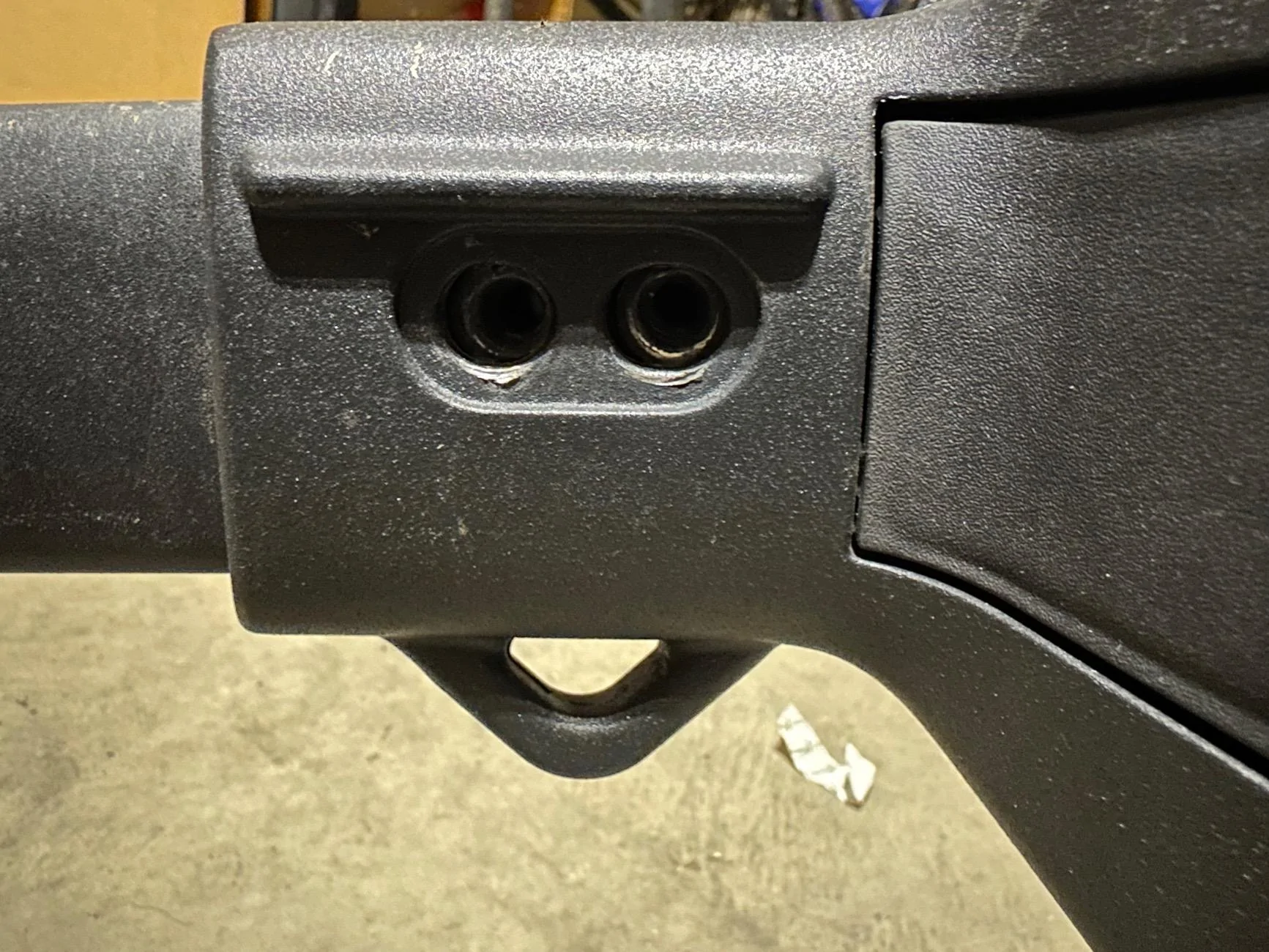

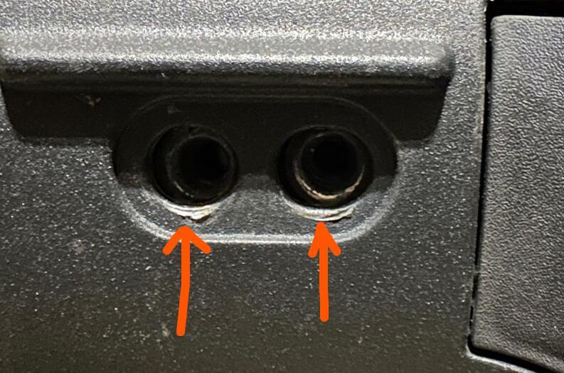

closer look also indicates possible misalignment occurred
shoulder of bolt is the actual seating component of bolt
the bolt head is just meant to secure the two pieces in place
shoulder may have incorrectly seated on wrong surface (see arrows)
deformation of metal occurred where shoulder may have had contact
if shoulder sat where intended the stripping would not have occurred
shoulder would have completed the stop where intended
bolt head would be in place just to lock in place NOT tighten

Excellent observation.
