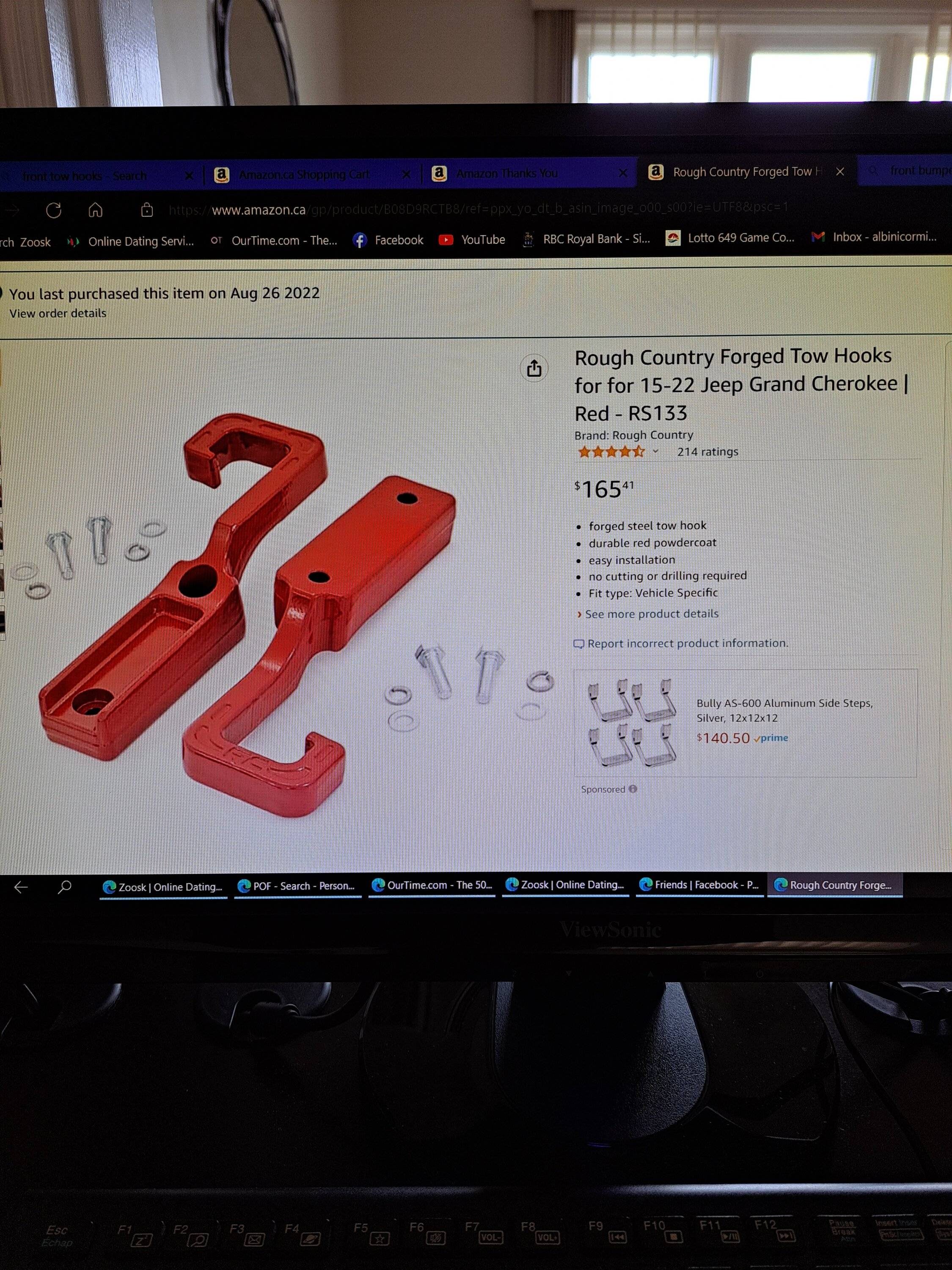

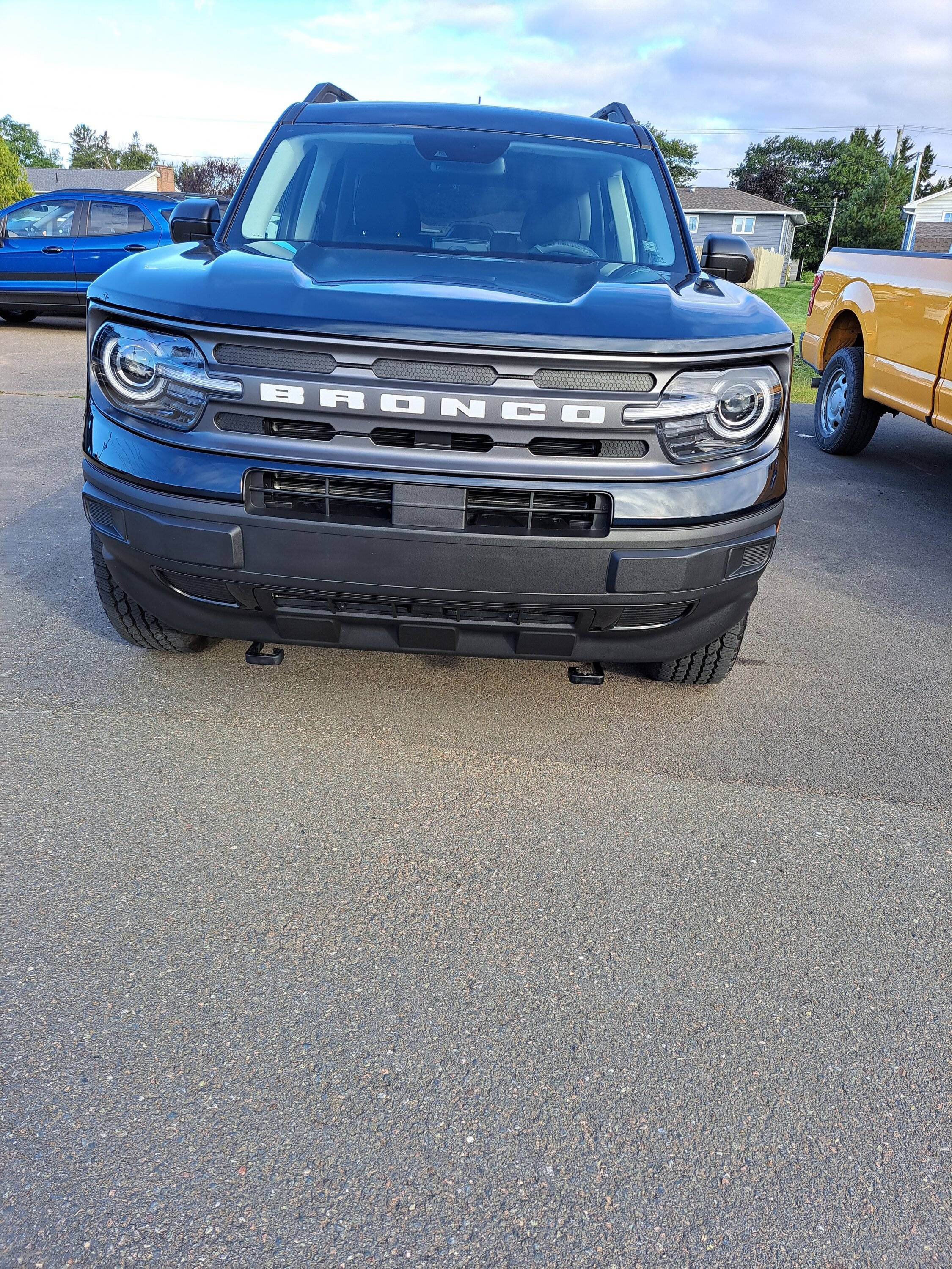

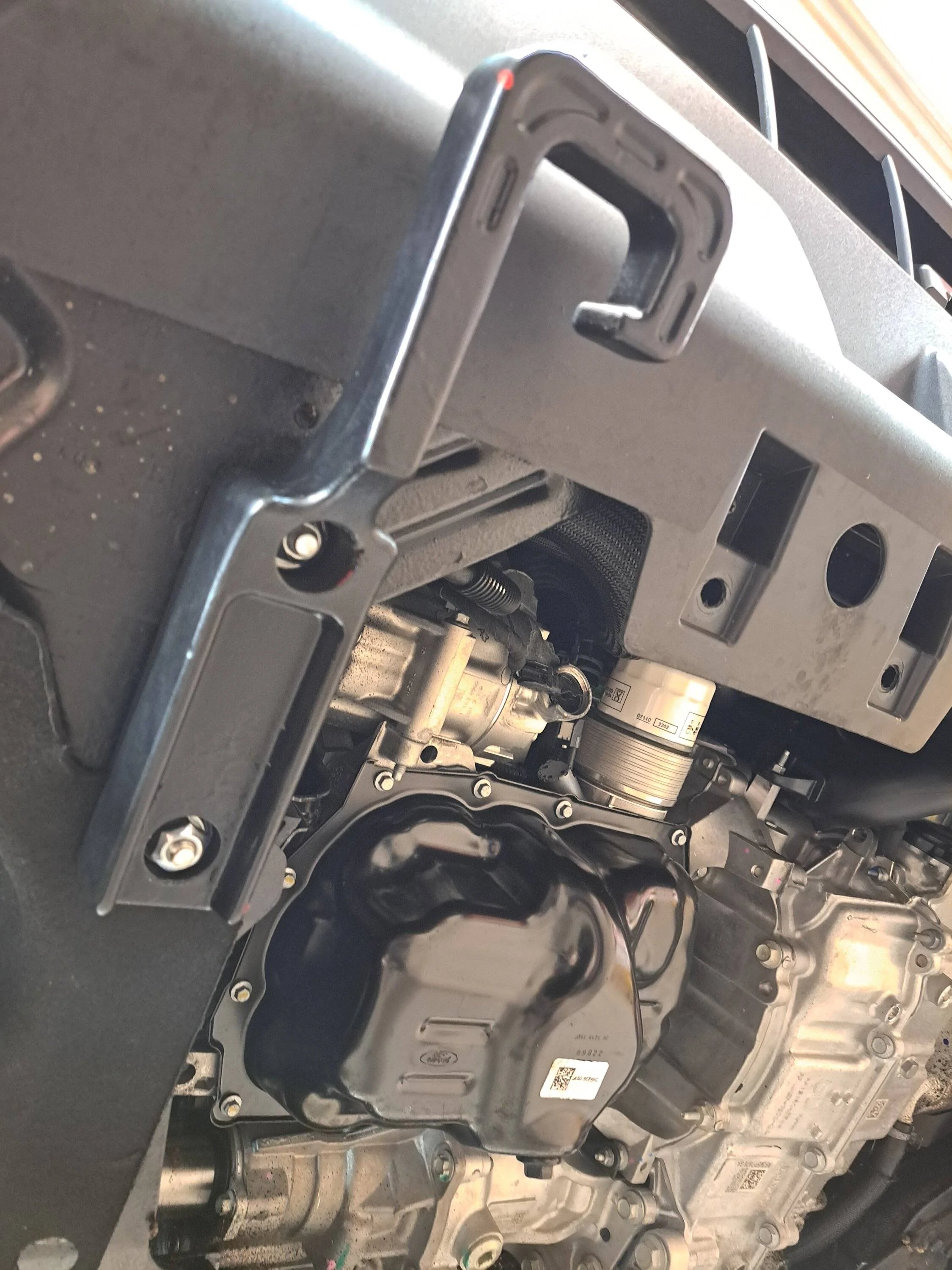

I installed these hooks on my Big Bend.
Ford Bronco Sport Nudge Bar over aftermarket tow hooks for BB 20220912_085940
Ford Bronco Sport Nudge Bar over aftermarket tow hooks for BB 20220916_084108
Ford Bronco Sport Nudge Bar over aftermarket tow hooks for BB 20220826_153748
