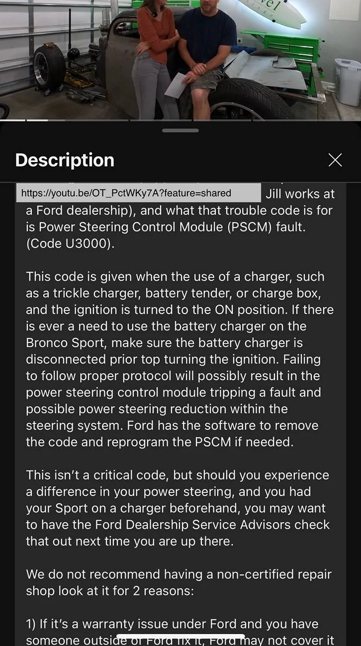

@Ksnau There is this YouTube video that documents use of a trickle charger .. “possibly results in the power steering control module tripping a fault and possible power steering reduction within the steering system”.. I don’t know if that power steering reduction could also occur due to a low battery or failing battery (I didn’t watch the entire video), anyway possibly there is an answer as to why your power steering improved after changing out the battery.
The link to the YouTube is:
