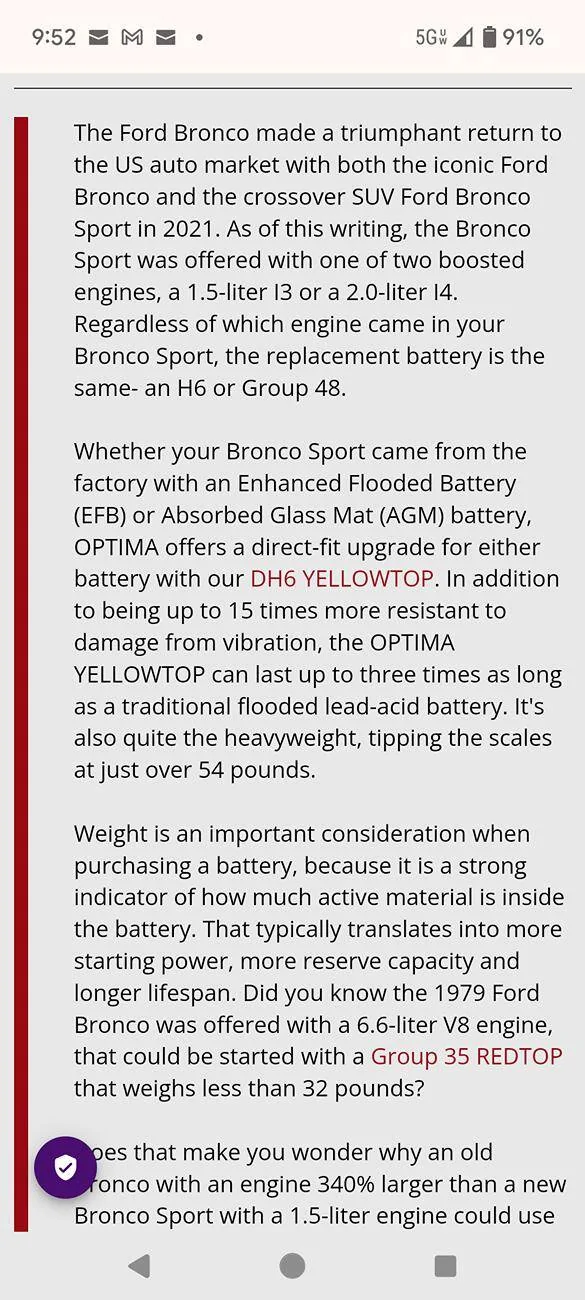

So luckily they do have one listed for a vehicle and it's the same no matter which trim. Of course they only offer the yellow top, not the red top. So it's going to be almost $400, but for me for this can't beat the peace of mind with as often as I'm out alone
Ford Bronco Sport No start with random warning lights Screenshot_20241227-095202

If you remember please post which battery you do get, its part # and cost, its warranty period and where you bought it from. Thanks!!

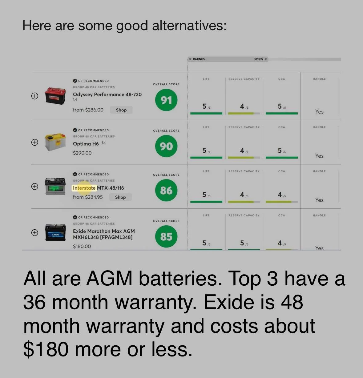

Ok. Also, this chart was in another post but you would need to verify any data on the chart that’s of interest to you
It’s just posted as FYI:
Ford Bronco Sport No start with random warning lights IMG_1786

Oh nice see I'll have to look through that. So I just went to AutoZone and had him do a battery test and it said it was at 95% state of charge and everything passed. So supposedly my battery is fine And I bought my car in March of 23 I tried to look at the sticker date on the battery but I couldn't see it without removing it, which I really don't want to do right now. But with all the camping trips that I've got coming up and the fact that it's my only car I'm thinking I'm probably just going to replace it. Just got to figure out what I'm going to replace it with
