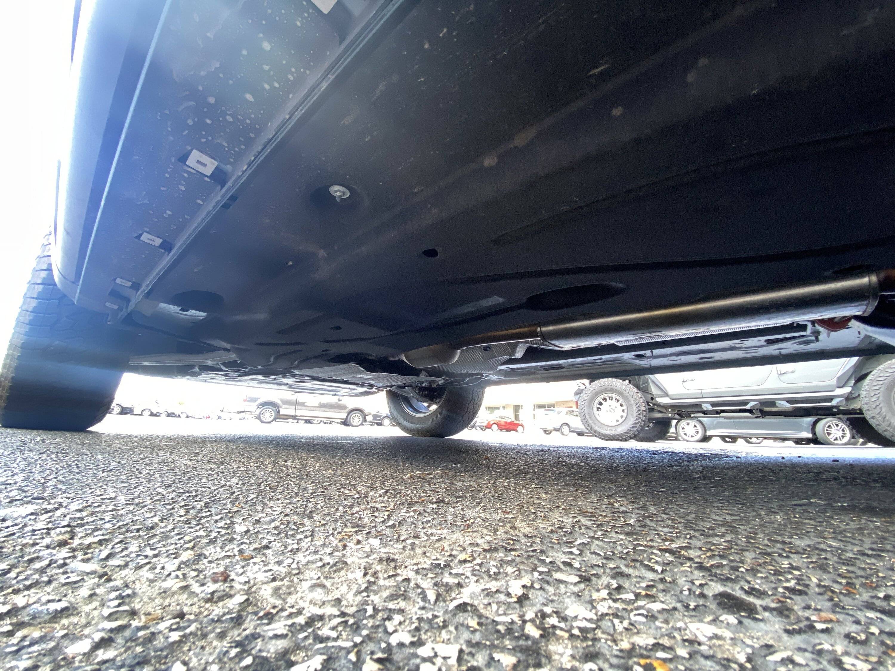

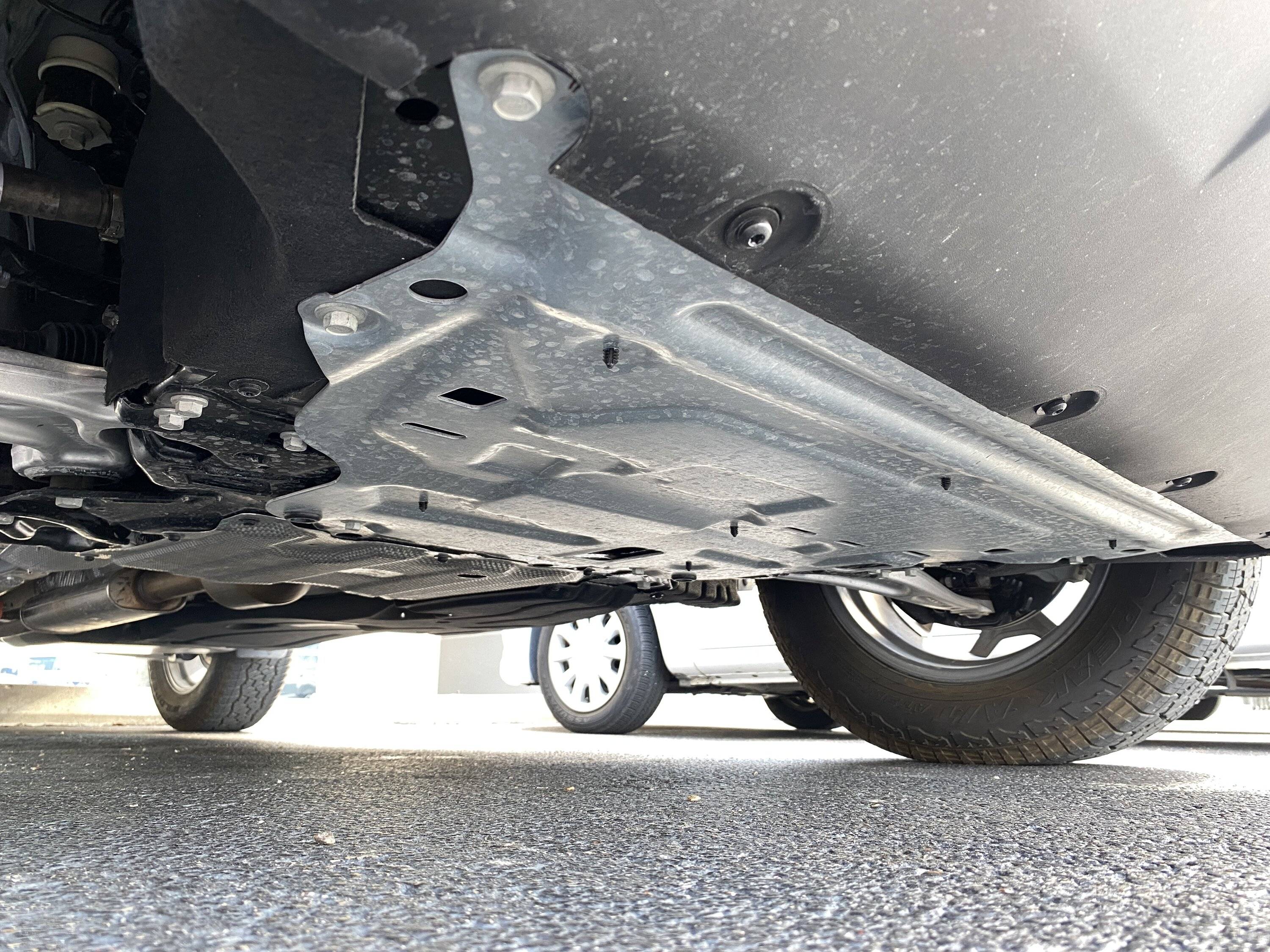

So far on our test Badlands we have only front thin metal front skid plate and all the rest are just plastic dust guards. Would love to make those sides off our deep stamped aluminum sheet ?
Ford Bronco Sport New RIVAL Aluminum Skid Plate For Bronco Sport IMG_3508.JPG
Ford Bronco Sport New RIVAL Aluminum Skid Plate For Bronco Sport IMG_3507.JPG
Ford Bronco Sport New RIVAL Aluminum Skid Plate For Bronco Sport SEMA Show 2021
109
4,381
5,079
A Badlands with plastic dust guards that seems very odd but then Badlands get built with whatever is on hand I guess.
My 2022 Badlands has the heavy 26lb skid plate under the engine, has a nearly useless felt cover underneath drivers side and behind that felt cover is a metal skid covering the “charcoal canister” and in the rear are (supposed to be) two Fuel tank skid plates, steel: 2.5 mm thick. I don’t think I have a felt cover underneath front passenger side but don’t remember (supposedly most Badlands do not have that felt cover under front passenger side).
