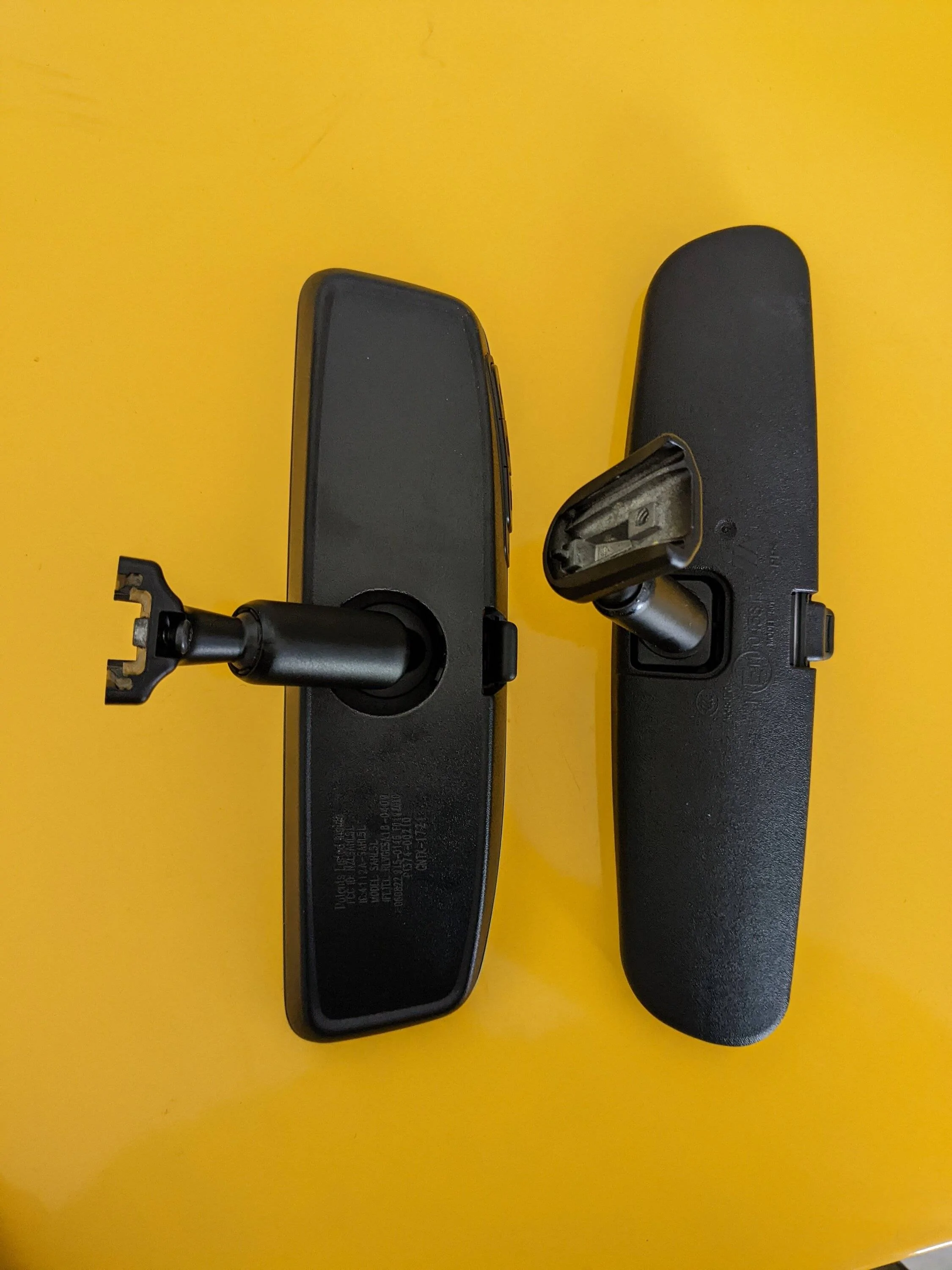

My Badlands with the poverty package doesn't have an auto dim mirror or HomeLink. I have 3 overheads that I deal with on a regular basis, so I really didn't want to have to carry around 3 transmitters.
Not the cheapest solution, but definitely the easiest (one screw). The RAV4 HomeLink mirror accessory upgrade is actually battery powered. Toyota Part PT374-00210. It's constantly powered, but that wasn't a big deal for me. To be honest, you wouldn't even the know the buttons are there if you didn't know to look for them.
The battery isn't replaceable, but whatever, it'll probably last 10 years or more.
It's a frameless design and is a slightly different shape (a little thicker). To be honest, I love the field of view change over the stock mirror. It was a pleasant side effect.

That sounds like a great solution - I had been looking into various options since I took possession of my FE in December 2020. In the end, I was able to find a 2022 Bronco Sport visor with built in homelink on eBay for $125 delivered. Also a one screw installation, it connected to the current plug for the lighted mirror with no issues and works great. The dealer wanted over $400 for the visor but if you are patient I’m sure more will become available on eBay and other used part sites.

Other than adding the garage door opener(s), what other benefits would this give me over the rear view mirror on my 22 Outer Banks? I'd love to get rid of the remote I have in the little console right now, but I can't justify $90 for that. Sell me on it lol
Not being snarky at all, I honestly don't know.

I love this post, and have the Toyota Mirror sitting right next to me, unfortunately, I think I have Ford Co-Pilot 360 Option on my Bronco Sport. The existin mirror is easy to unscrew, but I can't get it off without removing that and it it looks alot more problematic.
Right now, I went with some Sticky Velcro, and have put the Garage Controller on the inside pocket of the drivers car door, but I really hate that.
If anyone knows an easy way to get that mirror off I would appreciate the tips.
Ford Bronco Sport "Easy" HomeLink Upgrade --  RAV4 HomeLink mirror accessory Bronco Sport Mirror 1-7-23
3,341
4,741
You just need to pop the plastic cover off the part surrounding the mirror. The mirror is held on by one screw, loosen it before removing the cover. Start from the rear of the cover on the sides as the front has two small molded in tabs that go from the front towards the back.
