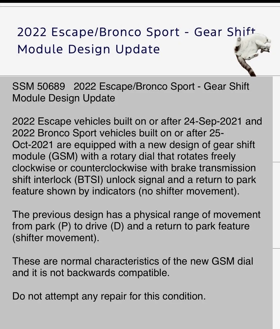

Hello everyone! Some owners have reported that the gear selector rotates when the automatic shift is in Park. But mine stays put and the P light just lights up. Is this a malfunction or just a different type of gear selector?
113
4,492
5,325
That’s correct but what year is your vehicle
Behavior has changed over the model years
