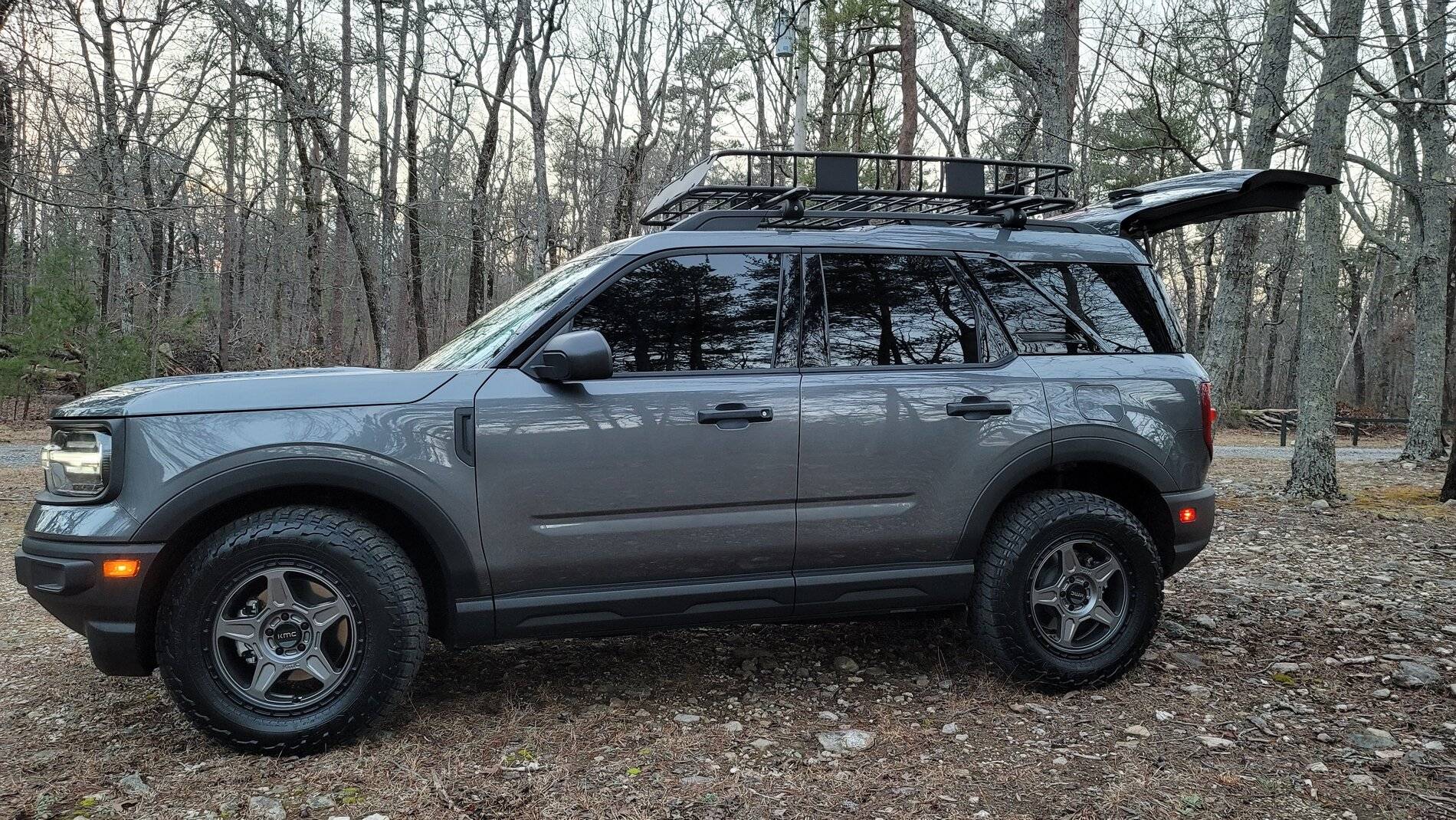

Here is my 21 Bronco Sport. 245/65/17 Falken Wildpeak ATW3s. 17" KMC KM721s. No lift. No scrubbing at all. This is definitely the best tire size on stock height. Wheel offset is key though. We tried to put these tires on -12 offset and 0 offset wheels and no luck. Factory wheels or +35 (or higher) aftermarket wheels allow for this size tire.

The falken wild peaks atw3’s are a solid choice! I had them on my ‘03 Ford Escape and I loved them! I went with general grabbers personally on my build because they were readily available, but once these need replacing I’ll probably go back to falken!

So those are +38 off-set, right?
Now that you have put some miles on them how do you like them, any "excessive" noise or vibration during commutes?

Yes these are +38. I have not noticed any excessive road noise and zero vibration.

...and, this is on a Base model, already 1" shorter than the BL or FE; but also, the Base has less wheel travel/articulation than the BL. This tire (and wheel) handles all kinds of terrain, angles, etc. with no rubbing at all for you then? That is good news, with this 29.5" tire. Makes me wonder if the 245/70-R17 tire (30.5") would really fit a Badlands on stock wheels and no other modifications or not?

Question for you, do the Falken’s get worse Meg’s than the stock ones? I am considering switching out the Pirelli scorpions for the Falkens Bc of the more aggressive look.

Honestly not sure about worse MPGs. My guess would be it is slightly worse but not really noticeable.
