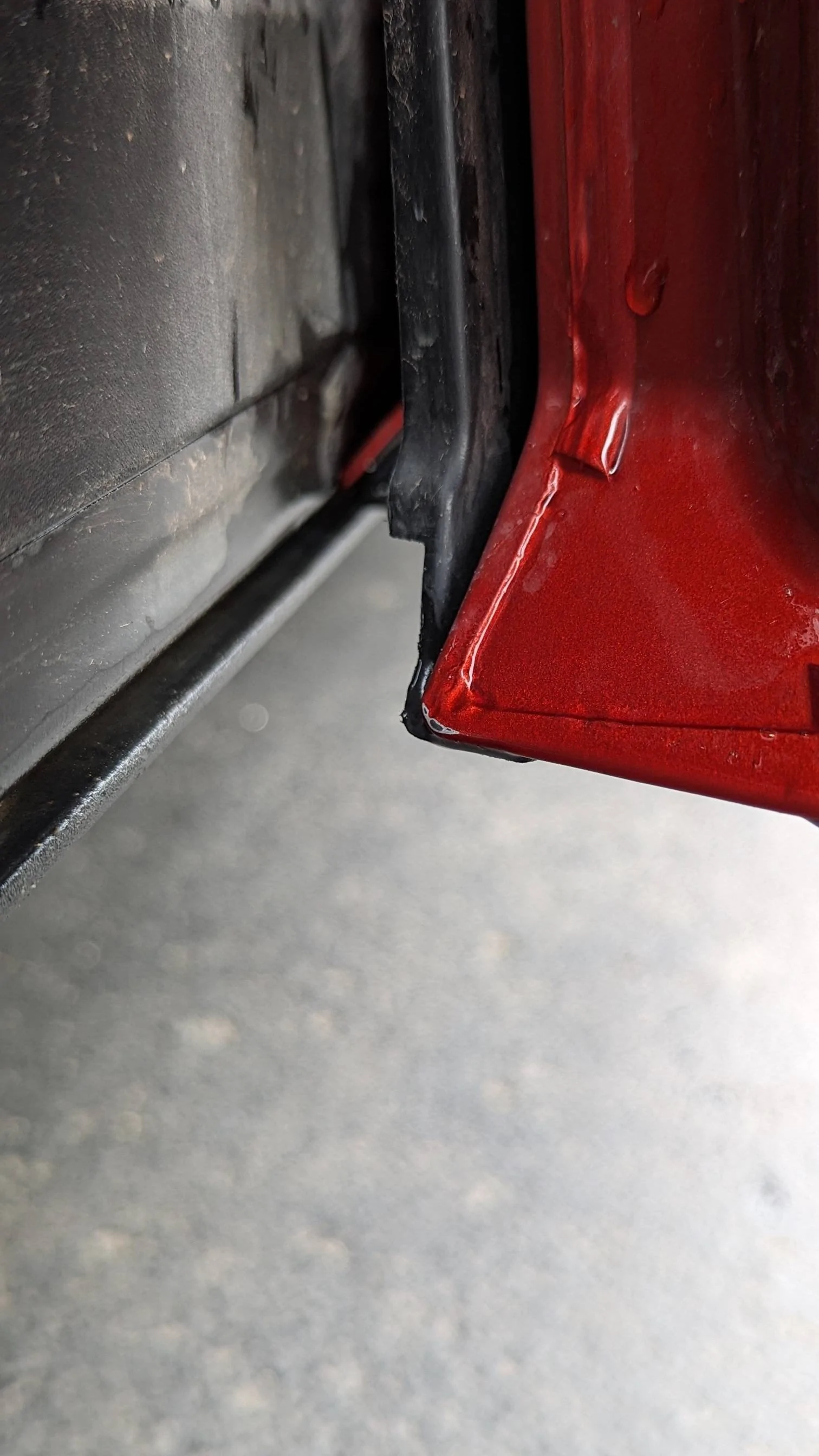

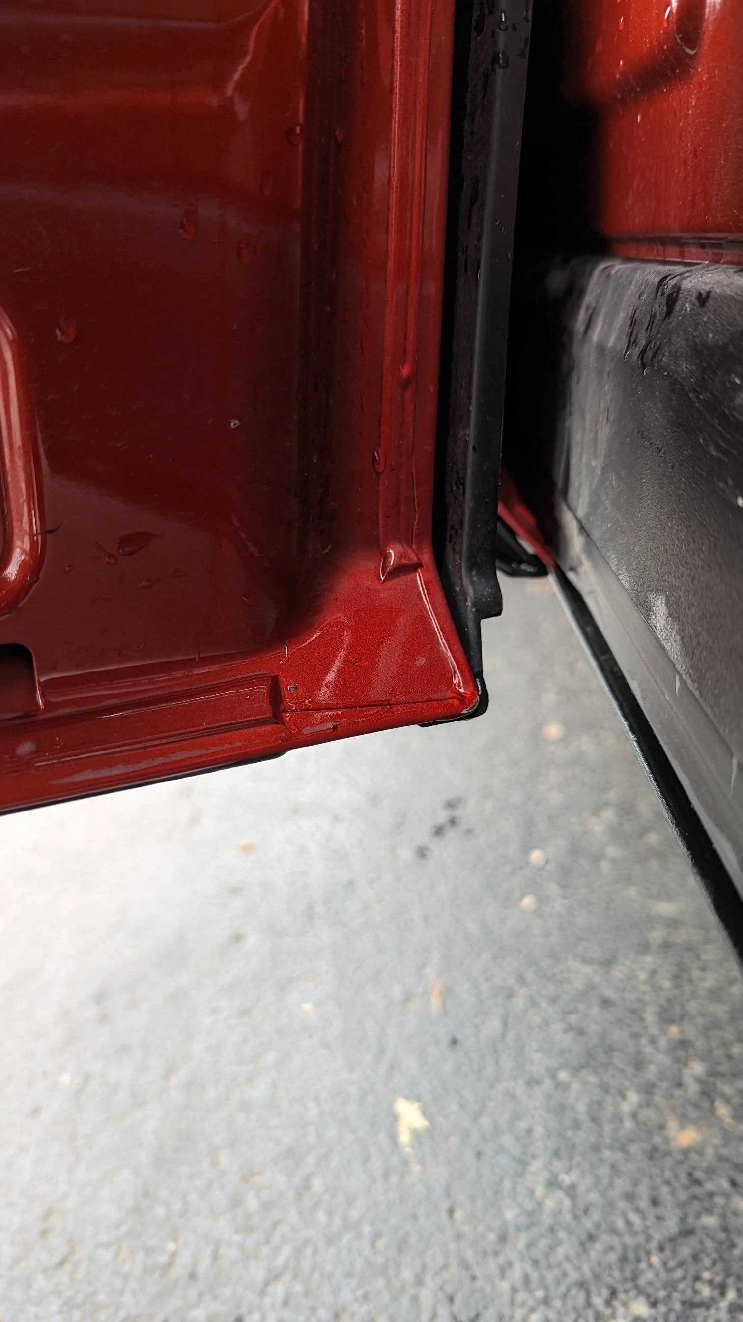

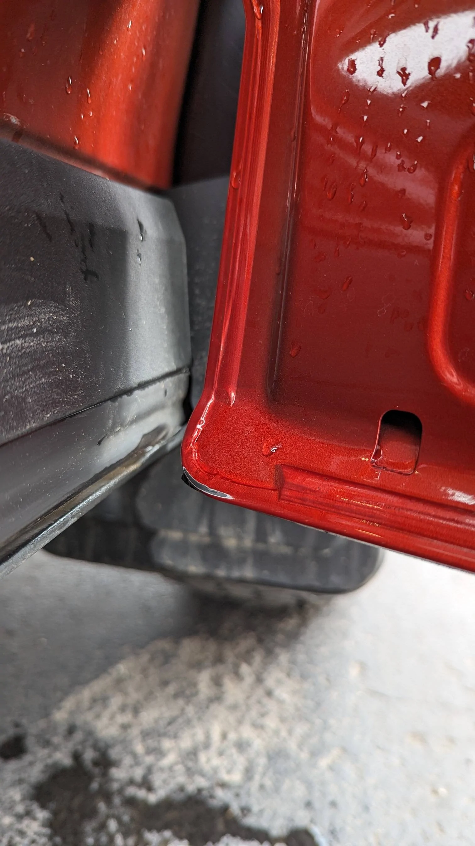

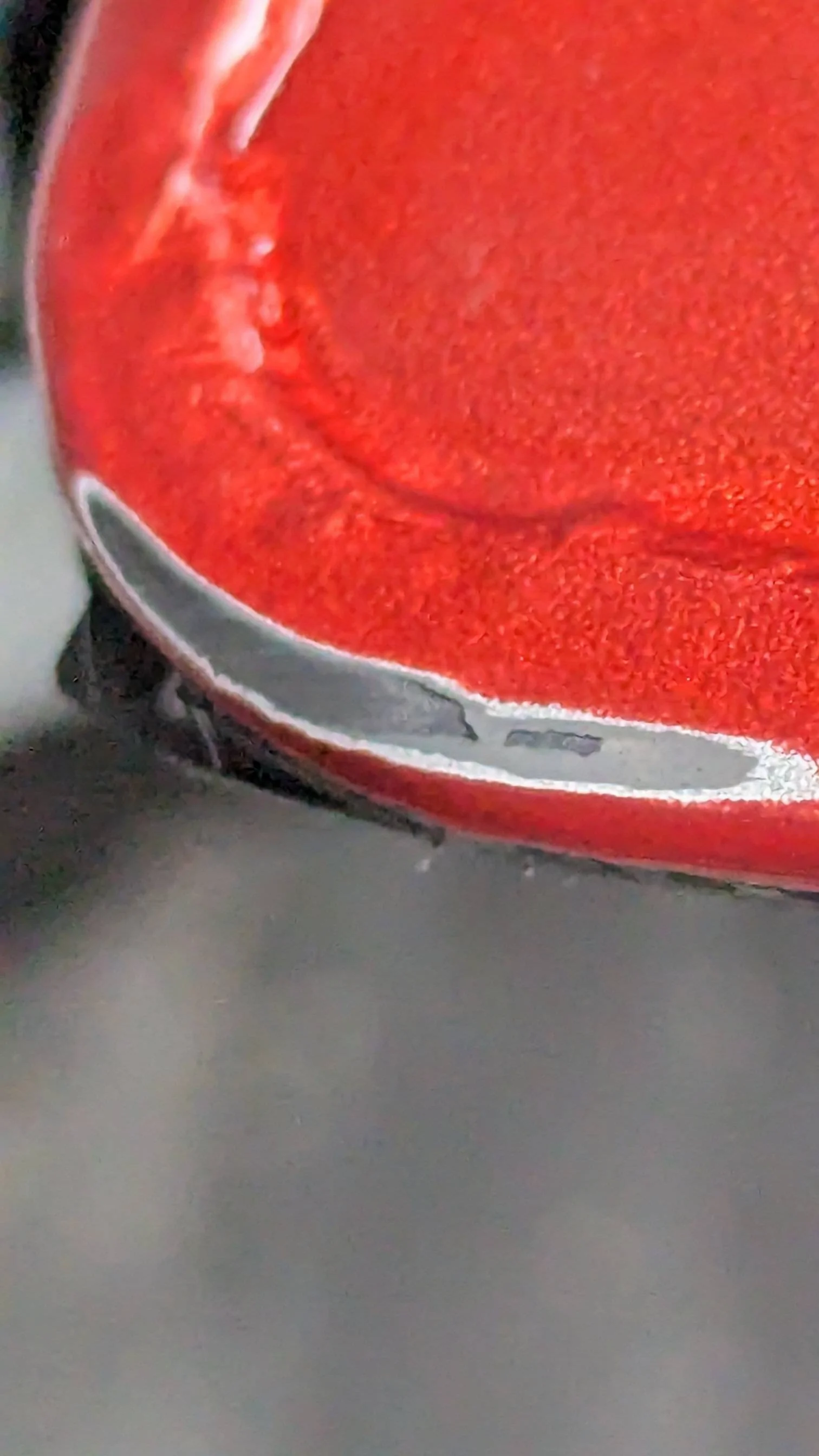

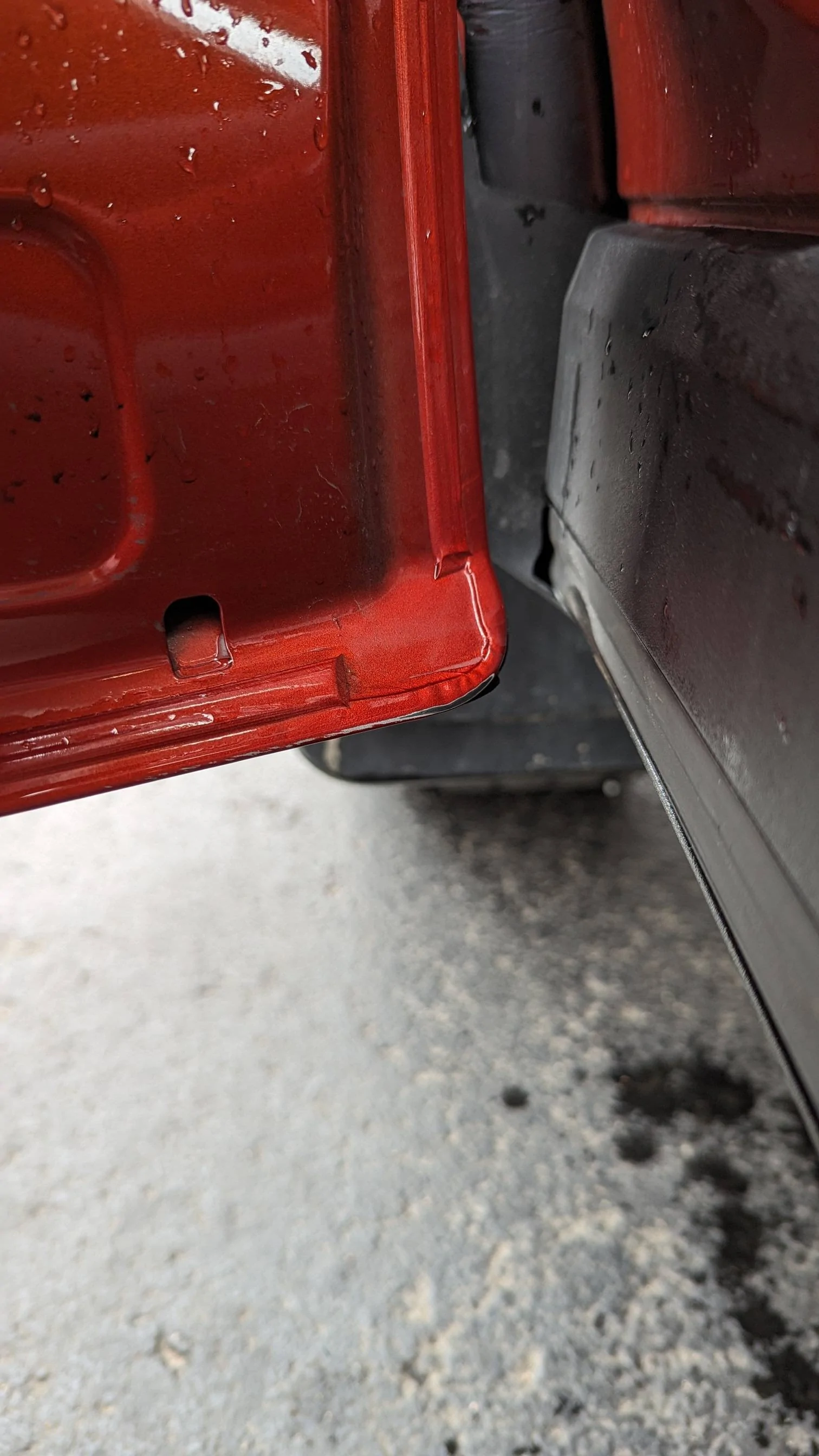

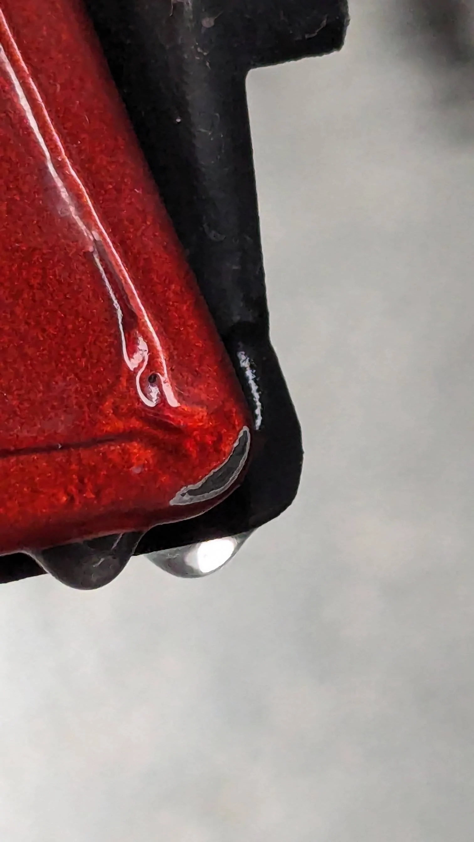

I took my bs into my local dealer today with multiple issues. First issue: battery hold down hardware severely corroded. Second: Rear brake groan when backing up-- Ford known issue. Third: paint wearing and worn down to bare metal on all four door corners. I read a post on this forum about the same issue. It appears the doors fit too tight to the rocker panel rubber seal. The service writer said that they will have to send the vehicle out to be painted, and when I asked about how they are going to stop the wear, she said that they will have to adjust the doors. I wonder how many more bs have this type of door fit issues? See attached pictures of the worn paint...

I'm going to check my doors tonight to see if I have this happening.

I checked on my 2021 Badlands with 23k and don't seem to have this issue.

aside from the rare rear brake groan while reversing, I have none of these issues. 24K trouble free miles on my 22 Badlands.
its a shame you are dealing with that. I’d be pissed
