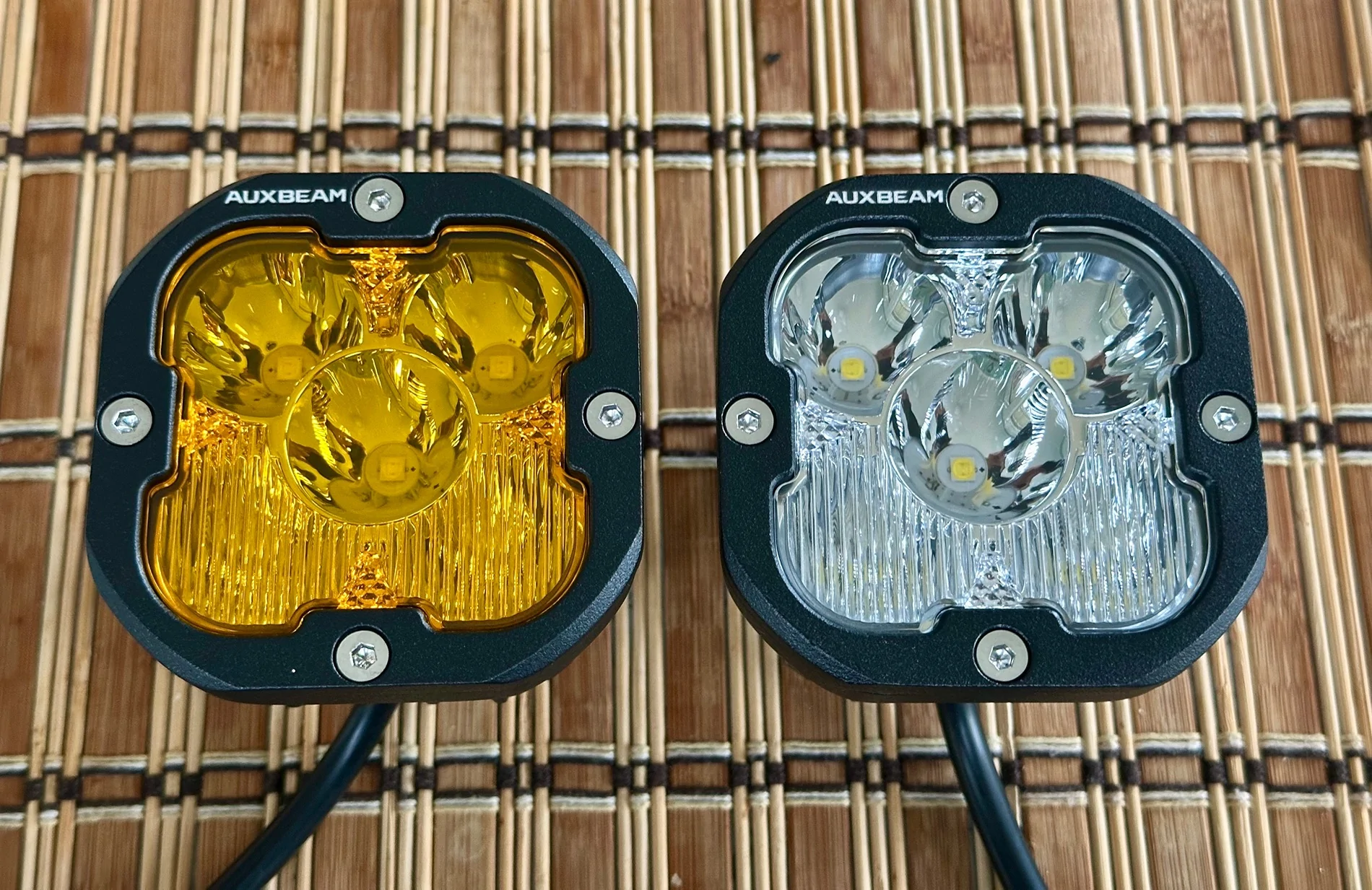

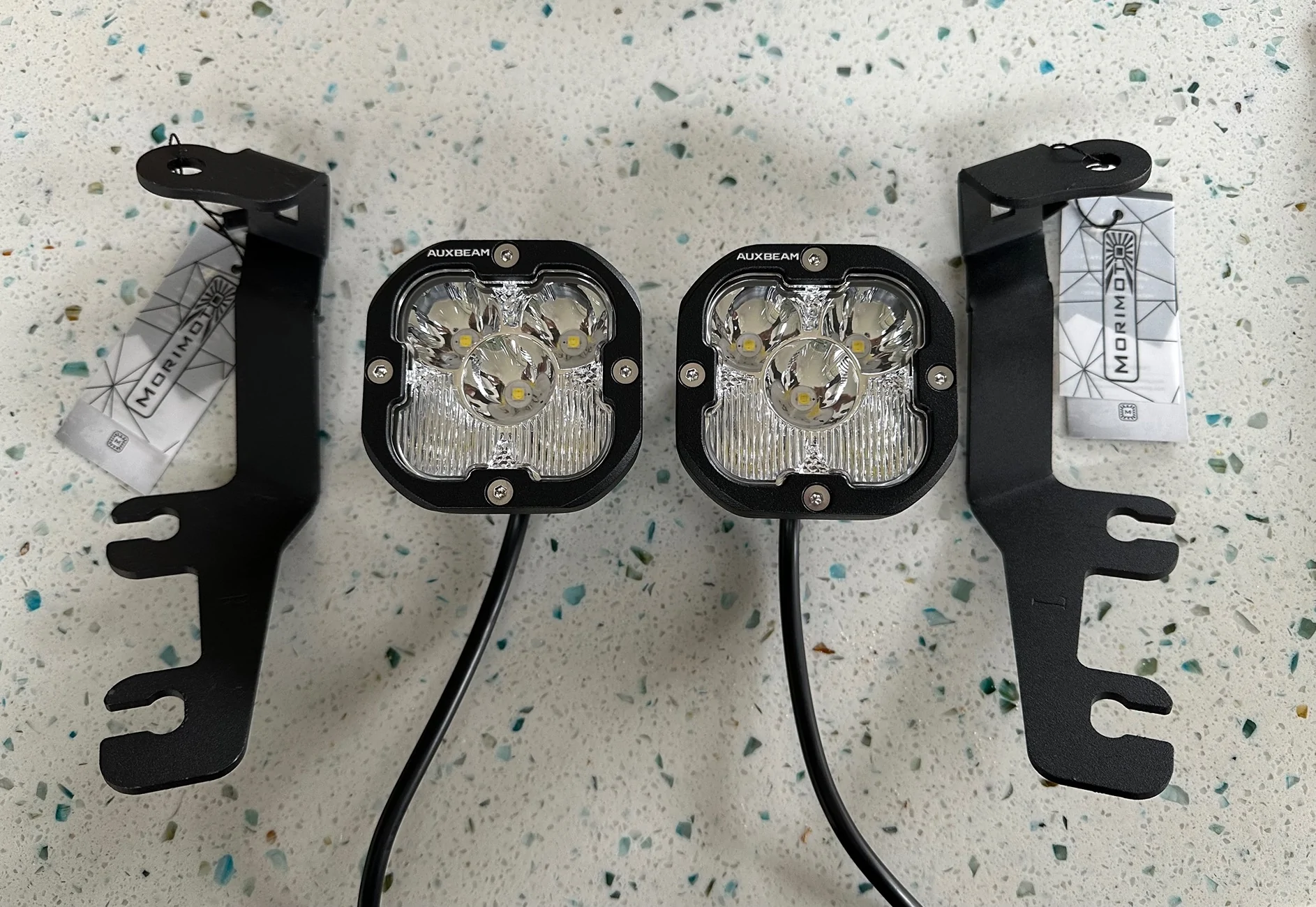

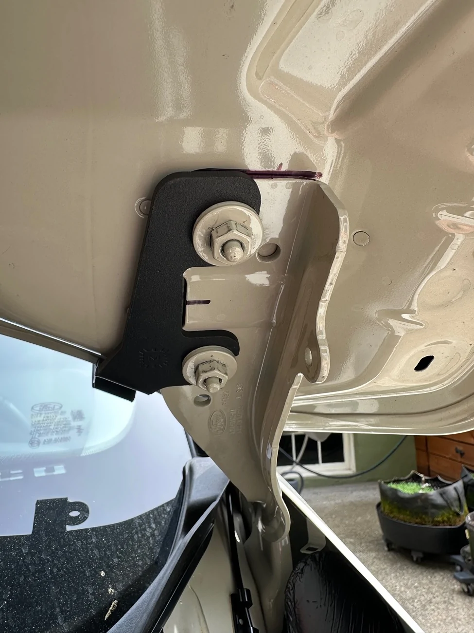

I’m installing Morimoto Ditch Light Brackets today along with some Auxbeam led lights. I went with the Morimoto brackets because I like the way they go between the hood hinge and hood bolts with a slotted mounting hole one bolt at a time. I’m hoping to not have to fiddle with hood realignment after the installation. We will see in practice. They also have a built in clip to tidy up the wiring.

FYI!!!
Do not overtighten the nuts when reattaching them to the hood. They WILL break the bolt. Don’t ask me how I know. They need like 12lb-ft of torque.
And that is ALL. It is not an easy fix if you break them.
Oh man thanks for the heads up. I can see how easy that would be to do.

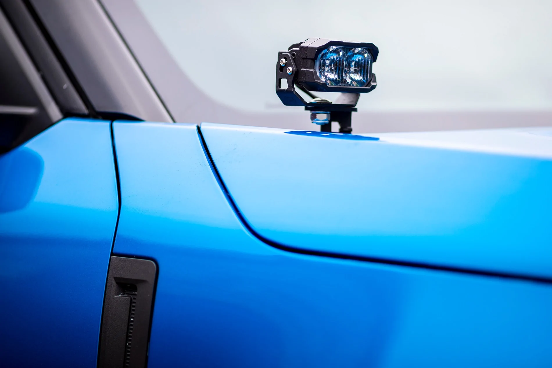

POST INSTALL UPDATE

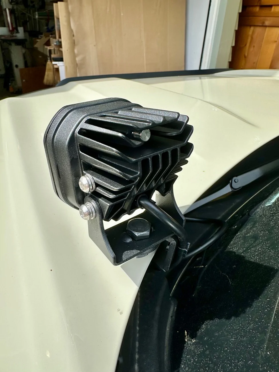

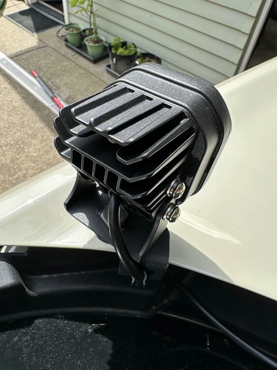

The brackets and lights were easy peasy to install. There was some movement in the hood with the hinge bolts loosened up so I’m glad I traced around them with a sharpie before loosening. I think the slotted holes in the Morimoto brackets definitely made it easier. Thanks again Frenchy for the tip on the bolt torque. I totally would have over torqued them.
Ford Bronco Sport Morimoto Ditch Light Bracket Install using OEM Aux switches IMG_2806
Ford Bronco Sport Morimoto Ditch Light Bracket Install using OEM Aux switches IMG_2809

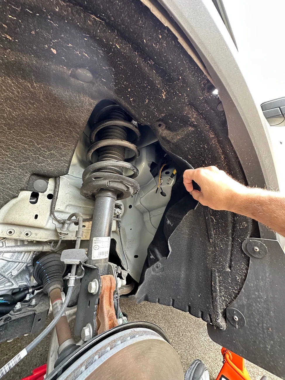

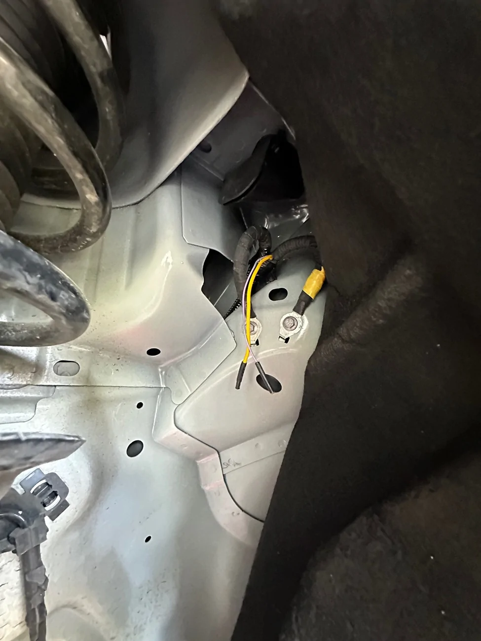

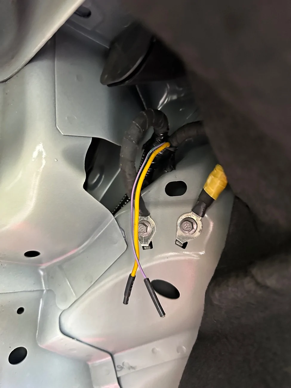

What was total pain in the ass was accessing and splicing into the aux switch wires. They’re under the drivers side wheel liner so you need to remove the wheel and partially remove the liner. Trying to get in there to splice a longer wire to these 4 inch long wires was ridiculous. Why the hell they chose to put them here is baffling.
Ford Bronco Sport Morimoto Ditch Light Bracket Install using OEM Aux switches IMG_2815
Ford Bronco Sport Morimoto Ditch Light Bracket Install using OEM Aux switches IMG_2816
Ford Bronco Sport Morimoto Ditch Light Bracket Install using OEM Aux switches IMG_2817
Done except for aiming now. I’m still cursing Ford for that Aux wire location 😡

A short video of where to find two of the four Aux switch wires. Yellow is the 30 amp AUX 1 circuit on, purple & green is the 10 amp AUX 3 circuit. They’re wound up with electrical tape which was a bugger to cut through up in there. I still don’t understand why but it’s where they are 🤔

Aux switch wires. I still don’t get it but it’s where they are. Yellow is the 30 amp circuit on the AUX 1 switch, purple and green is the AUX 3 switch and a 10 amp circuit.
