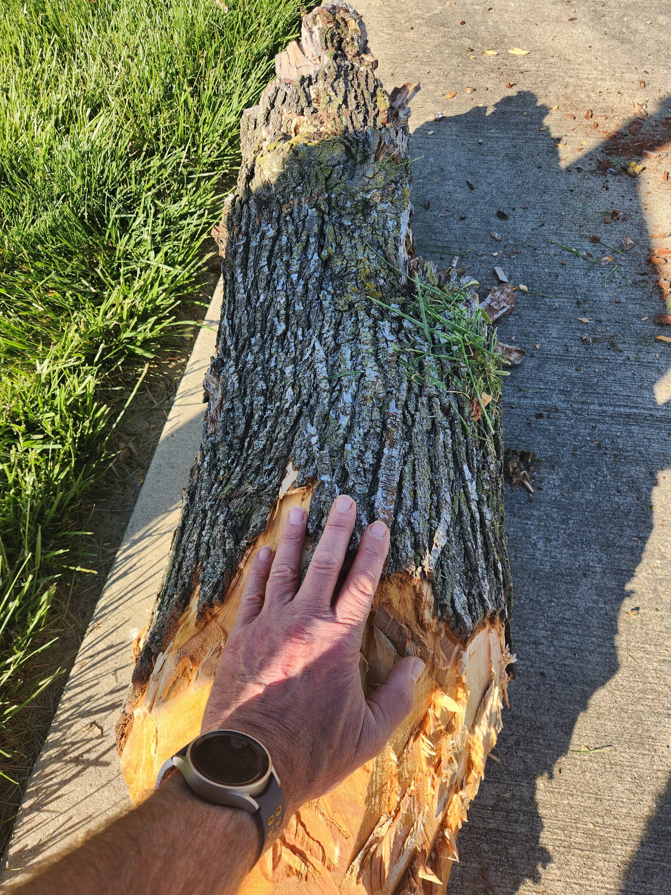

I see you hacked down at the base of the stump prior to the pull. Now I need for another owner (not me!) to see what size in diameter and wood type the limit is for our BS's to be able to break off.

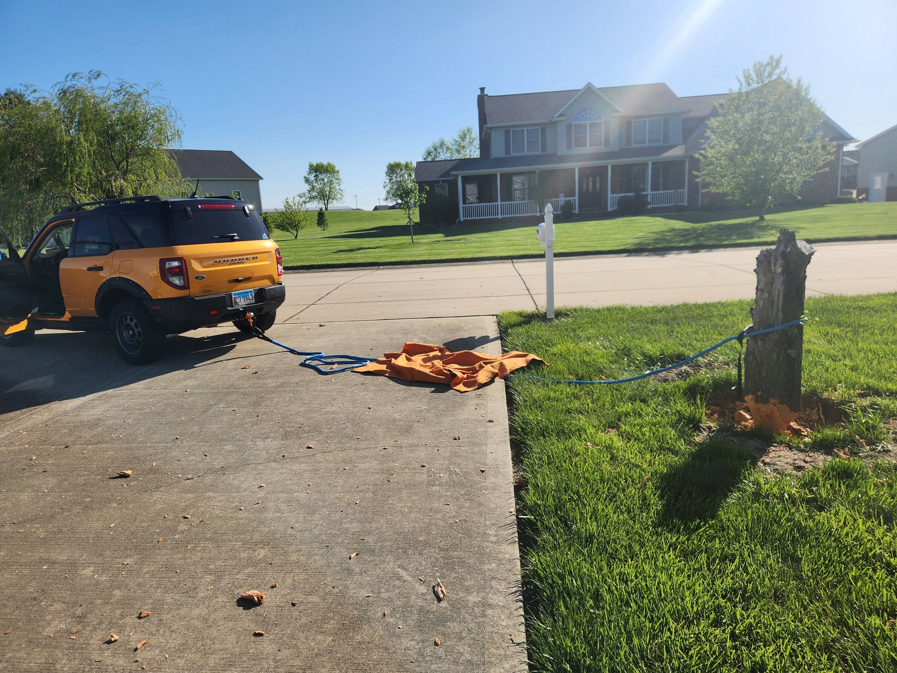

Here's the scenario:
A windstorm blew over a pear tree in my front yard. The wife and I chopped all the branches off, cut the larger pieces into firewood, and donated it to a neighbor with a fireplace. That left the ugly remnants of the stump sticking out of the lawn. I could either hire someone to come and take out the stump for me (average cost ~$350), or do it myself. I hate paying other people to do things I think I can do myself, so I chopped a nice groove all the way around the stump below ground level and then it was time to press the Badlands into service.
Ford Bronco Sport More Utility, Less Sport 20230429_170642
So, what do you think happened (click below to see)?
  1. The stump lost.
  2. The Badlands lost.
  3. Mark pulled the tow hitch off his Badlands.
  4. I don't care, pulling stumps is stupid.

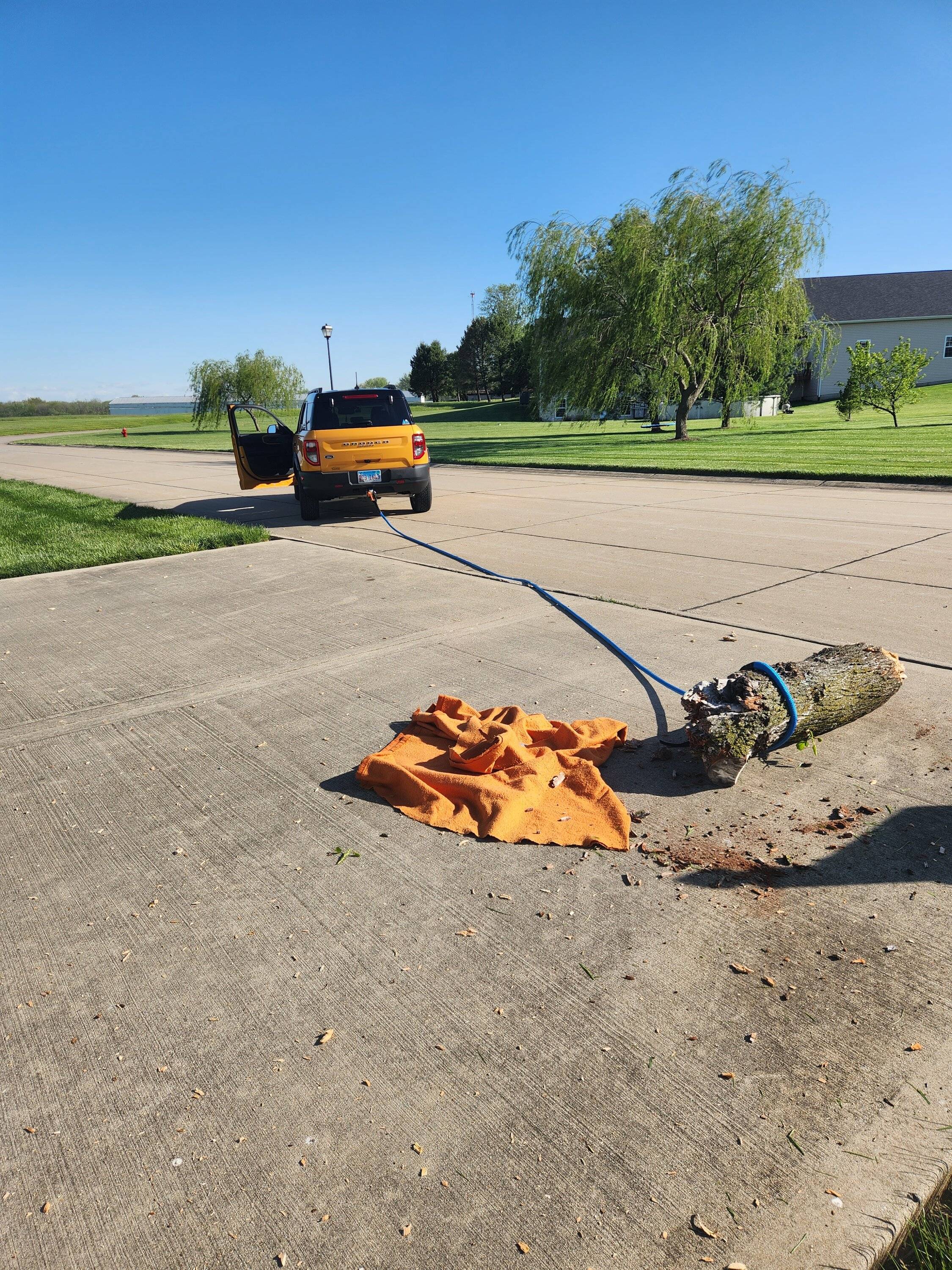

The stump lost!

In case you were wondering, this was a pretty substantial stump.

I used a kinetic rope looped around the stump on one end and attached to a shackle hitch at the other using a soft shackle. Everything held together perfectly. I first slowly pulled the rope taut, then applied power to see if I could just pull it over. I heard the power transfer unit clutches engage as the front wheels started to spin, but there just wasn't enough power/traction there to simply pull it over.
Next, I backed up and took a running start. If you're not familiar, a kinetic rope is made for this kind of operation. It stretches a bit so you can use momentum to apply multiples of your vehicle's weight to the tug. I started out slow—perhaps 3 mph—and increased my speed progressively over a few attempts. The stump gave when I hit the end of the rope at around 7 mph.

BTW, the blanket over the rope is a safety measure. It acts as a damper to prevent the rope becoming a projectile should it snap.
You got lucky. Safer alternative.... Chainsaw.

I wanted to remove the stump to below ground level, and you can't get a chainsaw below ground level without digging a pit all the way around the stump, which means cutting out the roots. Way too much work. I'm not sure what you mean by "got lucky." I never planned on going fast enough for the log to rebound all the way to my car.

Got lucky referred to your trailer hitch remaining attached to the car.??
