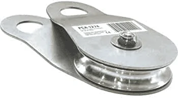

In all seriousness, generally speaking, what you can do (with adequate space and something to tie off to) is use a 'snatch block' -- so you aren't pulling the tree toward the BS -- notch the tree, and use the BS to pull it down, rather than risking the tree falling in the wrong direction.
There are many snatch block designs, we use some similar to this:
Ford Bronco Sport More Utility, Less Sport 1682897777815
Of course, the higher the rope is in the tree the better. That's the most difficult part.
