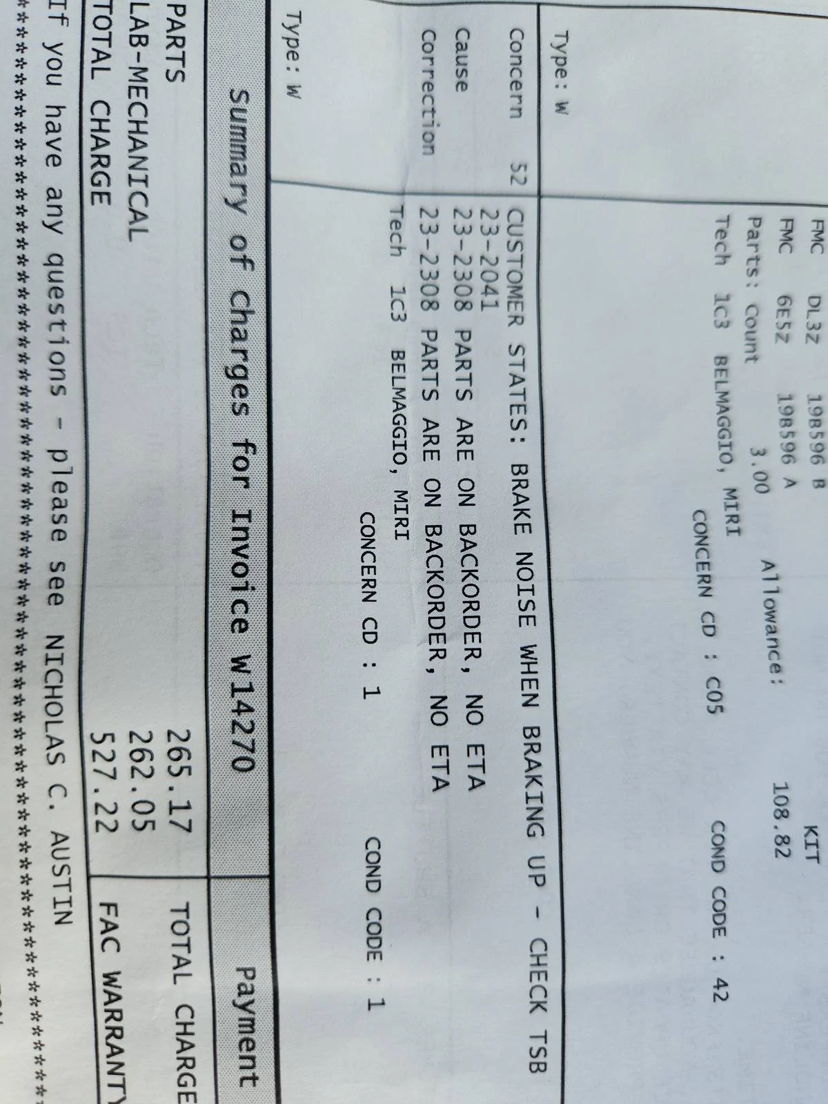

I have the same issue. I took my truck to koons Ford on security blvd. They said it was a recall. Had my truck for 4 days until they called me to let me know that they were waiting for a part. Ok finally after a month the "part" came in. They called me after they "fixed" the recall. Well, I parked the truck at home for approx. 4 hours. When I backed up OMG the noise was still there. I called Koons and my service rep was supposed to have called me back. That was 1 month ago. I am just going to drop it off again. SMH I know this did not help you, yet I want you to know know that you are not alone in this noise matter.
Good morning. Would you please send over a private message with your VIN and dealer info so I can look into this noise concern on my end?

Yes, so i picked it up and the noise is still there. I am trying to reach Nick my adviser lol its been a month. I am just going to go there
