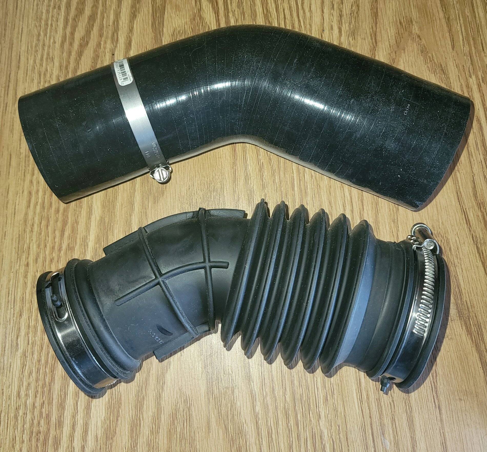

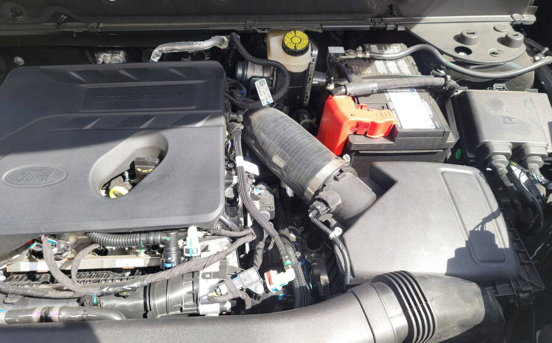

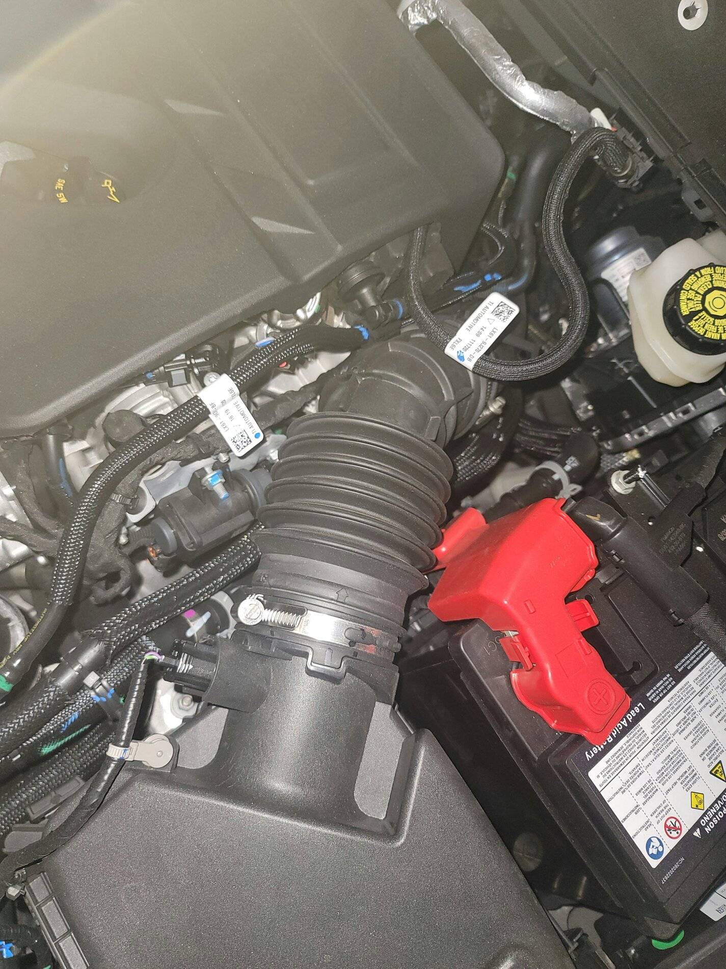

Ok so, the OEM Intake hose is built to absorb the almost constant movement of the engine that's held in place by flexible rubber motor mounts and connected at the other end to the Ridgid chassis mounted air breather box.......
A six pack of cheap beer says the breather box will crack and let unfiltered air into the intake. Severely shortening the turbo, piston rings and cylinder wall life...
Ok what am I missing here ?
Is there actually enough flex In that after market smooth hose ??
If there Is why didn't Ford R&D spec it ? It has to be cheaper to make ???

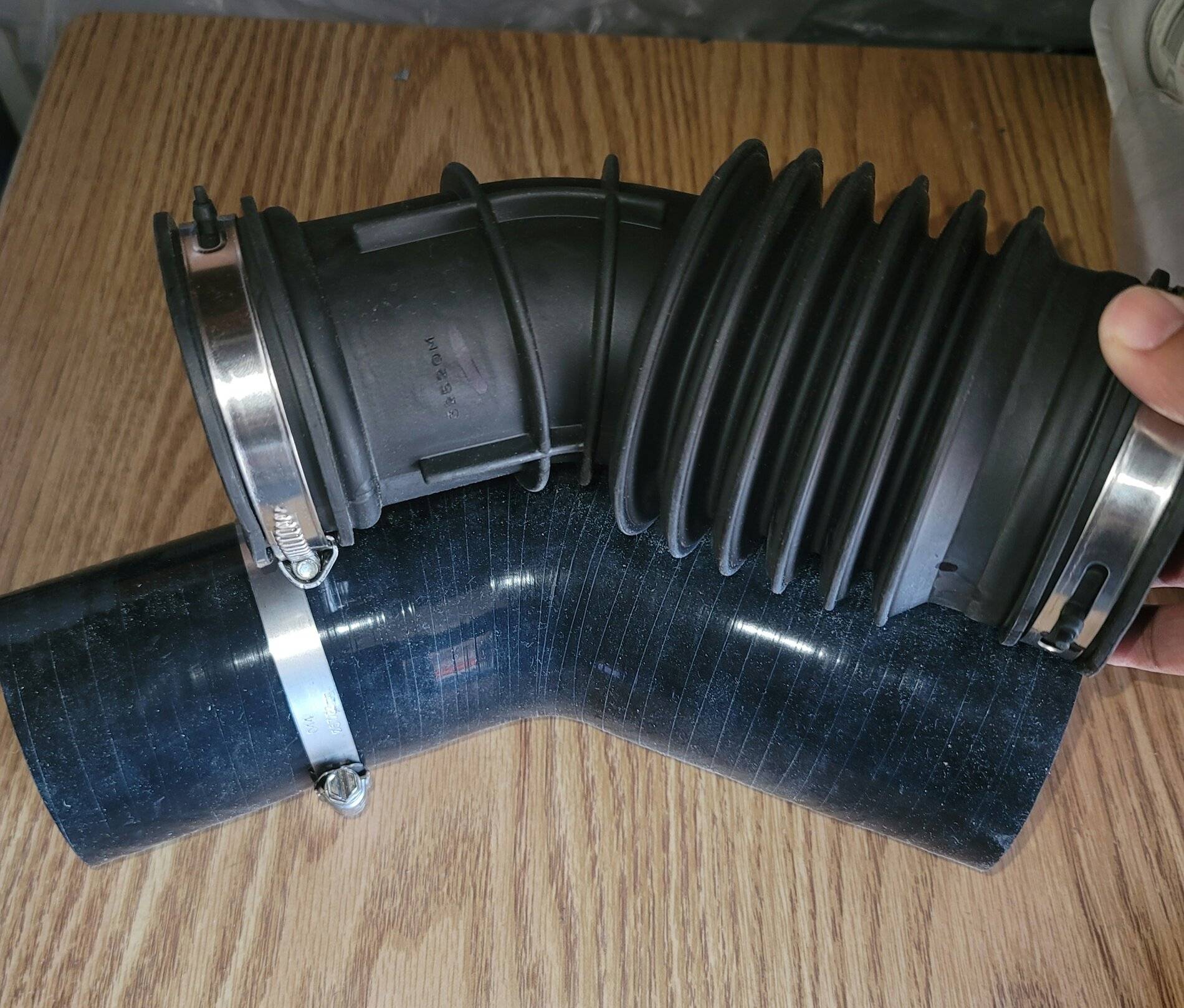

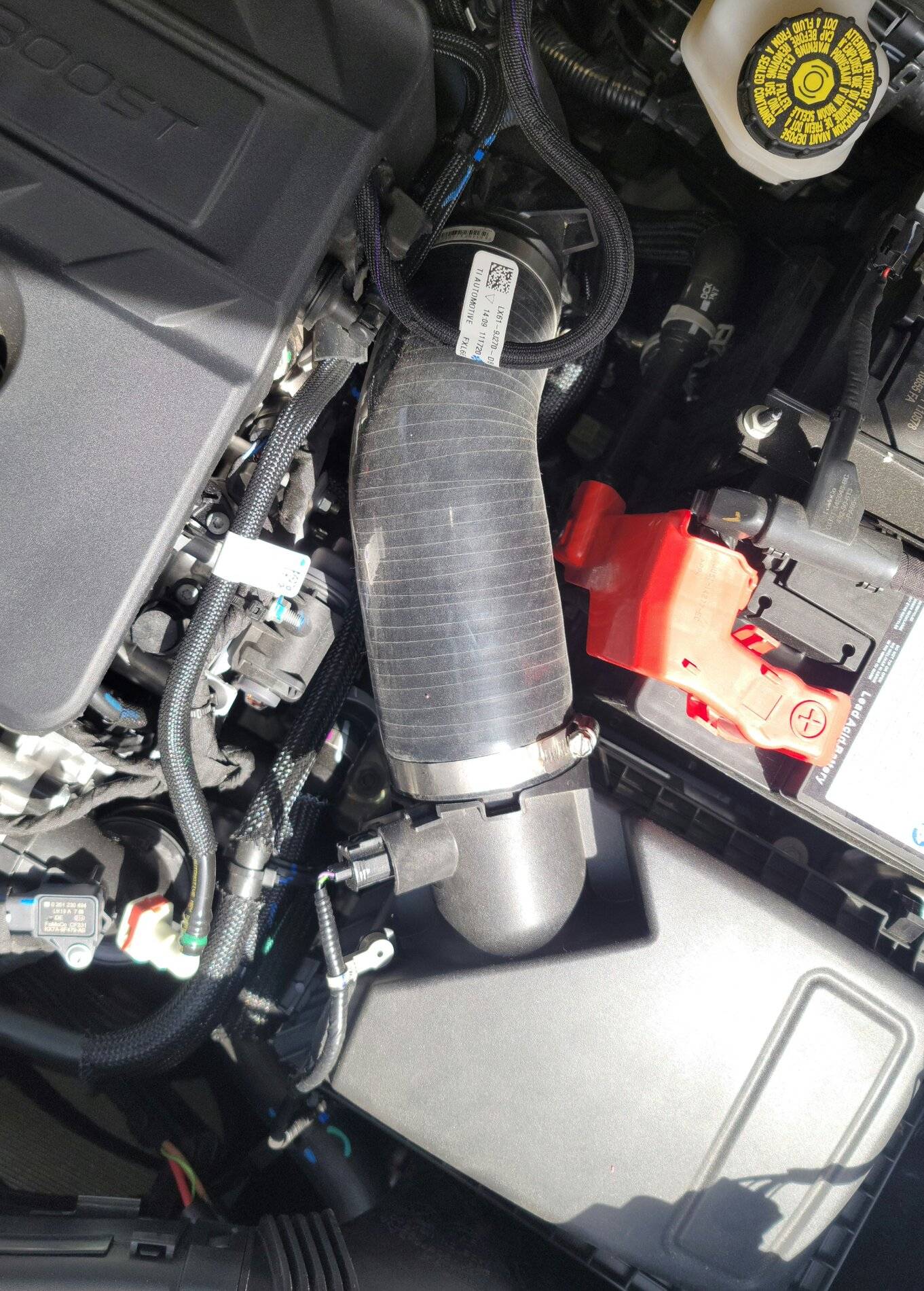

All fair points. Cost, NVH, predictability, and reliability, are what car manufacturers are usually after.
But you missed what I posted originally. Quicker Turbo spool due to less turbulent air flow. I cut enough of the hose, to ensure there is flex to accommodate for engine movement. This is a 1.3l, it's not outputting gobs of torque to be an issue..yet. if it was, I would be addressing that first. Before I did anything else. Supporting mods first, before power. That's usually, my game plan with my vechiles. See'ing how there's pretty much nothing out there for the BS. Custom seems to be the only route for me. I've been modifying cars for years. So this isn't my first rodeo.
I hear ya..btw it's a 1.5L it's all in the details. I do like your concept so shoot us a part # for that tube. Am I right in assuming the OEM hose is really made that way for ease of servicing ?

did you notice any difference in sound? we were practicing going over light ruts and inclines last night, and i could def hear some turbo flutter when giving a little throttle. is it more audible now?
neat mod ??

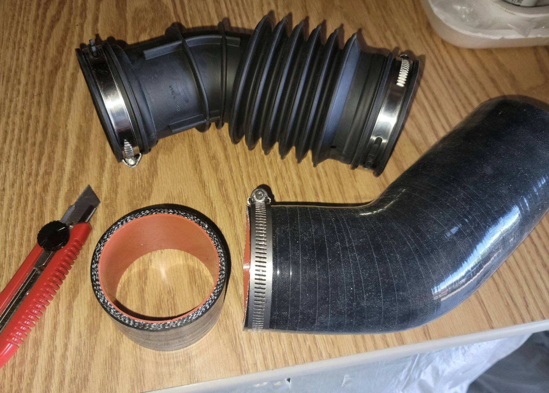

no worries. I was drinking the entire afternoon when I replied. 1.3 and 1.5 was looking the same to me. after loosing the clamp. the hose comes off without any effort. The corrugated portion feel really soft.
but here the part :
https://www.intakehoses.com/silicone-45-degree-reducing-elbow-3-to-2-34-id.html
i cut on the 2.75inch side, wanting the more internal volume from the other side....if that make sense.
neat mod ??
to be honest. in terms of noise. I can barley notice a difference. That being said, my stereo is usually blasting. So I'm practically deaf at this point.
