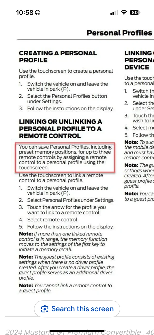

Gbear11 - I was having same problem with my 2025 F150. Finally found a post with the following instructions and was successful linking memory seating to my key fobs.
Ford Bronco Sport Memory seat preset and keyfob setup issue IMG_6455

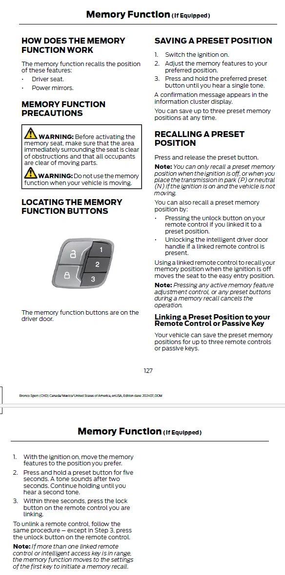

How to associate seat presets to a fob on the BS:
Ford Bronco Sport Memory seat preset and keyfob setup issue 1763575709536-z
