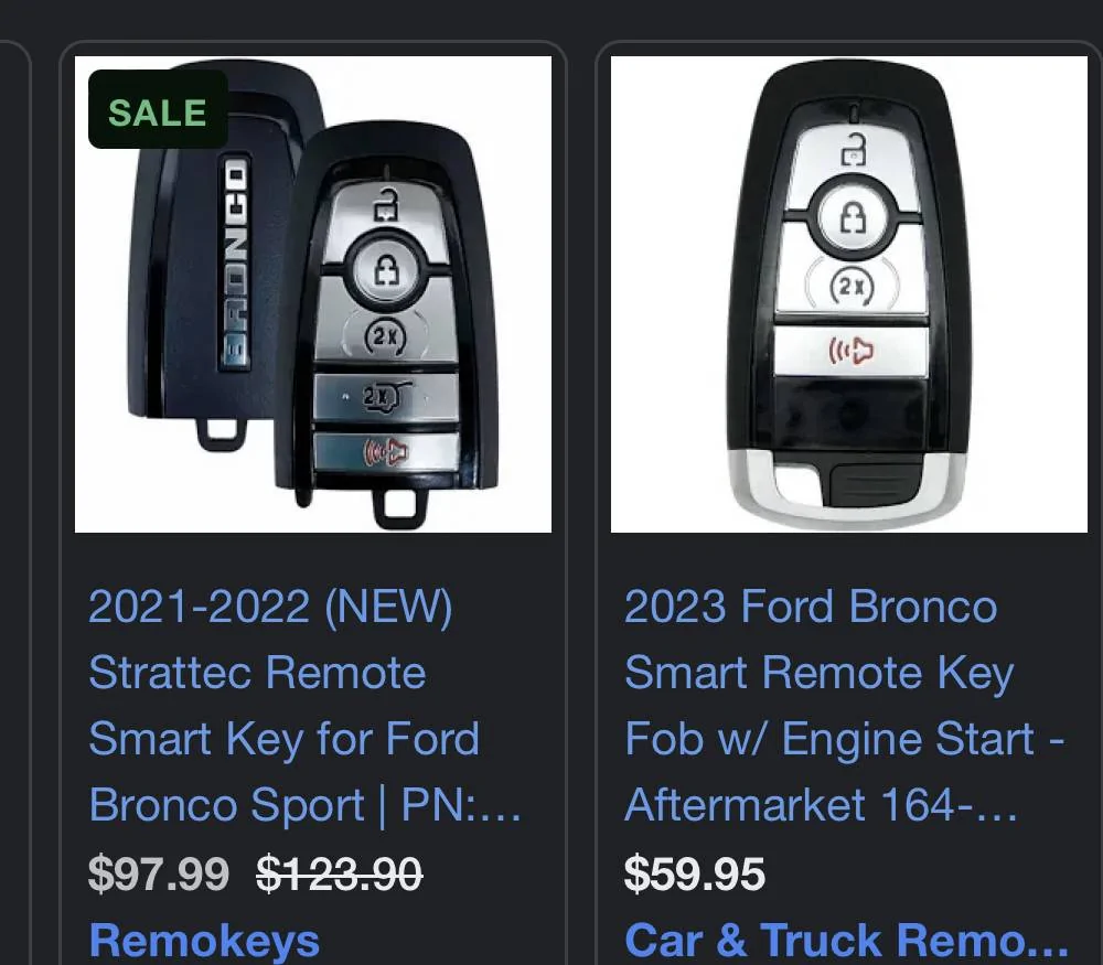

Thanks for your help. I tried your suggestions but so far no luck. I did find an older thread on the subject discussing that it was a known issue. The only solution being to use the older key fob with the liftgate function and push it twice.
Interesting. Ford has a known issue but instead of fixing it they discontinue use of the only Fob capable of solving the problem. Brilliant.
One of the other members suggested asking the dealer if they have one of the older fobs I could borrow or pay $127 on ebay for one.
Anyway thanks to everyone who gave up their time trying to help.

I have heard of the fix where you push the liftgate button on the remote twice, but my remote does not have a liftgate button at all. I have a 23 Outer Banks. Does anyone know if Ford removed the liftgate button from the 23's? I too am frustrated with the liftgate not working properly.

@OrangeJoe42 I think we pretty much all have the same intermittent issue that you experienced which has a solution given by Ford in SSM 50452 pasted in below. Assuming of course you have the correct key fob that has the liftgate button.
SSM 50452 2021-2022 (and probably 2023) Bronco Sport Liftgate Passive Entry Is Inoperative
Some 2021-2022 Bronco Sport vehicles equipped with passive entry system may experience a condition where the liftgate passive entry feature is inoperative. This may occur if the user inadvertently presses the liftgate button on the passive key fob once and then presses the exterior liftgate release switch, causing the liftgate passive entry feature to become inoperative. To correct this condition, press the liftgate button twice on the passive key fob to restore the liftgate passive entry feature functionality.

I have a 2023 Badlands, which does not have a liftgate button on the fob, so it can neither be the source of nor a solution to the problem. In my case, whether the button on the liftgate works on the first press, the 6th press, somewhere in between, or not at all changes every time. Whether my case is unique or just a form of the same problem others are having, I can't say.
I get it now. It is interesting then that sometimes with no known pattern the issue with the liftgate corrects itself.
