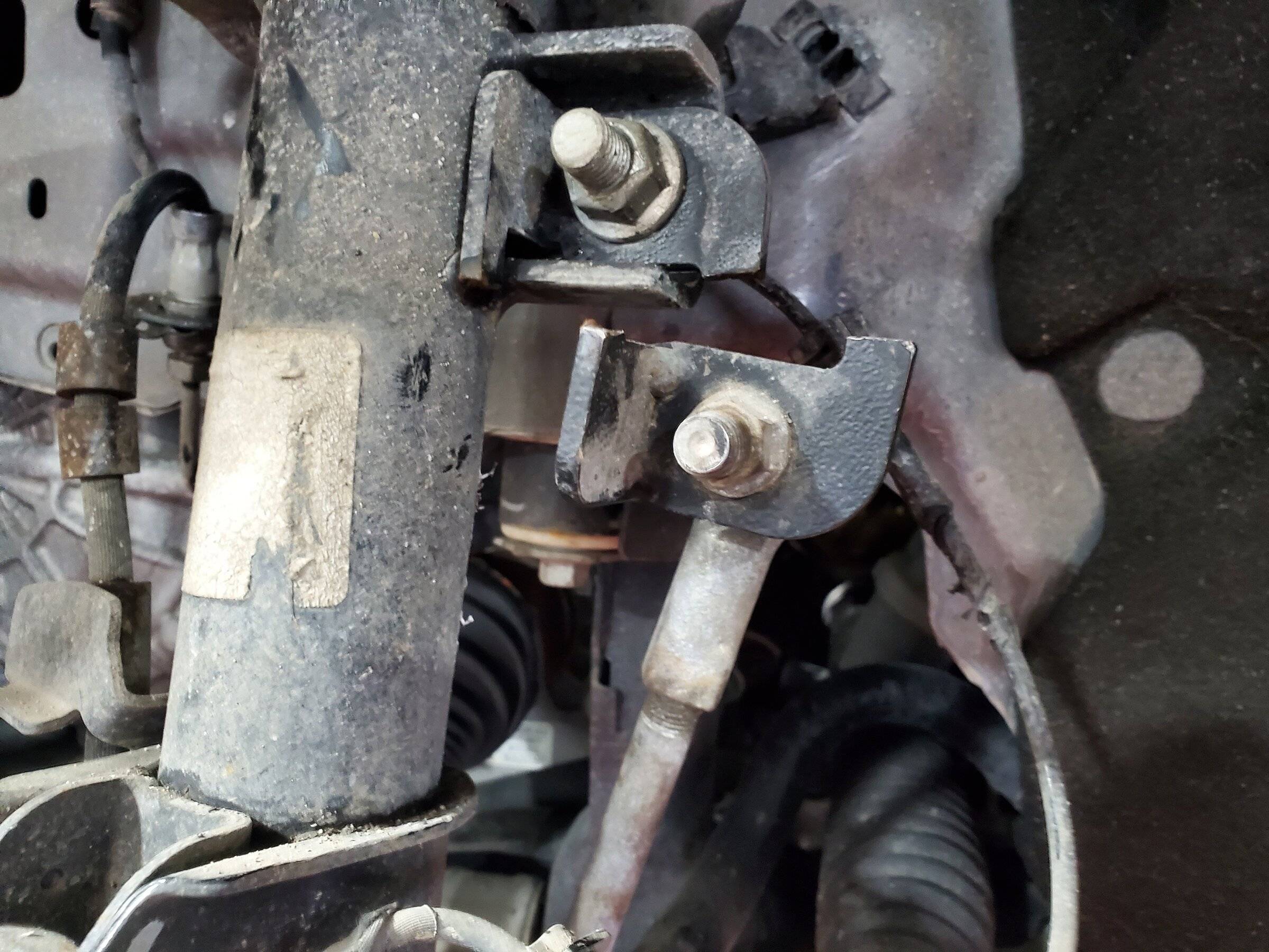

I had same issue with bracket breaking...called RC and complained and they sent me new ones...they had been redesigned and are a beefed up version...as far as the sway bar links sent with the lift level kit I finally found some better ones afer trying to get them to stop knocking for almost a year now...seems to be way better...also the recommended length they suggest seems to be wrong...the sway bar links are preloaded with their instructions...used live adjustable sway bar links and the ride and steering feel much better now...I will post the sway bar links...wh

IIRC just means "if I remember correctly". HRG Off Road is an actual company that makes lift kits. See the link to their Bronco Sport lift kit below. With their kit, they made longer sway bar links to account for the additional 1.5" provided by the spacer that sits on top of the strut. In your case, drop brackets were used so that the factory sway bar links could also be used. But as you can see, that creates another potential point of failure.

The HRG lift kit uses 1.5" front spacers, so the sway bar links from that kit should work with RC lift kits since that kit also uses 1.5" front spacers. If you replace the factory sway bar links with HRG sway bar links, you will need to remove the drop brackets provided with the RC lift because they will no longer be necessary.

That looks like the sway bar link drop bracket. Could be from Rough Country or Ready Lift. From what I've read on this forum, both kits have had quality issues and were not well designed. The good thing is that IIRC, HRG Engineering sells just the sway bar links from their kit so you don't have to buy the entire kit. They made new sway bar links instead of using the existing factory sway bar links with drop brackets like RC and RL.

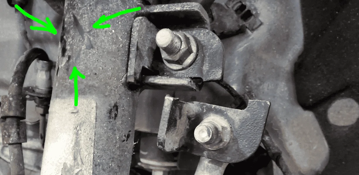

They aren’t the best lifts with the ready and RC. Looks like the sway bar links are being sized wrong and putting stress on the mount when flexing and snapping
