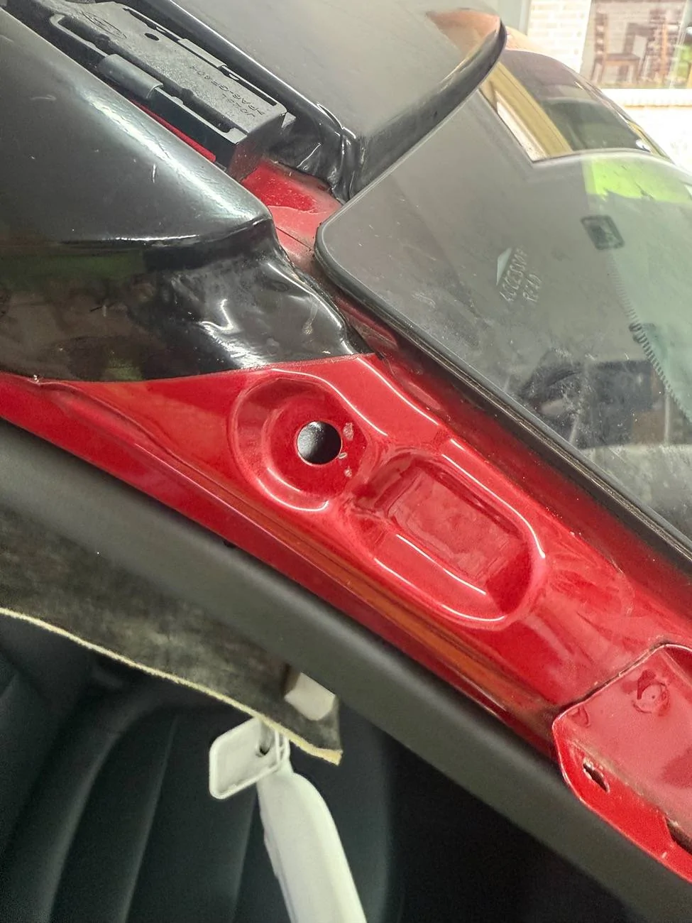

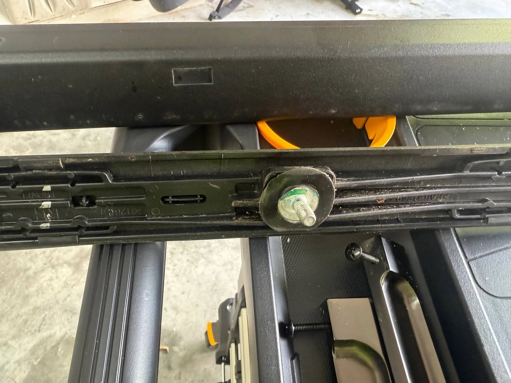

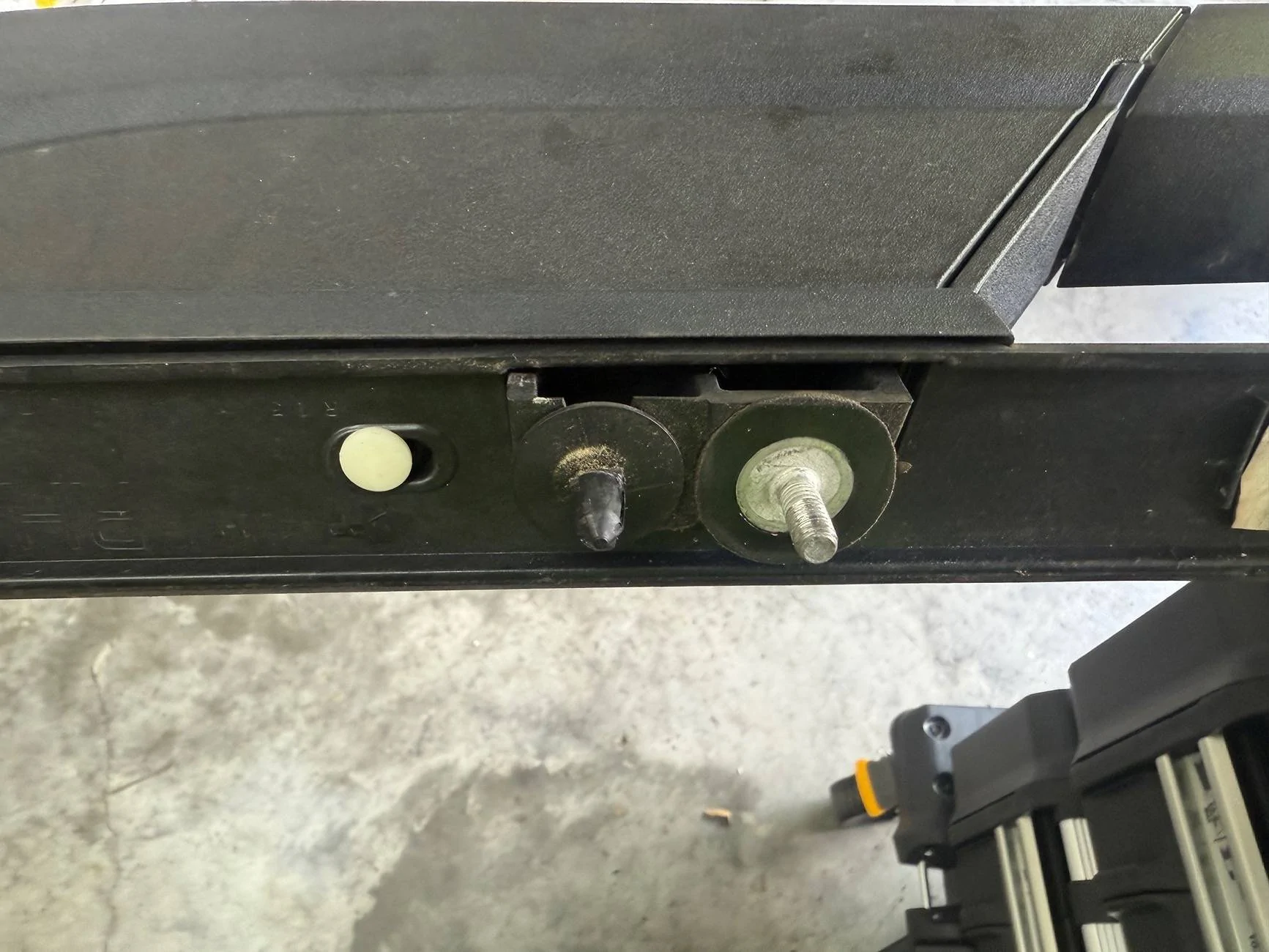

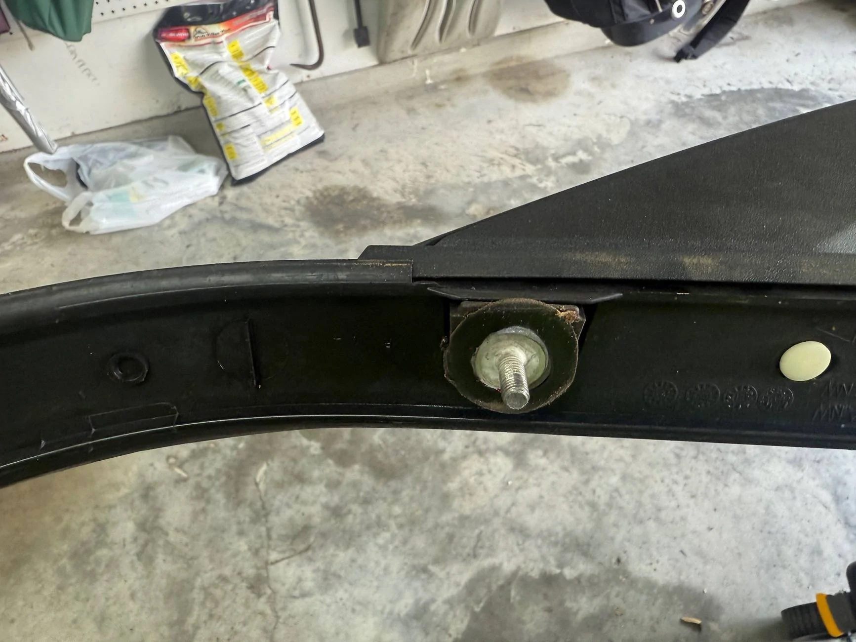

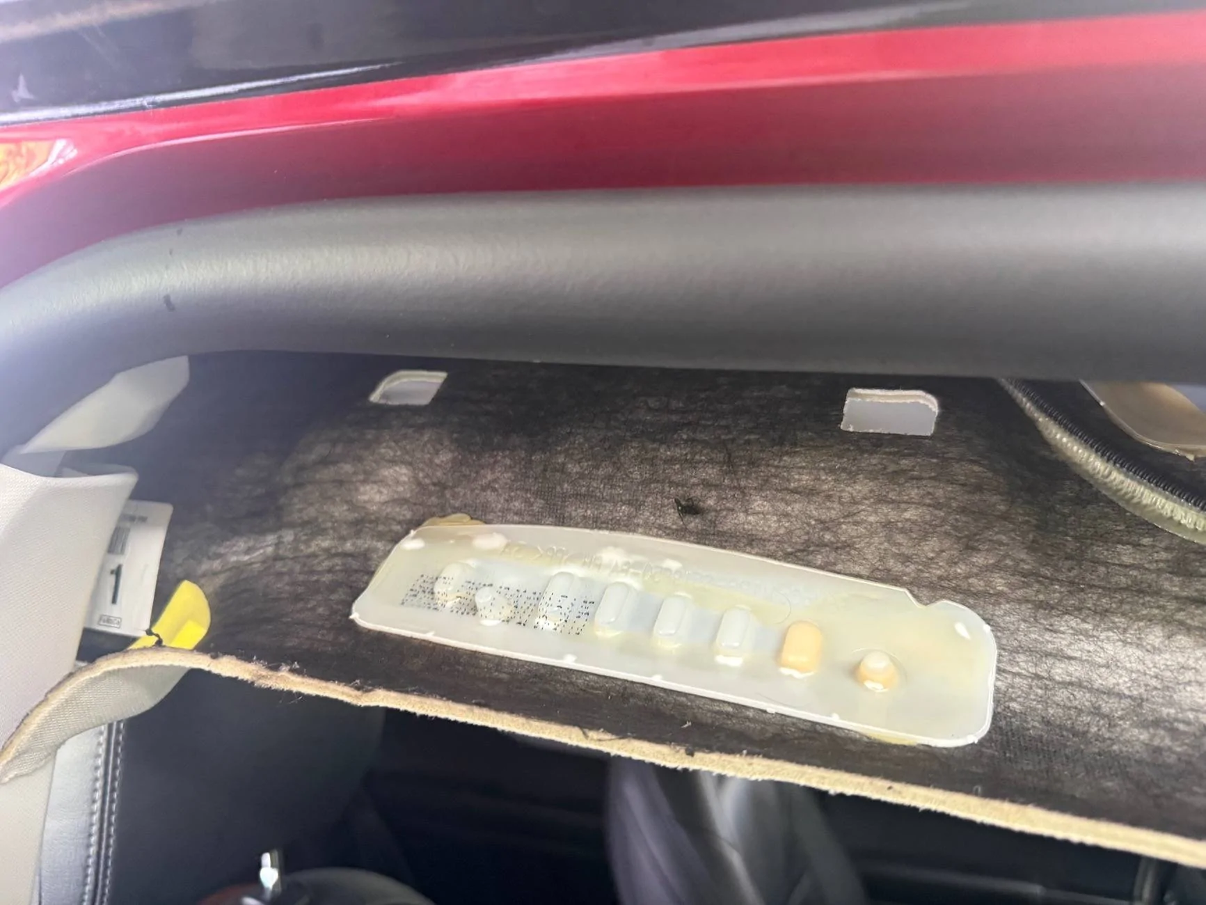

Just repaired it. Poor construction. Pull off side handles, pull visor, pull roof lining on one side just enough so you can get to the screws (7). press / clicking mechanism has to leak over time. Replaced rubber washers with rubber washers I bought at home depot.
