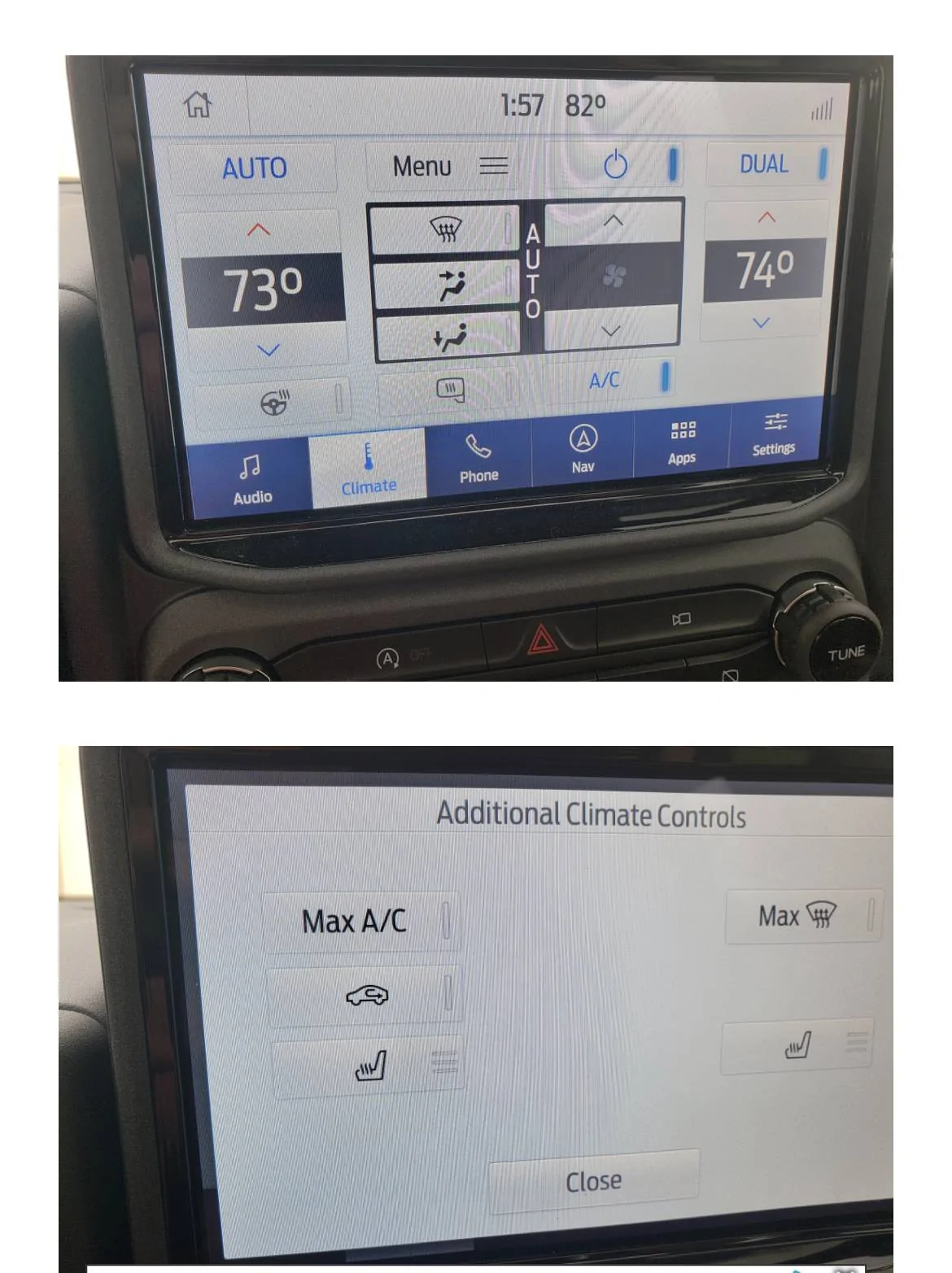

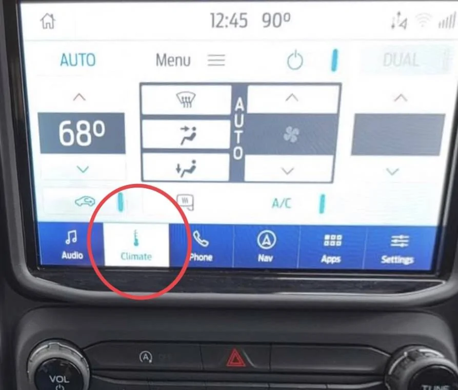

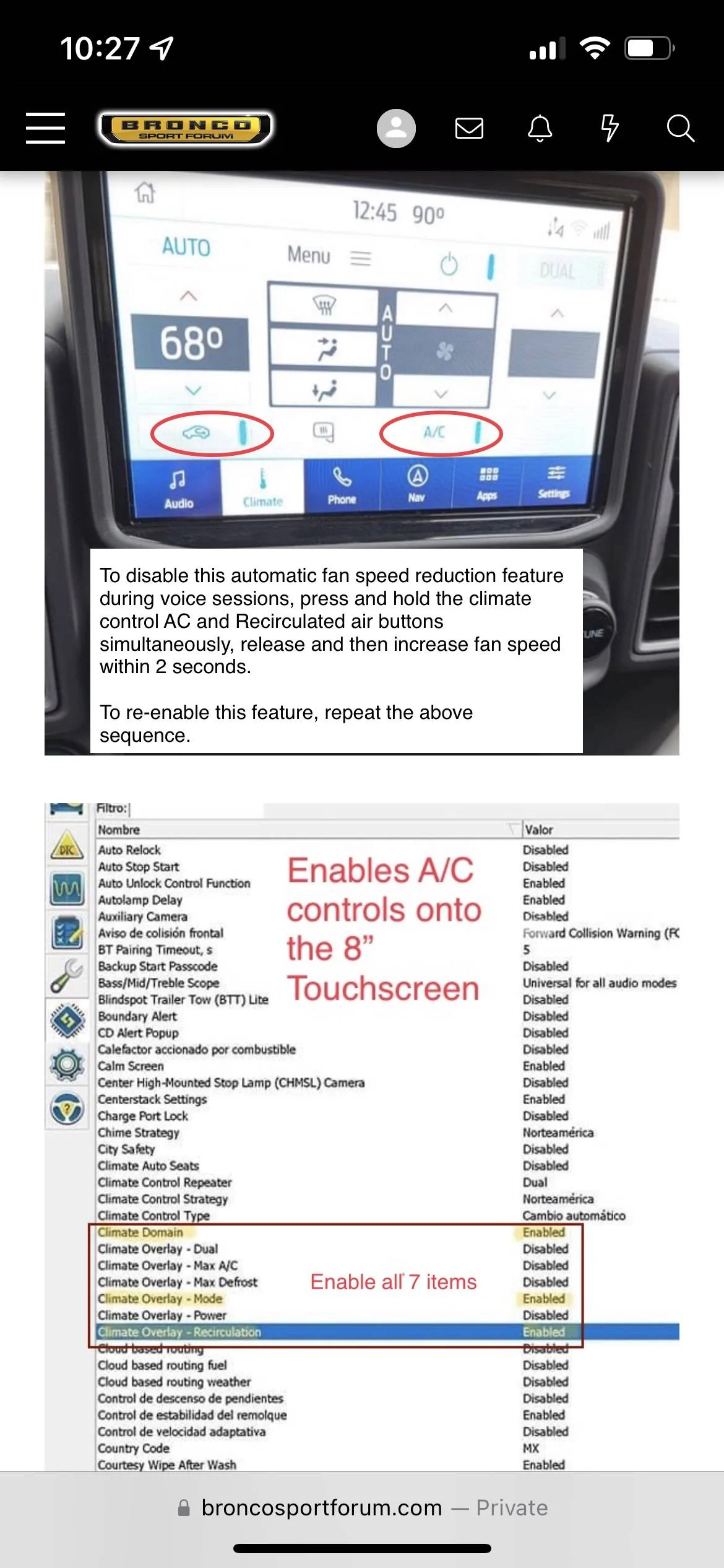

I mean using forscan can add the Climate screen (controls) to the 8” Display. See pics including forscan mods.
(admins .. the info below is off topic from the original thread “Lack of "stop points" on 2022 gear shift dial...” also some of the info below I and others posted in other broncosportforum threads so please delete if necessary or let me know and I will remove my posting below since is not germane to OPs thread.)
